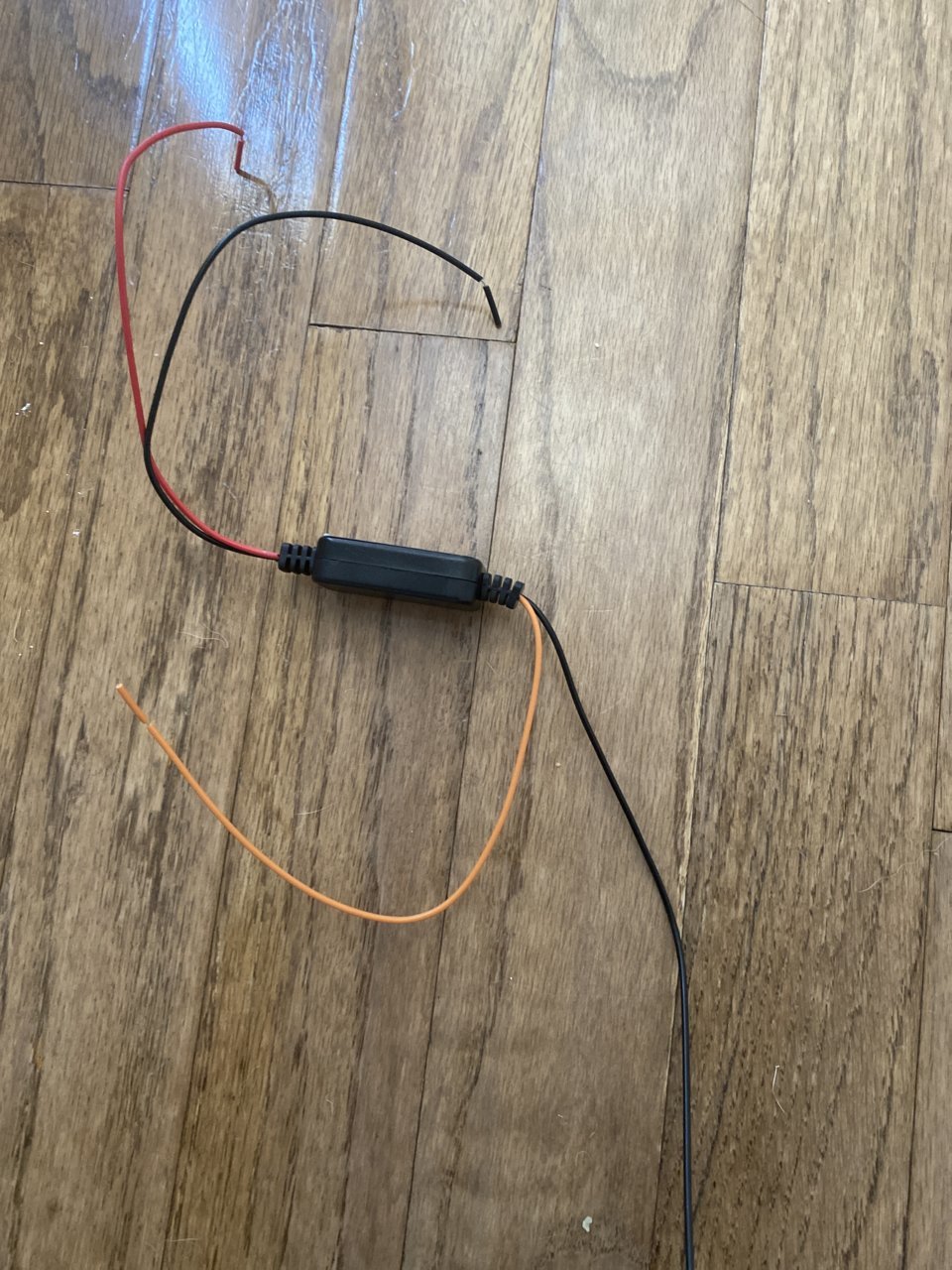

    Just checking and since I didn’t see it or I missed it, the +6 and -6 volt wires are not used right? I only need to deal with the +12 and -12 volt from Garmes box and red cable going to camera harnes splitter box. Also is the little box in pic used for anything? Thanks.

    @Devir7 This install can be made cleaner using the 6.5Ft. cable from Amazon. $9.99

    Edit- found that is the cable I want. Gonna go ahead and order that. $10 bucks to save on frustration of fishing a larger cable end through that seal, I’ll take it!
    Thanks, is this the “dash cam rear view backup” linked in the products discussed the one your talking about? I decided to hold off on doing it today since it would have just been too hot. Maybe I can get to it one morning or evening when it’s cooler.
