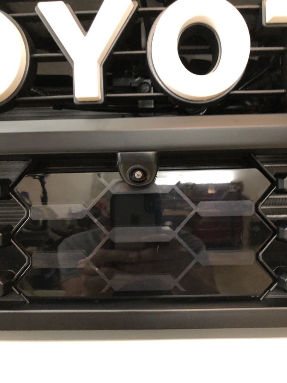

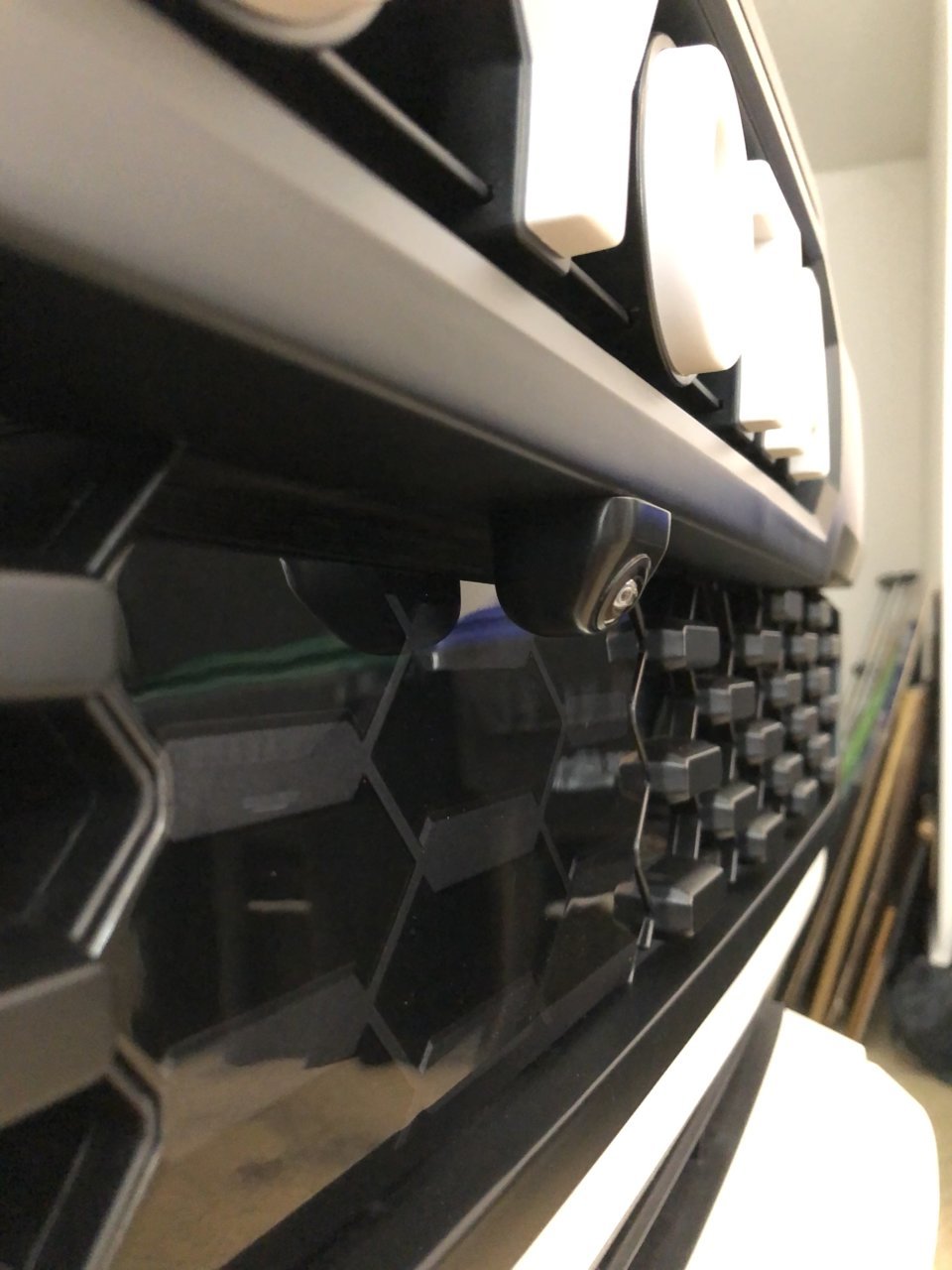

  16. Jul 18, 2020 at 10:33 AM
    #1016
    Derrick2972
    Derrick2972 Well-Known Member
    Sep 25, 2018
    #267348
    129
    2016 Toyota Tacoma SR5 4x4
    This is what mine looks like.
  17. Jul 18, 2020 at 10:58 AM
    #1017
    hyrule_trd
    hyrule_trd It’s a Secret to Everybody
    Jan 26, 2020
    #317260
    10,414
    Eric
    Harford County, MD
    2020 Black TRD OR
    Ironman Stage 1 Foam Cell Pro lift kit, 255/85/16 Cooper ST Maxx, SCS BR6 Wheels, SPC UCA, Heated seats, MESO TRD start button, Meso Total Tail v1, Meso V5 mirror white DRL turns, bed decal, ditch and hidden bumper lights, screen protech, RAV4 radio knobs, steering wheel anytime camera kit, dash cam, ECGS bushing, Timbren Active Off Road bump stops with Wheelers flip kit. 35% Xpel CS Ceramic Tint, KD Max Tune, SumoSprings front bump stops, RRW Sliders ‌ ‌ ▲ ▲‌ ▲
    So after playing with it, pressing mode 2 times the front camera will come on, if I press mode again it will go to rear camera for a second the back to radio. I needed to use the up and down track buttons to freely swap from front and rear cameras. I think mine works the way it should.
    mosccat likes this.
