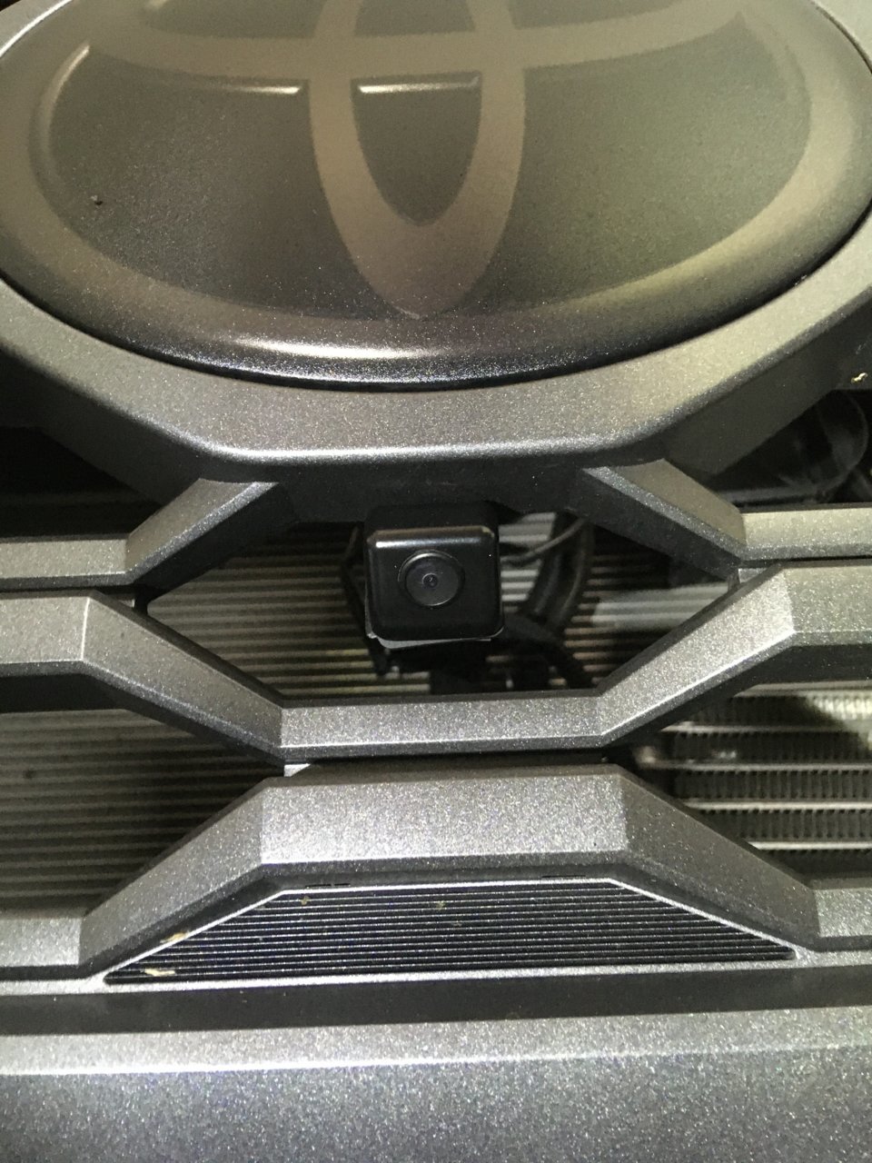

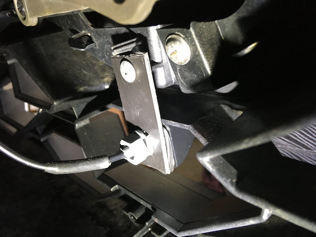

    FYI I made a camera bracket all you need is a 1”x2” wide bit of plastic, drill a hole for the screw and one for the camera, use The supplied shims and done.

    Camera bracket on 2020 OR grill. All you need is a bit of plastic or metal 1”x2” and a drill...

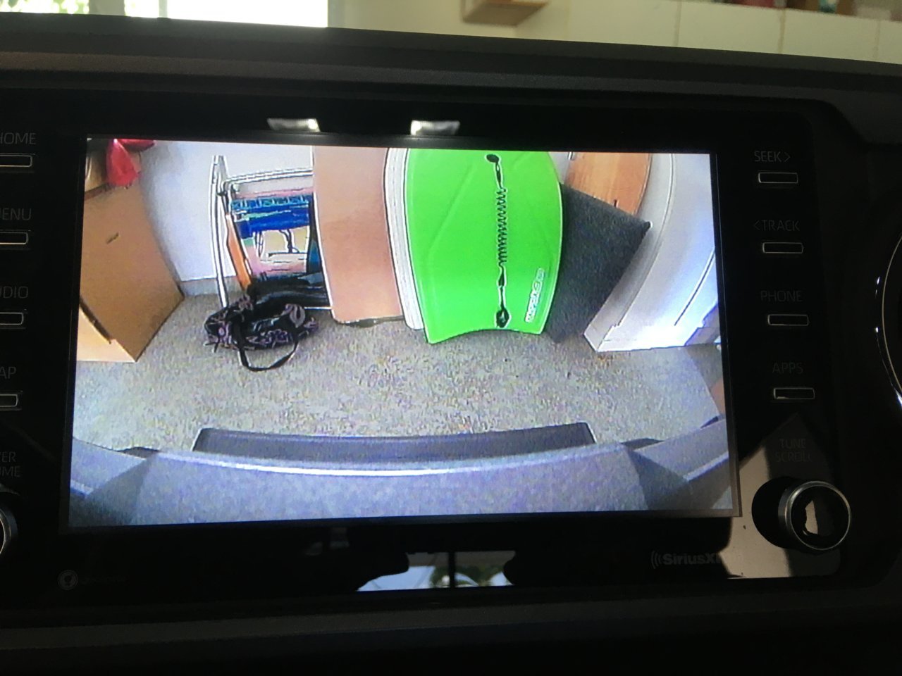

    Is working perfectly. Just need to change the position of one dip switch (I forget which). Simples...
