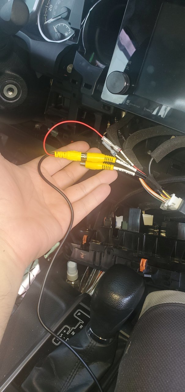

    So pretty much I'm using the long RCA wire that came with the camera. I don't have much time to wait for the 6 pin connector if I were to order it. But before I fish the wire through the firewall I wanted to test the camera first to make sure its working. I double tapped the "mode button" and all I get is a black screen. First I thought there was no power going to the camera so I pulled the red wire and stripped it a little more and re crimped it. And there's still a black screen.

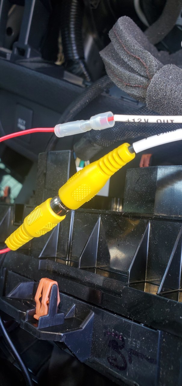

    Be sure that all of the connectors are firmly seated. You can ignore that "+12V Out" wire that's shown in your picture. Connect the red wire from the camera's RCA connector (barely visible in your pic) to the wire marked "Trigger" (or something like that) on the Germes unit. Then the 12vdc will be supplied to the front camera only when necessary. The ground to the front camera is picked up through the RCA connector shield wire.

    Yeah i just got done removing the wires from the HU
    and reconnecting them, making sure all of them click into place. I started the truck up and still a black screen will show up. I've noticed the Germeslab unit will have a blinking blue light when I double tap the mode button. But other than that there's still no picture.

    I don't have a trigger wire. I connected the red wire from the RCA cable to the red "+12V out" cable on the harness.
    I definitely can switch between the front and back cameras on the steering wheel. I have yet to try changing the shifter, I just haven't done so yet. Because I have a bunch of wires dangling underneath the steering column since I had to remove the panels.

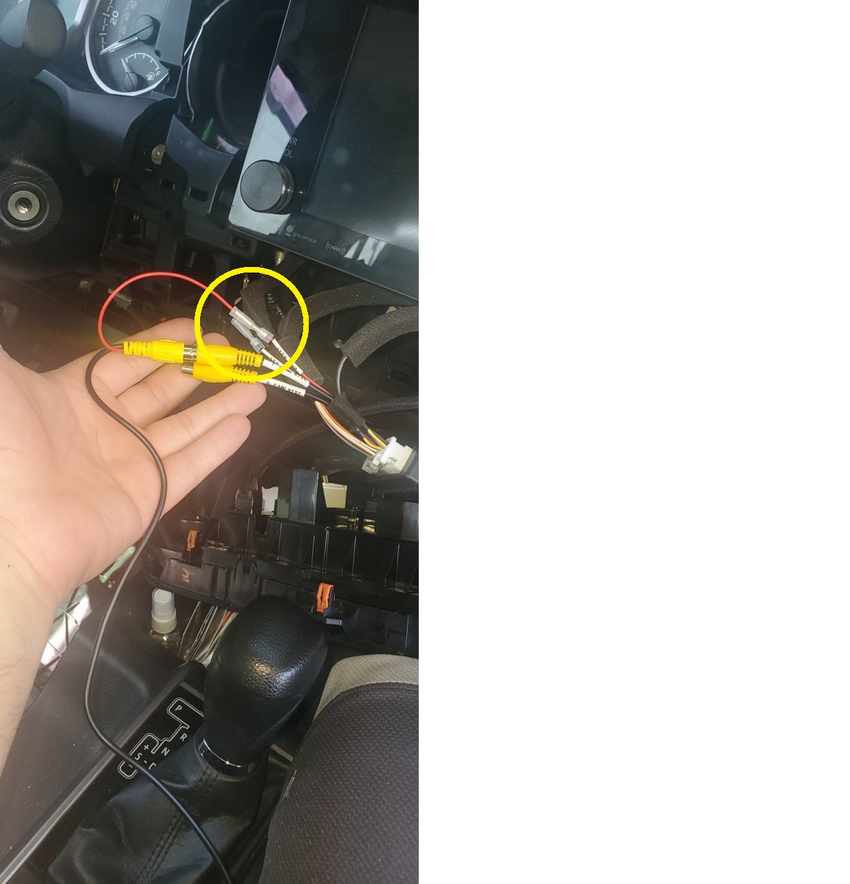

    Are you not connecting power via the green circled cable?

    You need to connect your ground. This is why I did the 6 pin exension harness b/c the long rca only provides power and I didn't want to ground to the chasis inside the engine bay.
    You've fed power through the rca but you haven't supplied ground.
    But we really need to see what the red connector is hooked up to, that's how you inject power into the camera itself via the pigtail.
    IMHO, OP really botched an opportunity to make this truly plug and play. It's not p&p. You have to crimp on the bullets to the red cable and there isn't enough length to get from germes harness through red cable to pigtail to camera to grille if you go that way. Or, if you instead use the power lead embedded with the rca cable you need a ring terminal for ground when you connect to the red power connector _and_ all of the length of that cable is entirely wasted b/c the rca has to plug in to the pigtail.
    One 6 pin extension and a 3' rca substitution solves 100% of this silliness and would have cost OP very little to provide via repackaging since he had already sourced a camera.

    The Natika WD-011 camera will pick up the ground through the video cable shielding. Myself and many others have it connected that way.
