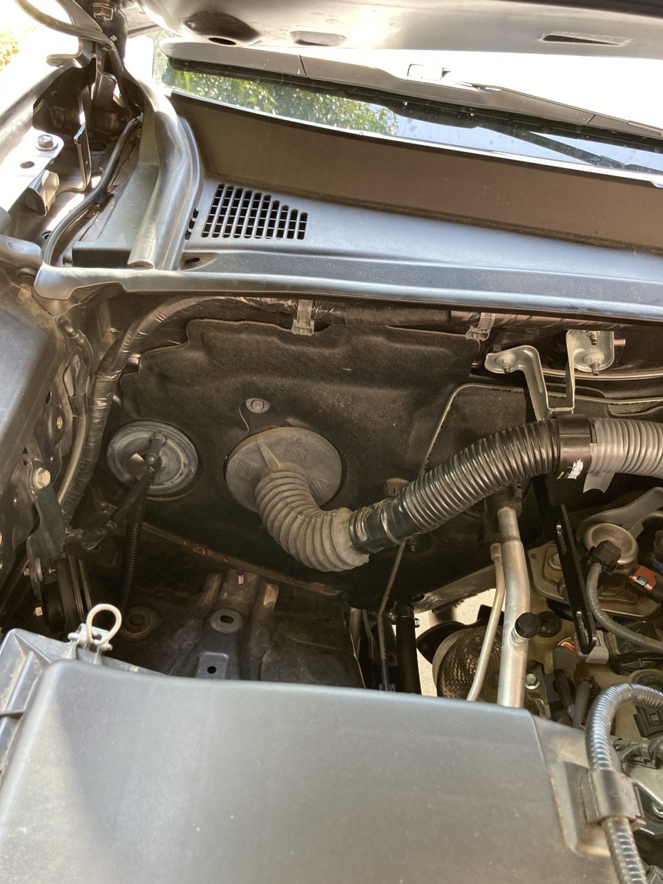

    Ok thanks to everyone who helped pitched in. I got the camera to work. Now with the hard part of fishing the wire through the firewall. I noticed most people used the large grommet beneath the brake reservoir. But the last time i fished a wire through that thing it took me nearly 3 hours to do (it was a thick cable for my light bar).
    Is there any other place I can go through the firewall on the 2016 models? My brother has a 2019 and some access points that he has i don't have on my truck. Pictures would be greatly appreciated, so I definitely know we're to route my wire.

    I went through that grommet under brake booster as well, poked a small hole using a phillips head screw driver (off to the side, not near the actual wire loom) them fished an old fishing pole end through it heading into cab. I taped it up and pulled what I needed through the hole via the pole and tadah! Removed the foot rest protectors and fished the cable under the carpet floor up to the side of the center console, the bulk of the wire is actually sitting in front of the center console as there is a huge cavity of nothingness there you can stuff it in and the carpet hides it.
    Doing it this way you can also see a straight shot from the radio down into the foot well so even a wooden dowel will help fish it up. Easy peasy honestly, hardest part was the OCD of tucking and zip-tying wires in engine bay to have it look nice and OEM. Leave enough extra wire near grill and put the weather tight disconnect near it so if you ever need to remove grill you just unplug the one connection and pull grill off without cutting zip ties.

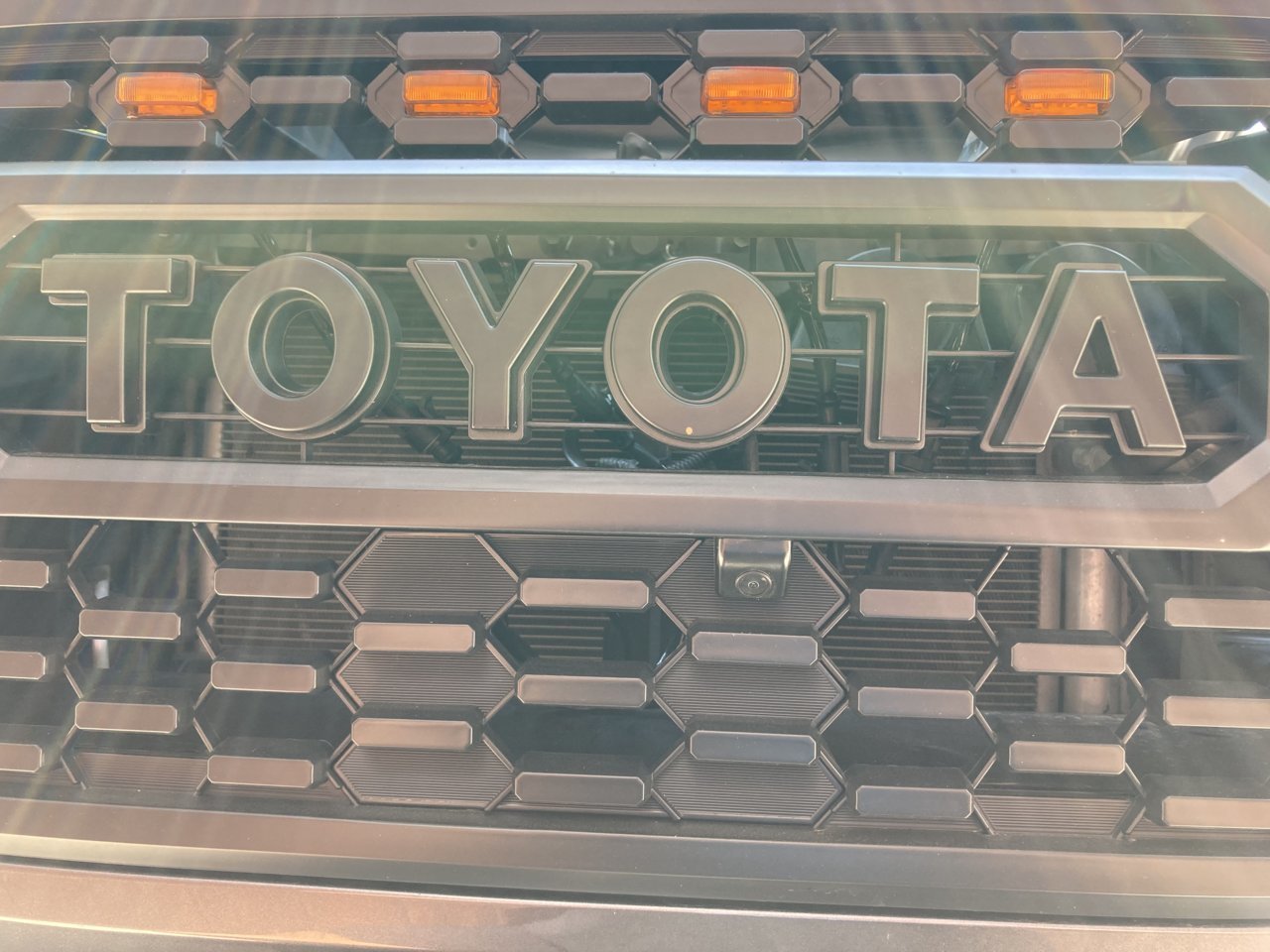

    I completely understand, I hated to pop a hole but I kept it as tiny as possible with the hopes that after pushing the connector through it would shrink back to a small pin hole, which it did for the most part. I'm against drilling/cutting as much as I can get around ofcourse.

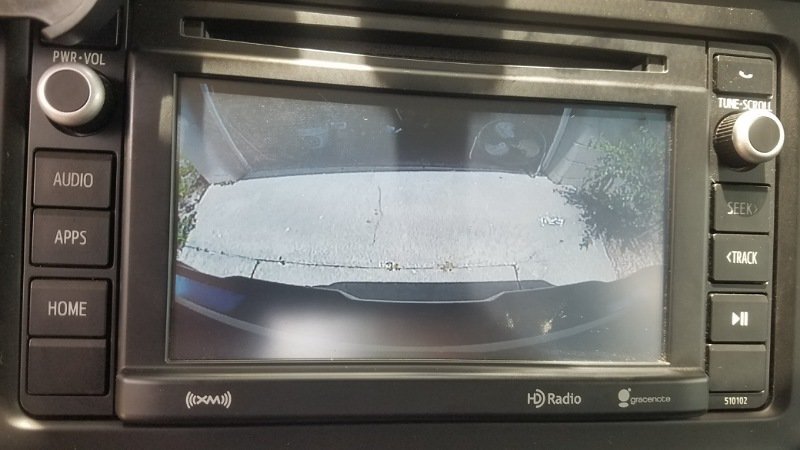

    Also, if you still needed to know how the view looks from a downward facing camera (from under the TOYOTA letters kinda height) it looks like so:
    I've shimmed it out a bit since then, but you get the gist more or less.

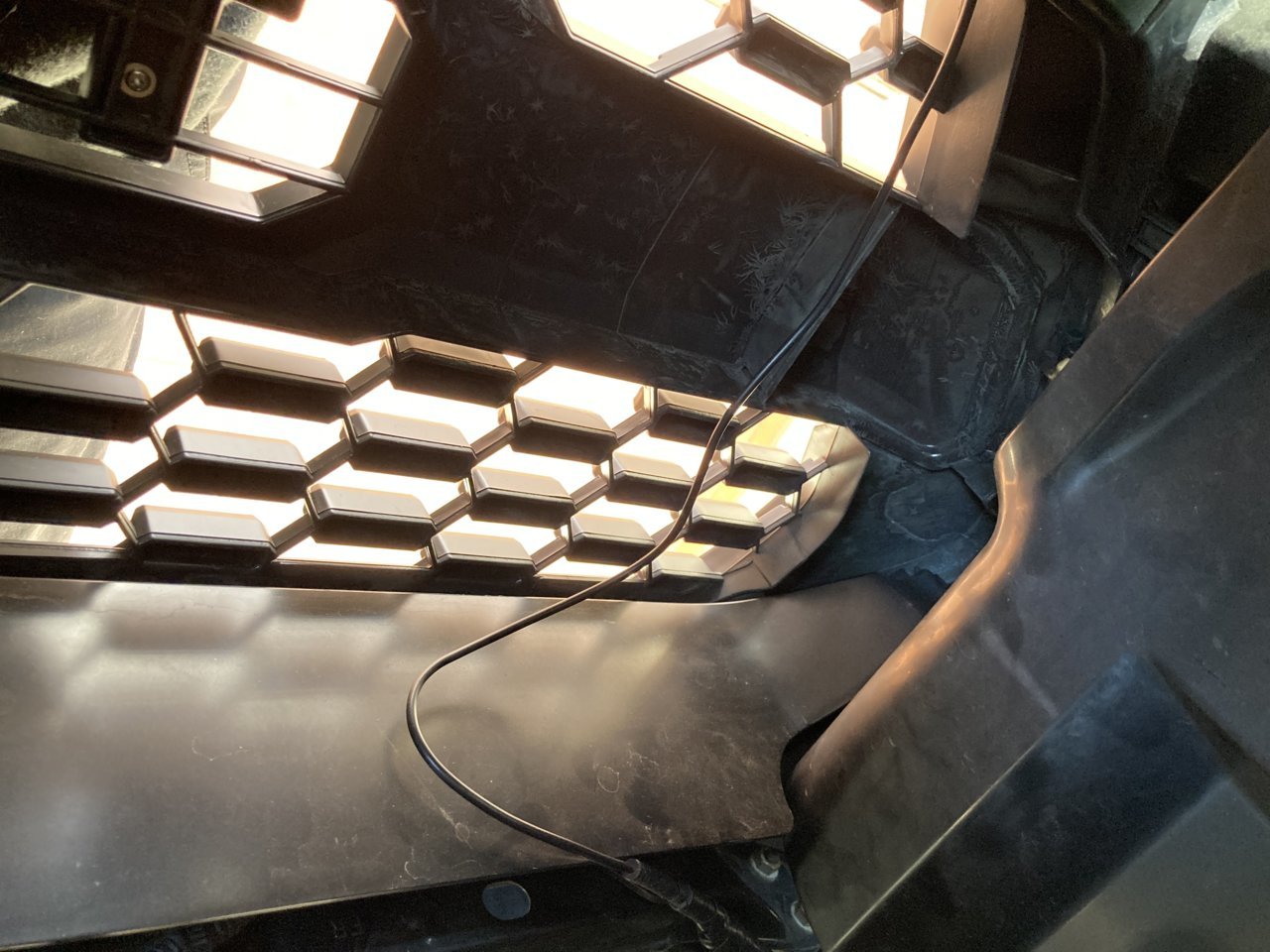

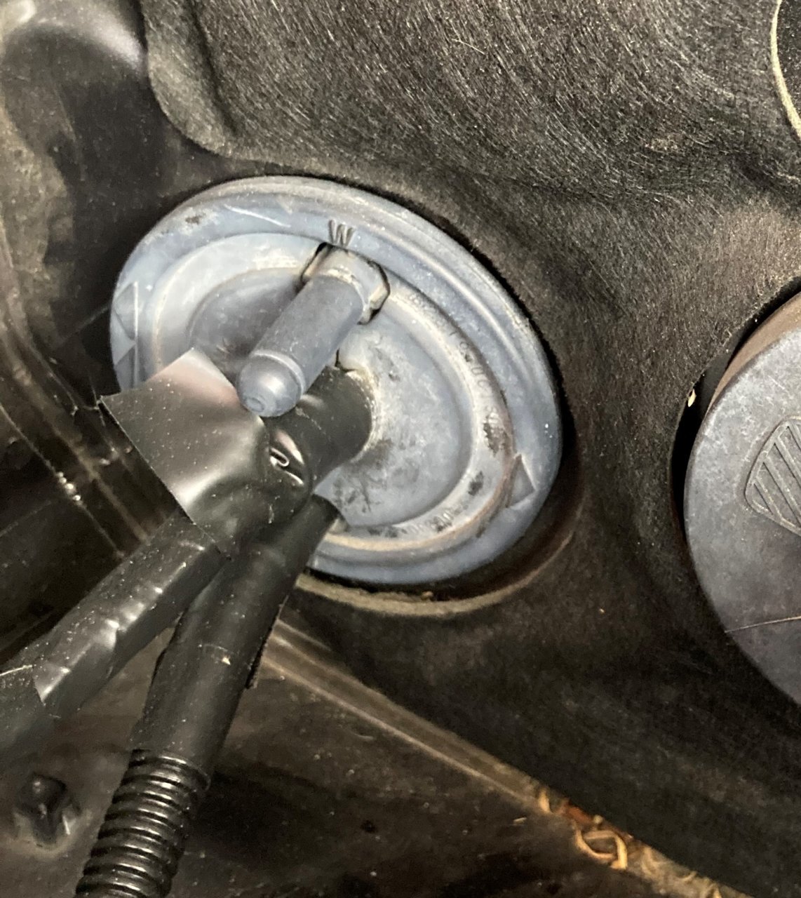

    OK, you've inspired me to go take a photo. I went passenger side as explained in my install notes. I think there's just so much room on the passenger side that it's a no brainer to leave driver's side for stuff which needs battery. On my 2016 there were 3 unused grommets and over a cubic foot of space to work with on the passenger side vs no space on drivers side. Removing the bumper above the glove box is pretty easy and then you have a straight path from behind the radio to passenger kick panel.
    photos below. Camera is in bottom flex loom (this is passenger side). I need to redo the tape b/c the time I only had crappy regular electrical tape. I've since purchased heat resistant tape which is appropriate for the engine bay but haven't replaced that section yet.

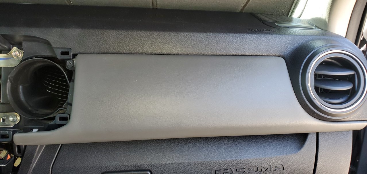

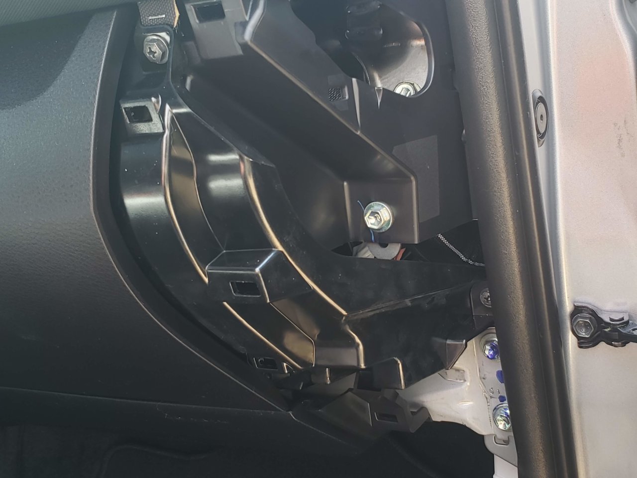

    There are two screws, please be careful. One is bottom right, one top left. I'll get you a photo.
    Use this post for some great photos. You shouldn't need to remove the airbag or even remove the glovebox, just the trim so you can get to the screw and then probably all the upper glovebox screws so it's loose enough you can get the bumper out over it. When I did mine I had airbag removed b/c I needed glovebox out to get to the 4x4 ecu for 2low mod.
    Specifically, this photo.
