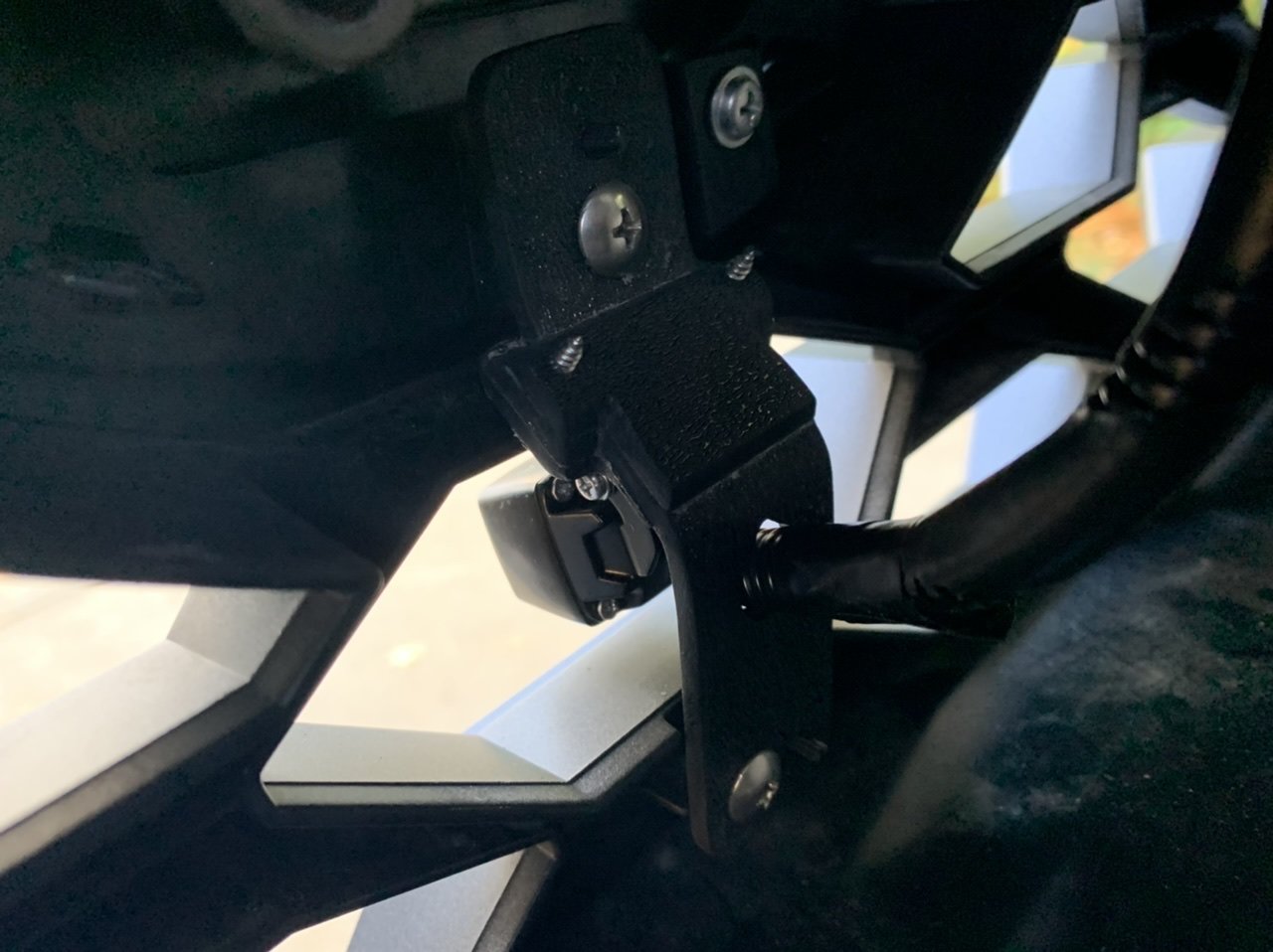

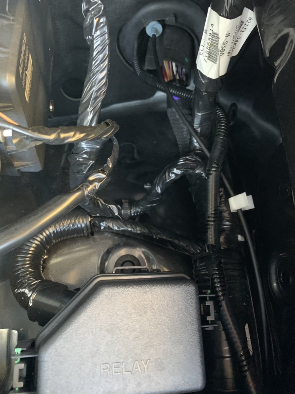

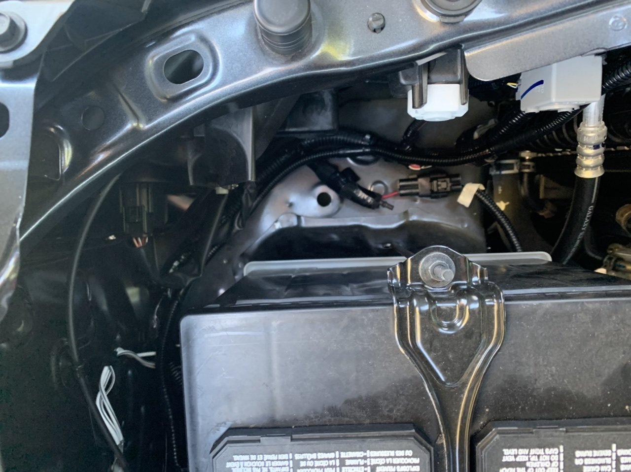

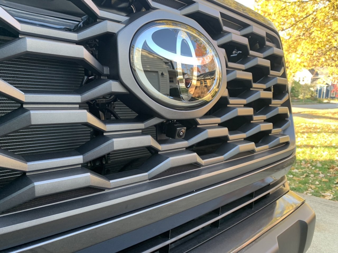

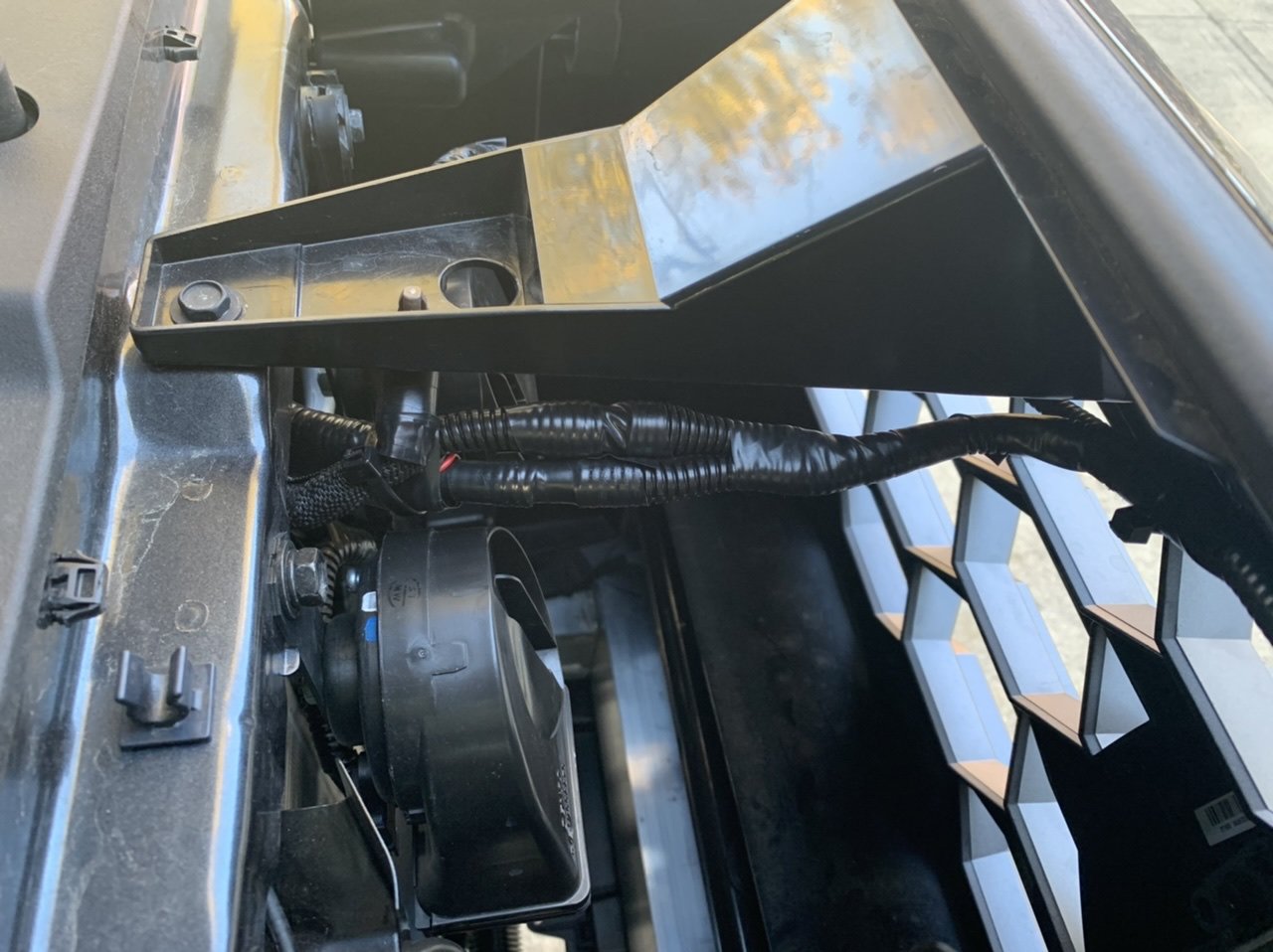

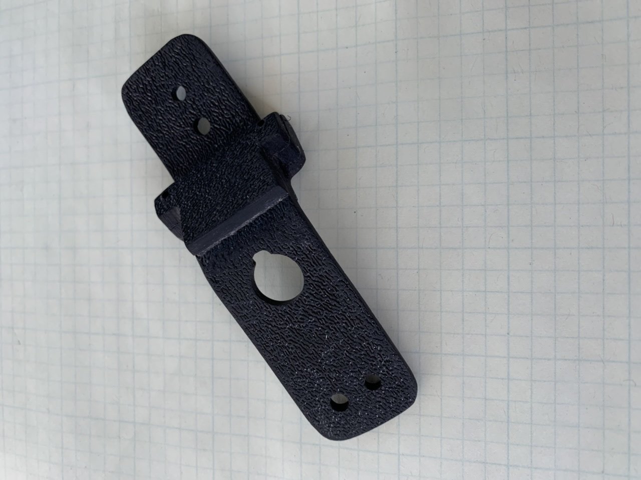

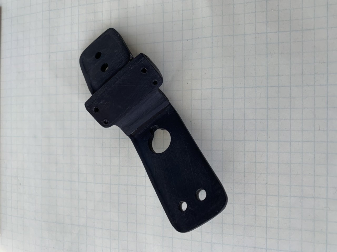

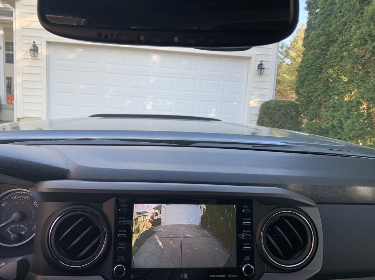

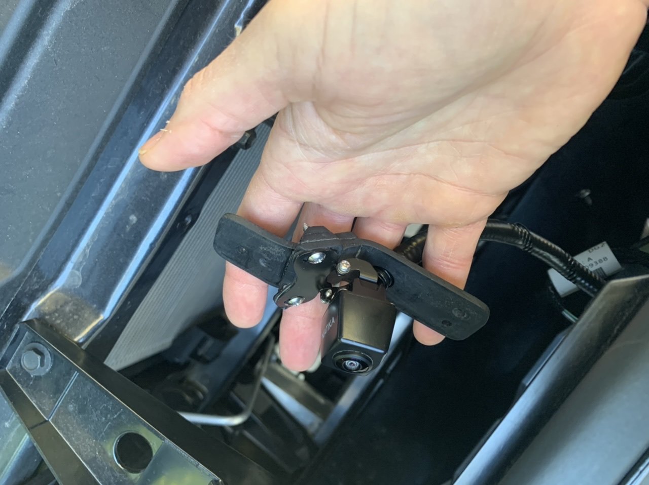

    Read through a great deal of content that you all have shared and want to say thanks.
    I went ahead and made my own mount for the TRD OR Grill and bought the Natika WD-007 camera instead of the WD-011 camera so that it looks more like the OEM. Everything worked out really well. I used the Germes Lab: RFCC Car Camera Control System for Toyota Touch 2 CY17-19 / Entune 3.0 / Link for my 2020 OR Tacoma and everything was plug and play. Installed it through the driver side firewall like others which was the worst part like all have said.
    At the end of the day absolutely worth it. For a little more than $200 total and maybe 1-2 hours of work plus some time getting the camera centered correctly I now can safely see over my hood. Thanks again everyone for being very helpful with your posts. Here are some photos to share.

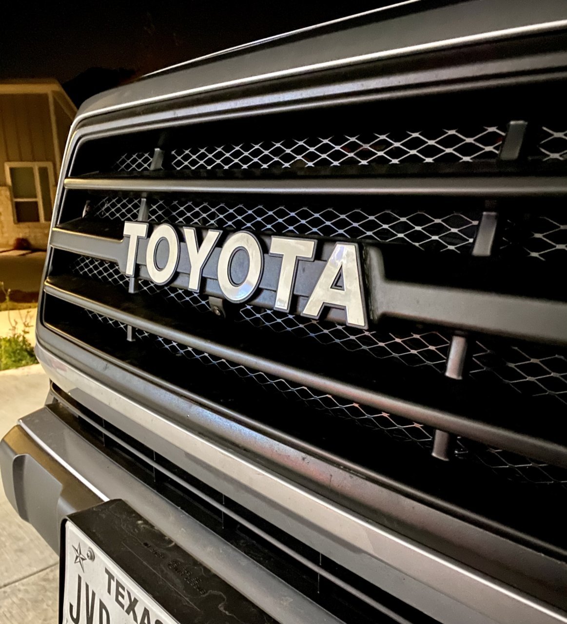

    where did you find that mount for the TRD OR grill? Did you fab it up or were you able to buy it somewhere?
