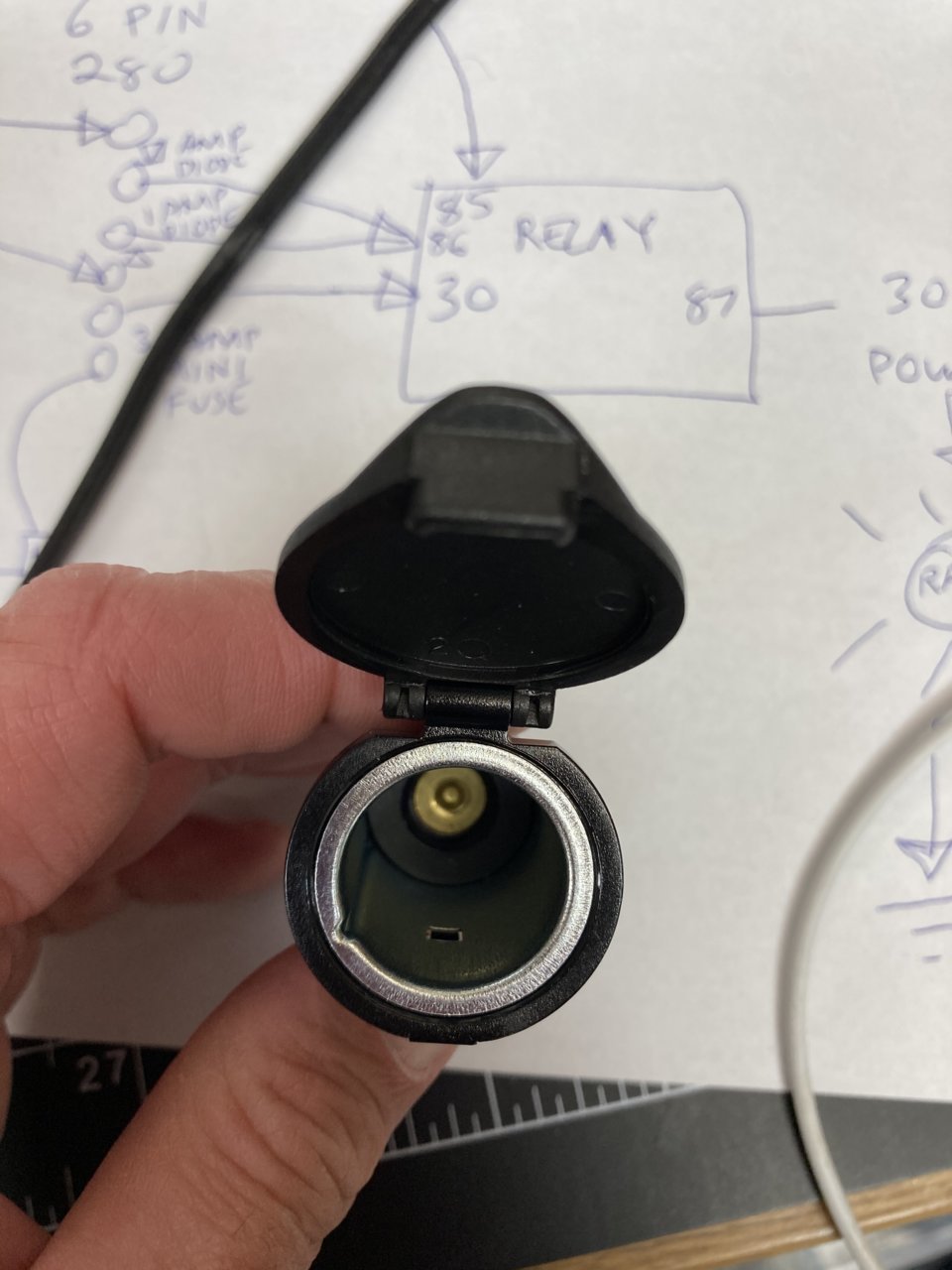

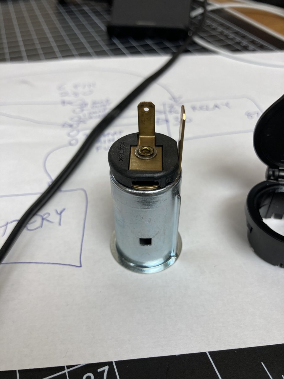

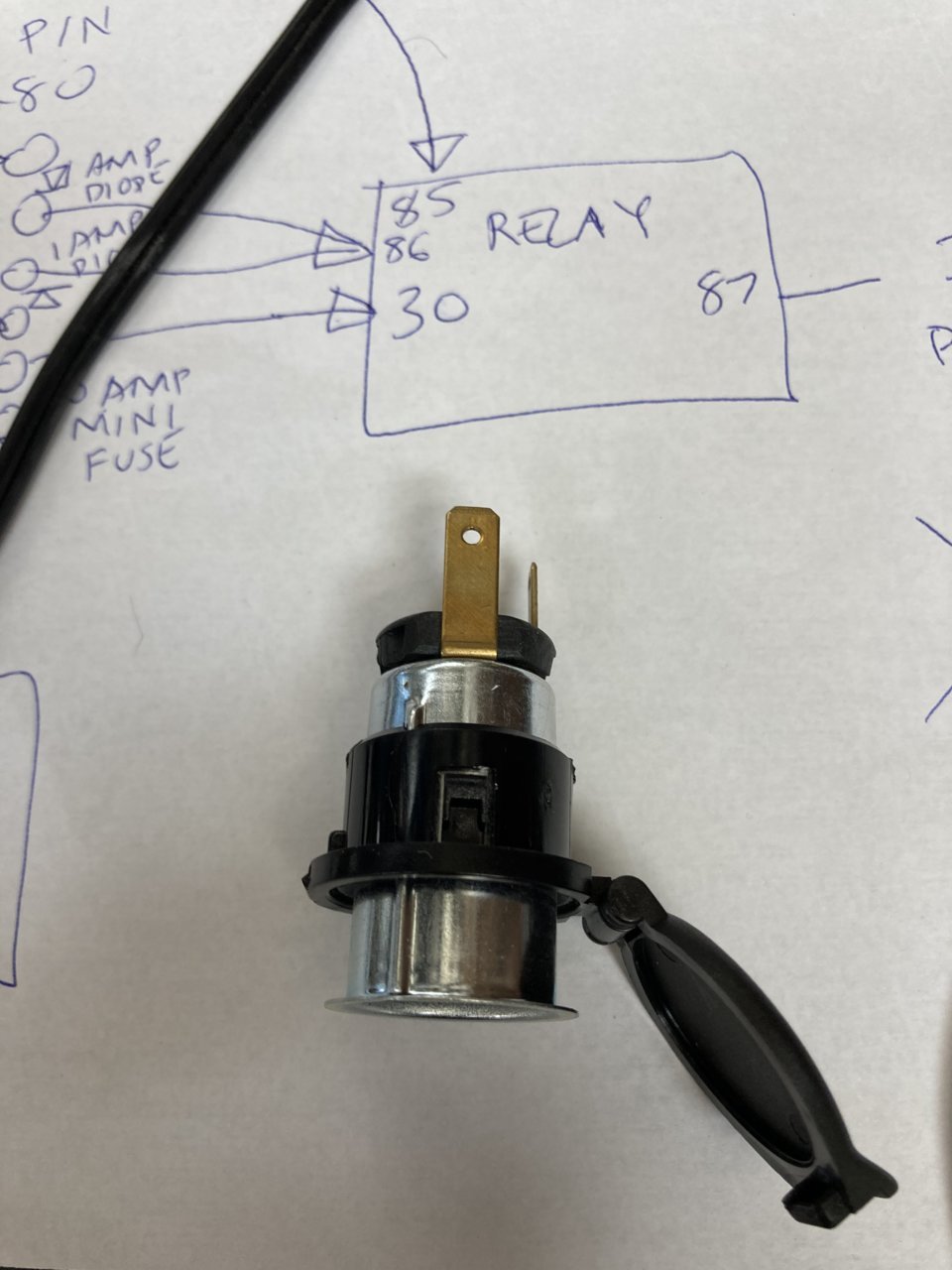

    You can remove the 12V socket without touching any trim, it'll pop out from the front, then disconnect, add some leads to steal power, reconnect and press back into place. Not a ton of slack in the harness though so you'll be futzing very close to your dash.
    Or remove radio bezel, loosen the driver display bezel, and loosen the under-steering trim plate enough so you can remove the climate controls. Unplug and set them aside, now you can get to the 12v socket from above if you want to unplug, tap, and re-plug.
    Consider using a zip tie for strain relief.

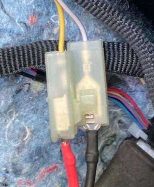

    They feel like 22 gauge to me, solid color is +, white w black stripe is ground.
    This is the connector for my center console (2016 so it has a socket instead of direct USB). I think the dash one uses purple for the + but it's been a while since I looked (mine is floating disconnected back there).
    Lots of room to shove a spade in from the back which is how you'd probably want to do it to retain the socket. Or tap from the front and maybe remove the connector and just heat shrink to secure and insulate the connections.

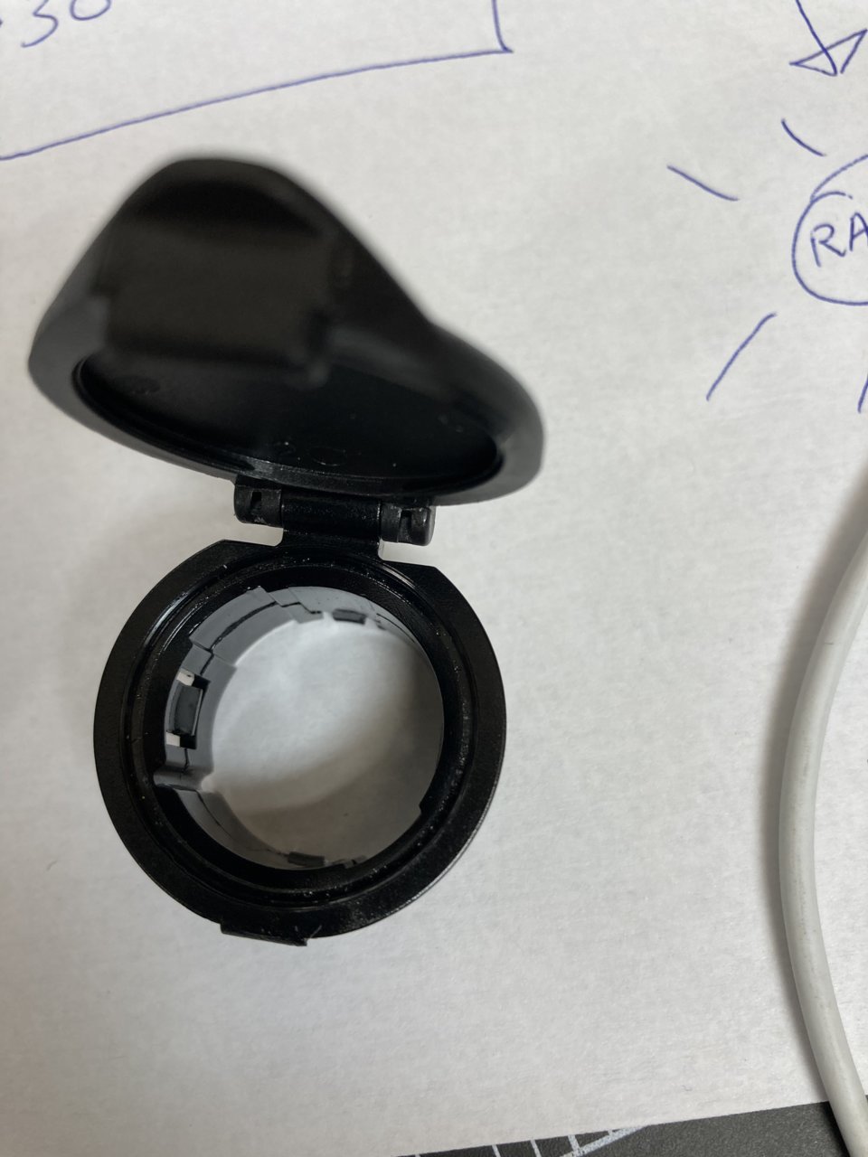

    How do you pop it out from the front? I tried to and I even used more force than I thought was safe and the thing didn’t budge.

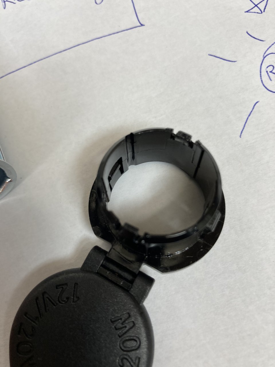

    Simultaneous outward force on top and bottom tabs and gentle pull and she slides out. Once the inner metal sleeve is out it should be possible to gently wiggle / pry the plastic cap. By no means a trivial task with limited visibility.
    Photos may help? A solid set of pick tools are likely very helpful, small blade screwdrivers may suffice but you'd need one for each tab and another to pry outward.
