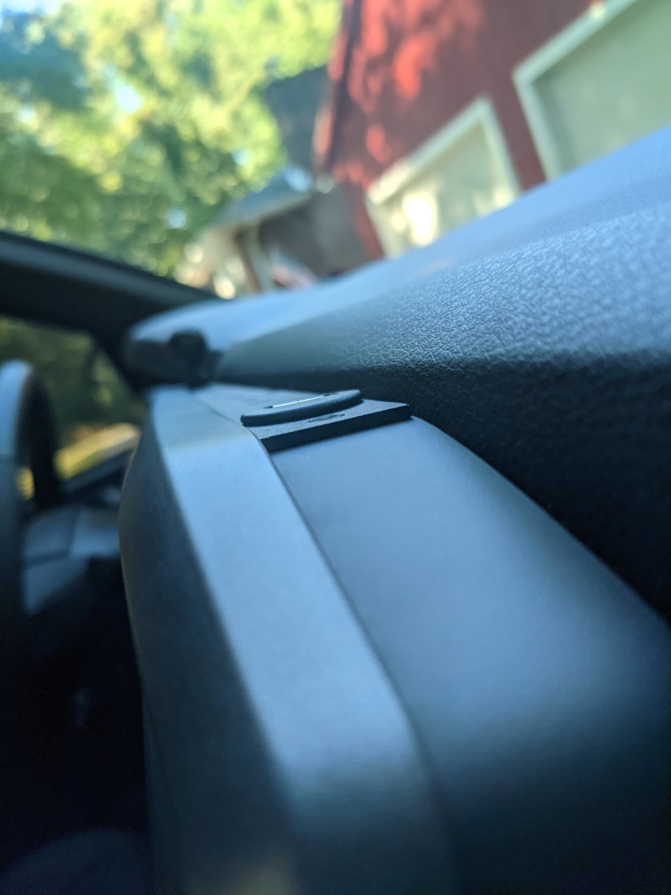

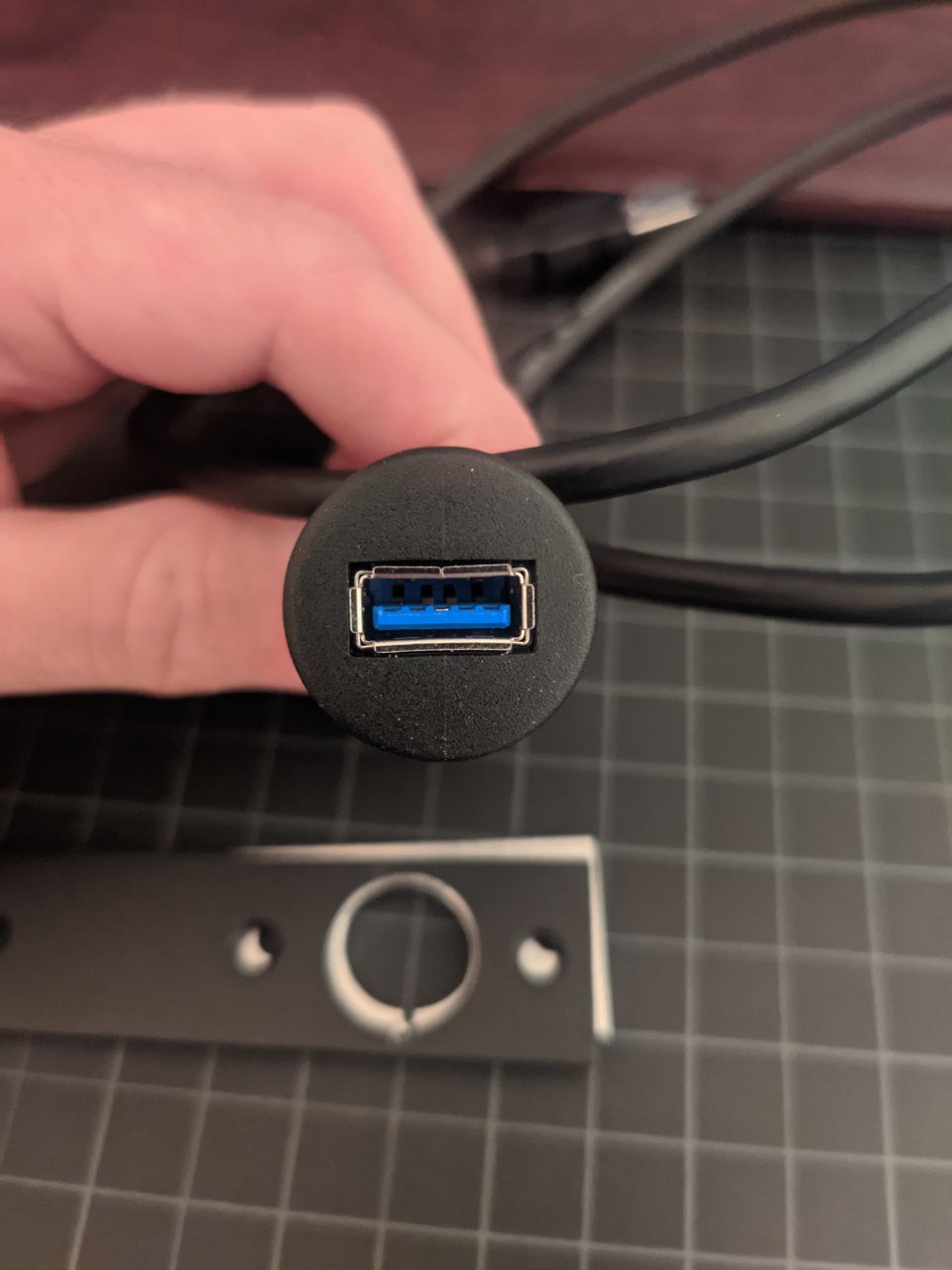

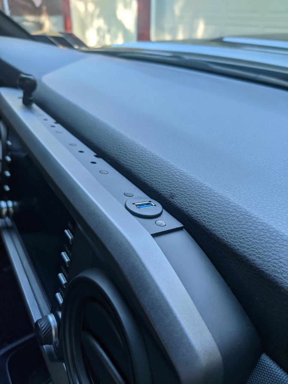

    Added a USB port to my DMM yesterday, similar to others in this thread but went with a single port for my use case.

    That’s real slick. Installed mine yesterday but might remove it to add something like this. Any links?

    Thanks!
    This is the USB connector I used.
    https://www.amazon.com/gp/aw/d/B078LMBQM6
    It is run behind the head unit and down towards the driver foot area. It is connected to this 3 foot cable
    https://www.amazon.com/gp/aw/d/B08FJ8VY6P
    Which is connected to this power outlet with a standard cigarette lighter USB adapter in it. Which is tapped into the fuse panel power outlet fuse with a fuse tap.
    https://www.amazon.com/gp/aw/d/B00G8WLW2Y
    Any combination of items like these should do the trick.

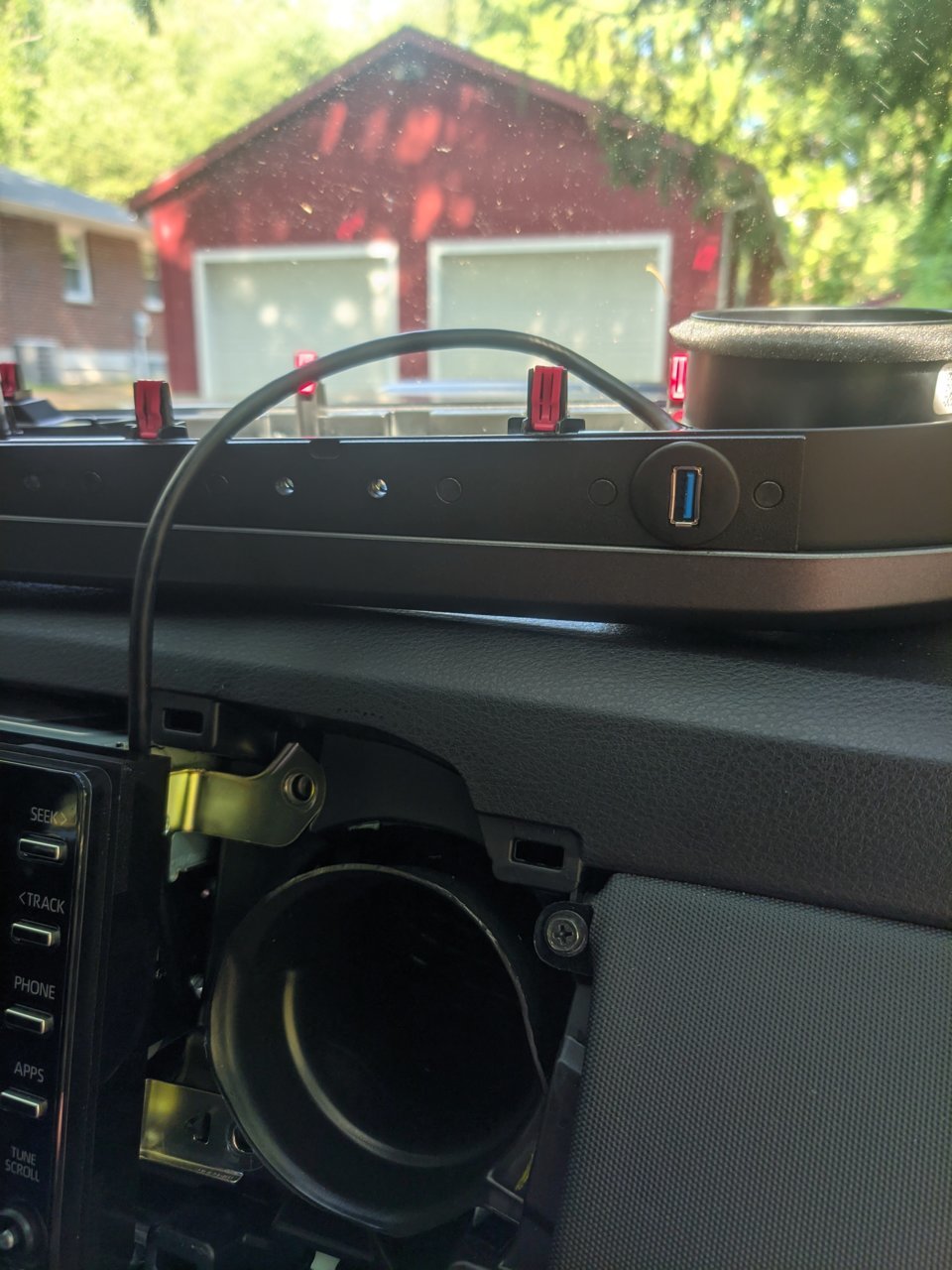

    Here are some more pics

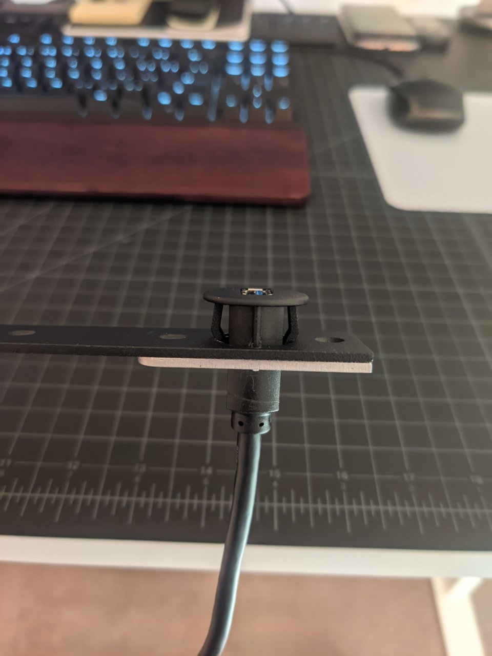

    Figment testing, used a step bit to drill the holes in the DMM. Drilled the dash plastic with it removed after determining the placement.

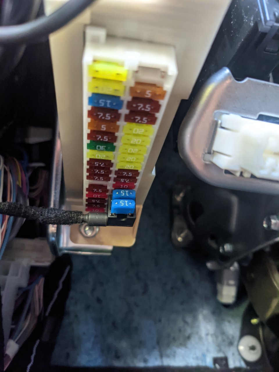

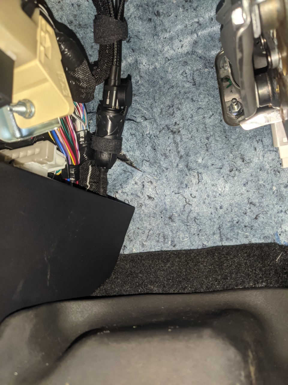

    Tapped into the fuse panel with an add a fuse and added a meso fuse cover. There is a ground screw nearby, I used the factory ring terminal on the Noco power outlet to connect to that but didn't take a picture. I removed the ring terminal for the positive lead along with the inline fuse and connected it to the add a fuse then heat shrinked the connection and wrapped the cable.

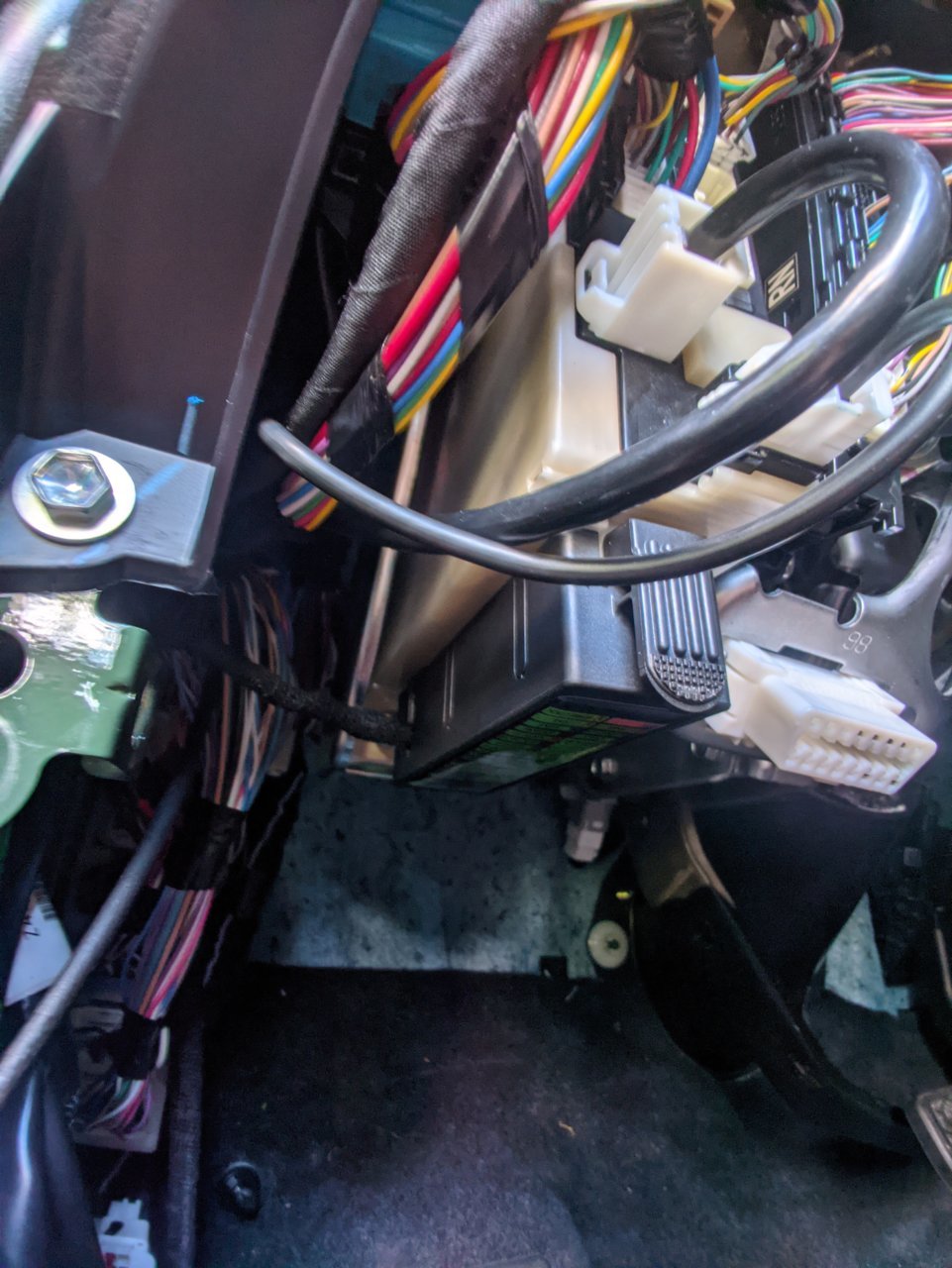

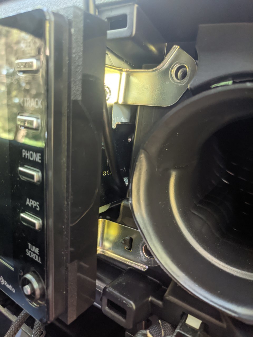

    Ran the cables like this

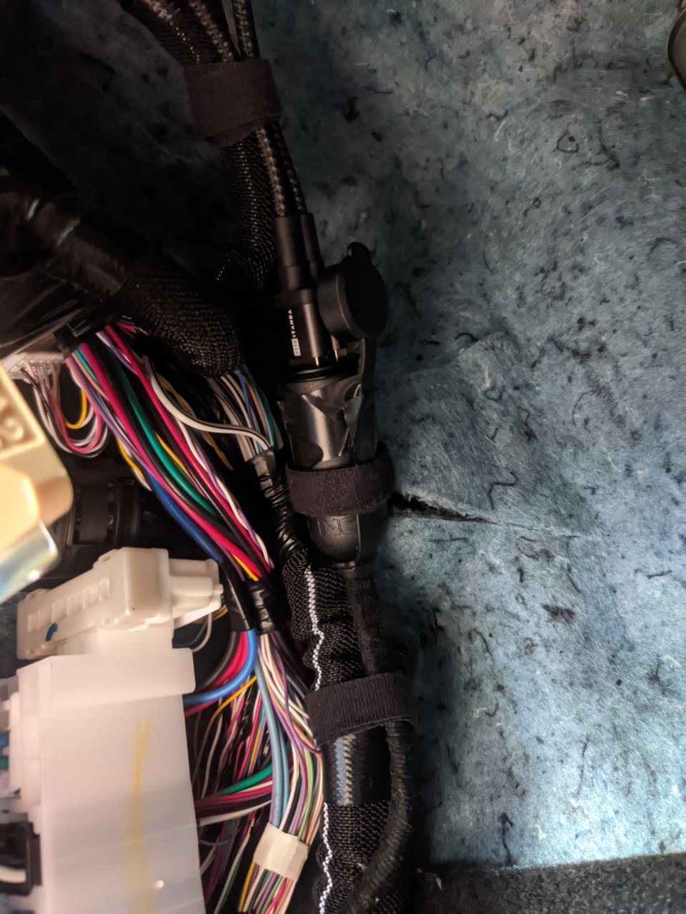

    Connected to the power outlet fastened to an existing harness tucked out of the way but still accessible. I plan to swap put the cigarette adapter with a quick charge one. This is just the one I had riding in my center console.

    Wow thanks. Going to copy this. What fuse is that? Looks clean man. I like the flush mount.

    I think it was this one. I had a handful lying around and some spare fuses, but this will do the trick. The fuses under the dash are micro type but I used the mini. Used the existing outlet fuse which is 15amps and added a 15 amp for the tap
