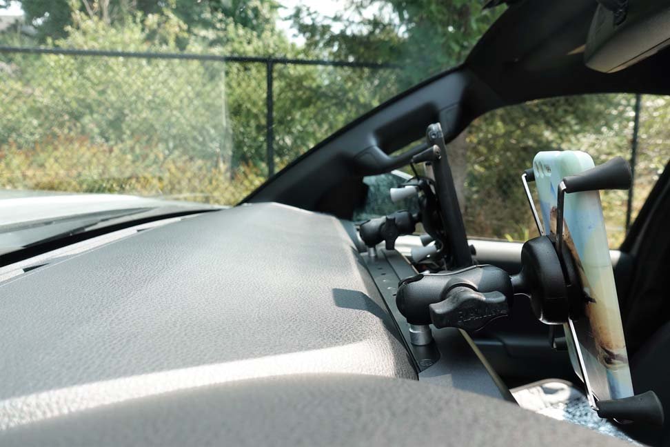

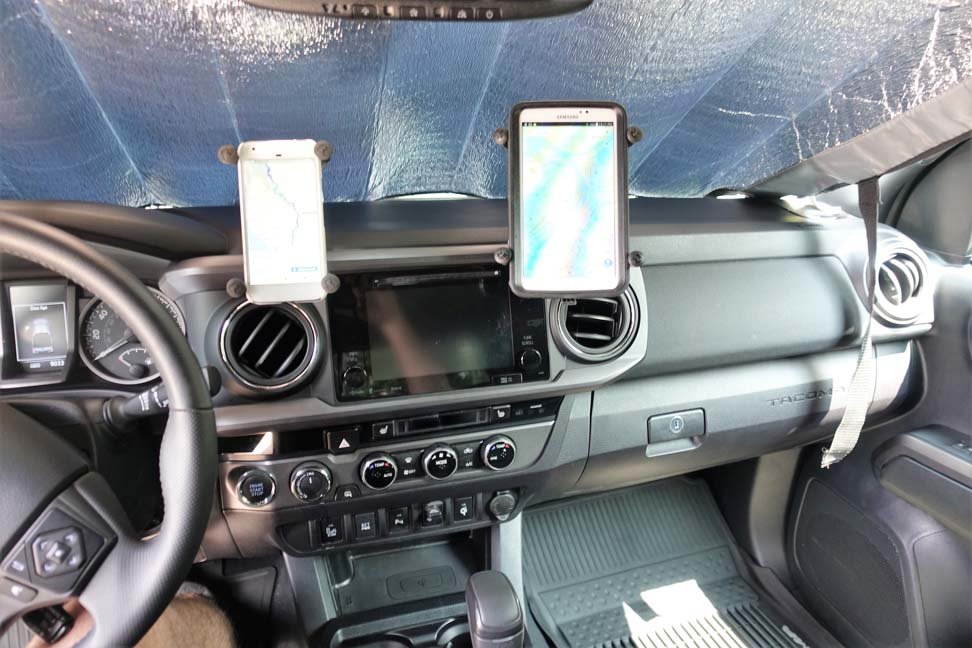

    another happy customer....no more phone falling off the magnet mount when going offroad

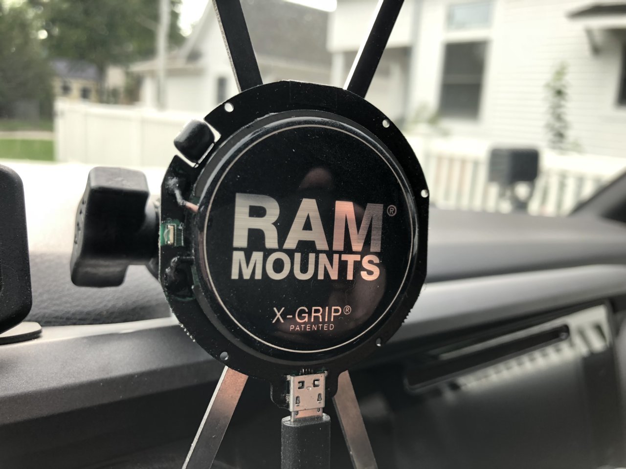

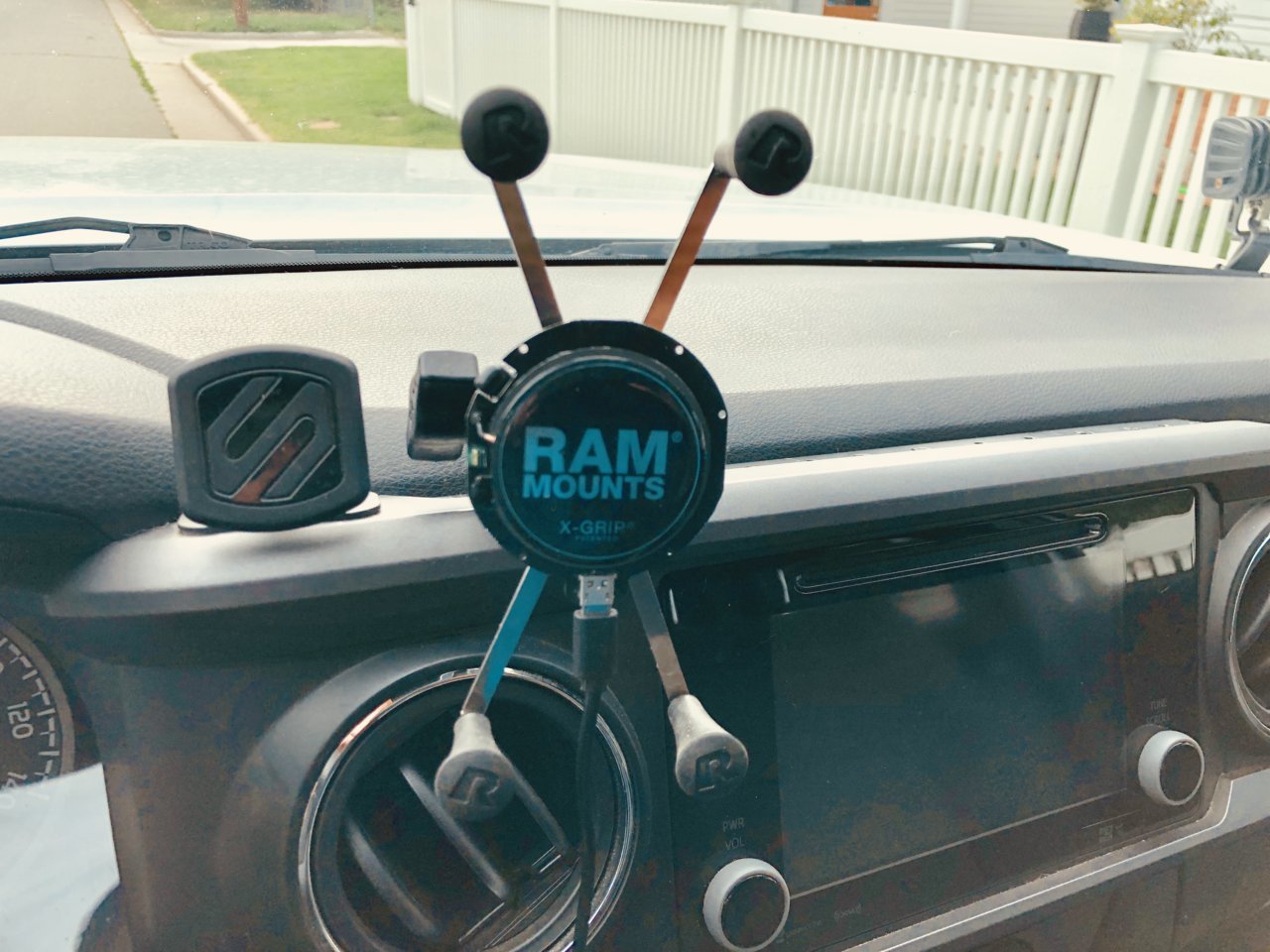

    Received my kit and had it installed in around 20 minutes. No issues at all. The real challenge was to open up a cheap magnetic Qi charger (https://www.amazon.com/dp/B07FC5TTWP) pull out the guts and mount it to the X-Grip.
    • Disassemble the Qi mount - remove the rubber pad and plastic barrier to get to four #000 phillips screws (smallest size) and remove them.
    • Remove charging coil and circuit board.
    • The charging coil is the same size as the rubber RAM sticker - pull that off (plenty of stick-em still on it) and apply over coil.
    • Tape off RAM sticker, small multi-color LED (charging indicator) on side and USB input.
    • Plasti-derp circuit board front and back - three coats, let dry and untape everything.
    • Mix up and apply 2-part, 5-minute epoxy and epoxy circuit board to X-Grip - make sure it's centered and straight.
    All done. Easy peasy, about 45 minutes of work and now no charging cables on the phone.
    Next step is to route a short USB into dash and tuck it behind to no visible hanging cables. I'll post again when that's done.
    Great product OP. Good job.
