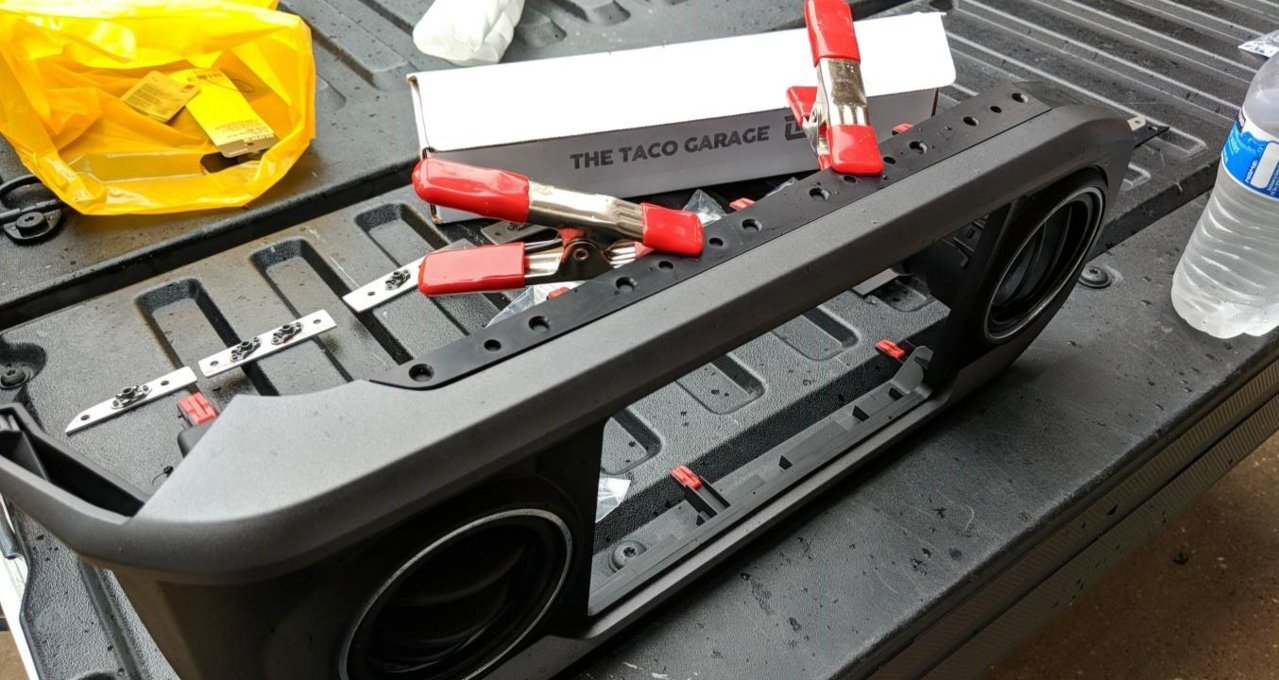

    This thing is absolutely awesome!
    I finally got a chance to install it after being away for work for quite awhile. I put it to the test on a pretty intense offload trail last weekend with an iPhone 8 Plus, BaoFeng UV-5R, and an iPad Mini 2. The mount was pretty rock solid and super helpful to have everything within eyesight and arm's reach. I decided to add two fast-charge USB cords behind the dash. This cleaned up the wiring in the cab for the iPhone and iPad chargers and also freed up my cigarette lighter to charge two additional devices with a dual USB charger so I could charge up to four devices at 2.4A each.
    More info and pictures below.
    Parts List
    Tools
    Instructions
    • DMM
      • Follow @FreshMexicanTaco's
      • I trimmed the little black tabs in order to fit the anchor bolts and nuts. I used diagonal cutters
      • I added black electrical tape over the nut plates I wasn't using to ensure they don't rattle (may not be needed)
      • I spray painted the lower portion of the ram ball mounts black to blend in (I covered the balls with painters tape while painting)
      • I used a file to deburr and clean up the drilled holes
      • After installing the DMM, install your RAM arms and accessories
    • Mounts
      • For the radio mount, I added a lock washer and the RAM ball. I spray painted the entire thing black to blend in (I covered the ball with painters tape)
    • Hidden Chargers
      • Drill a small pilot hole in the bottom left and right sides of the radio bezel working your way up to a 13/32" hole size (or other size depending on what USB cables you use)
      • Insert a rubber grommet into the two new holes (optional)
      • Always start with negative battery terminal disconnected (use a 10mm socket) and cover terminal with a rag so it can't make contact
      • Follow @FreshMexicanTaco's to remove the radio bezel
      • Remove the radio with the 10mm socket, there are four bolts
      • Follow @moe2o4 ’s guide to disassemble the dash panels. Use trim removal tool, 10mm socket, and phillips screwdriver to remove three trim pieces on driver side
      • Remove the fuse panel cover near the driver side footwell
      • Cut a few feet of the 18AWG wire
      • Separate and strip the red positive and black negative wires on one end of the 18AWG wires
      • Solder the red wire to the positive side of the USB plug and the black wire to the negative side, wrap in electrical tape to secure the wires
      • Feed the opposite end of the 18AWG wire behind the radio and towards the driver side floorboard
      • Remove the 15A P/OUTLET 2 fuse
      • Insert the removed 15A original fuse in the main slot of the add-a-circuit and the new 5A fuse in the second slot
      • Cut off the plastic butt connector off the add-a-circuit
      • Separate and strip the red positive 18AWG wire and the add-a-circuit wire and insert each end into the butt connector, crimp, heat-shrink, and wrap with electrical tape
      • Install the add-a-circuit in the P/OUTLET 2 fuse location
      • Install the @mesojdm fuse cover after removing one of the side slots to allow the add-a-circuit to pass through
      • On the black negative side of the 18AWG wire, strip it and crimp on the spade/fork terminal and then wrap in electrical tape
      • Connect the spade/fork terminal to the grounding location at the driver side footwell using a 10mm socket
      • Connect the two lightning cables (or other USB cables) to the USB plug (I used electrical tape to secure them)
      • Carefully insert the USB plug behind and under the radio feeding one USB cable to the lower left and right of the radio
      • Reinstall the radio with the four 10mm bolts
      • Feed the two USB cables through the new holes of the radio bezel and reinstall the bezel by snapping into place

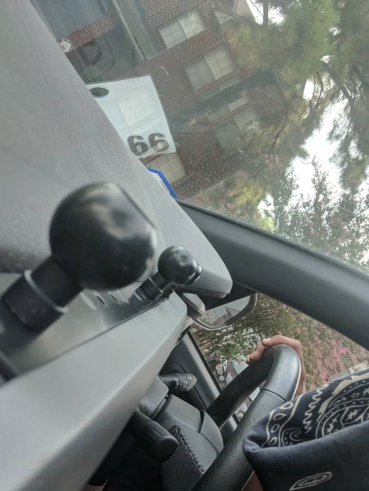

    got it saturday and finally able to install it now im just waiting for my ram mounts
