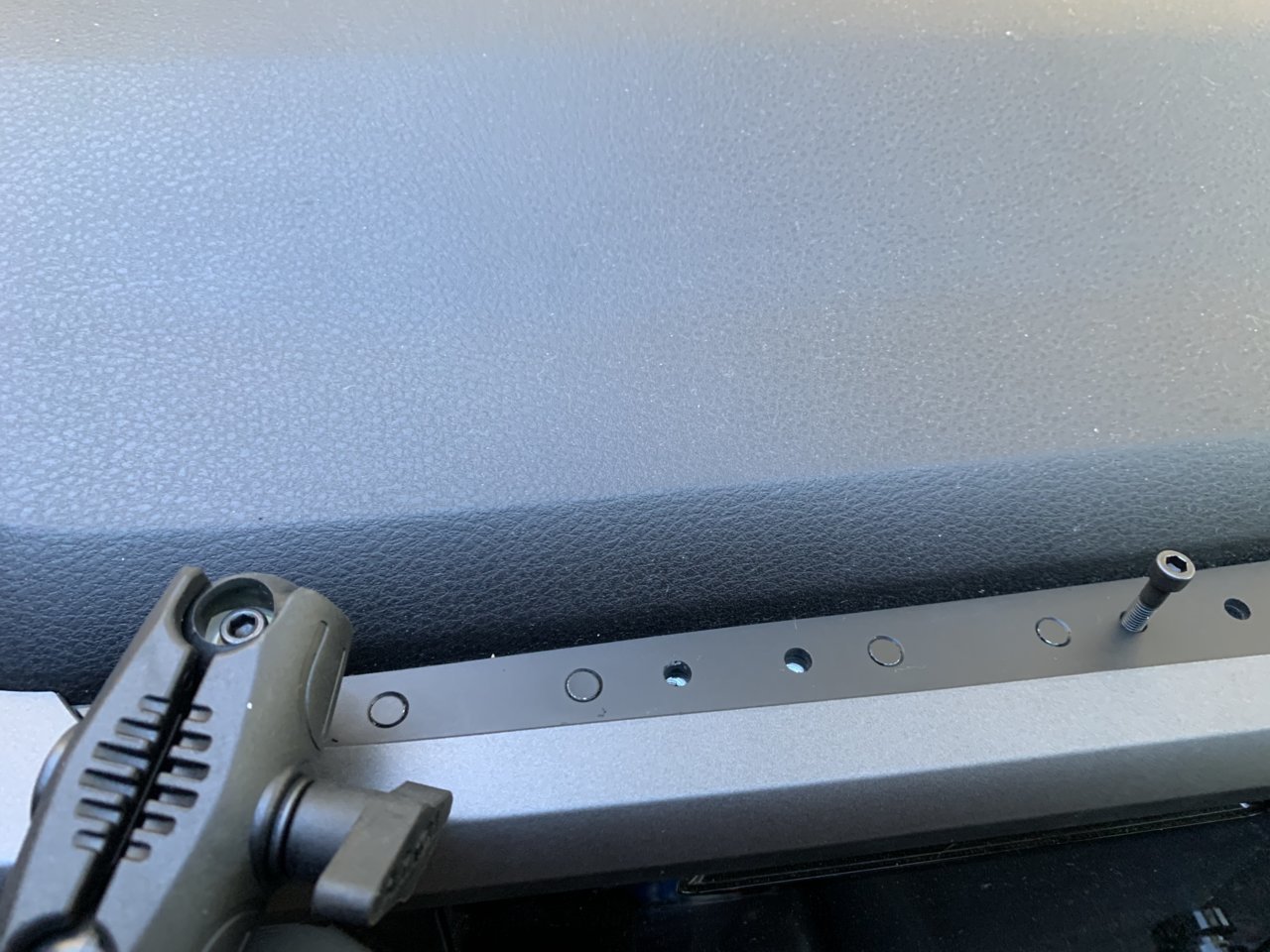

    The ball is rotating, i tightened it as far ad it will go.

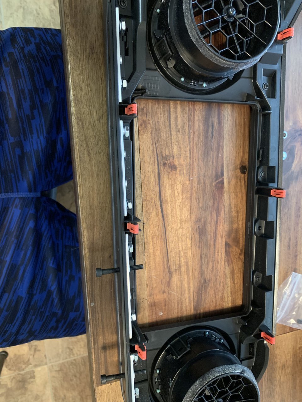

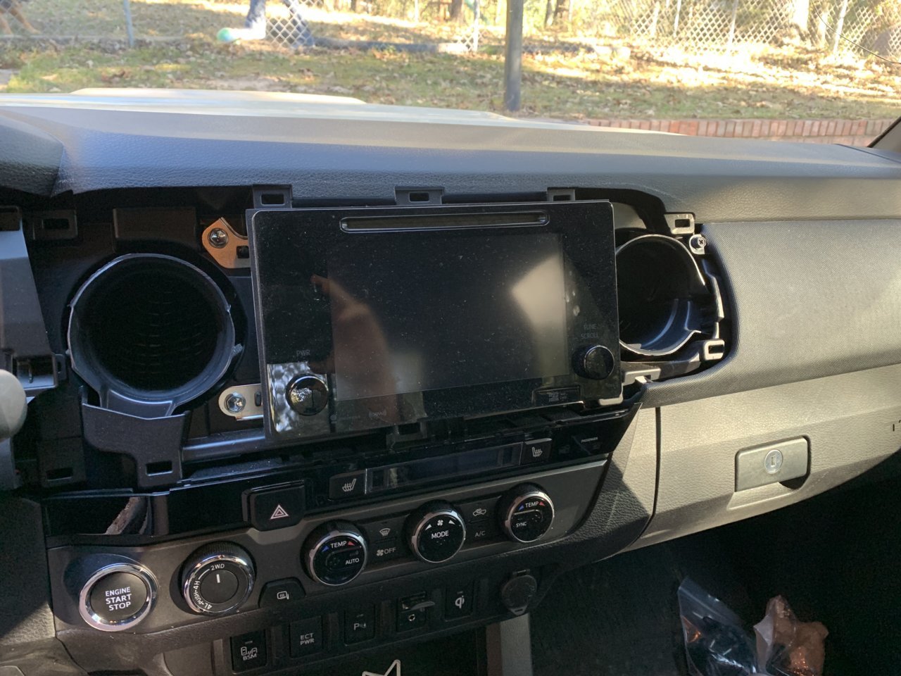

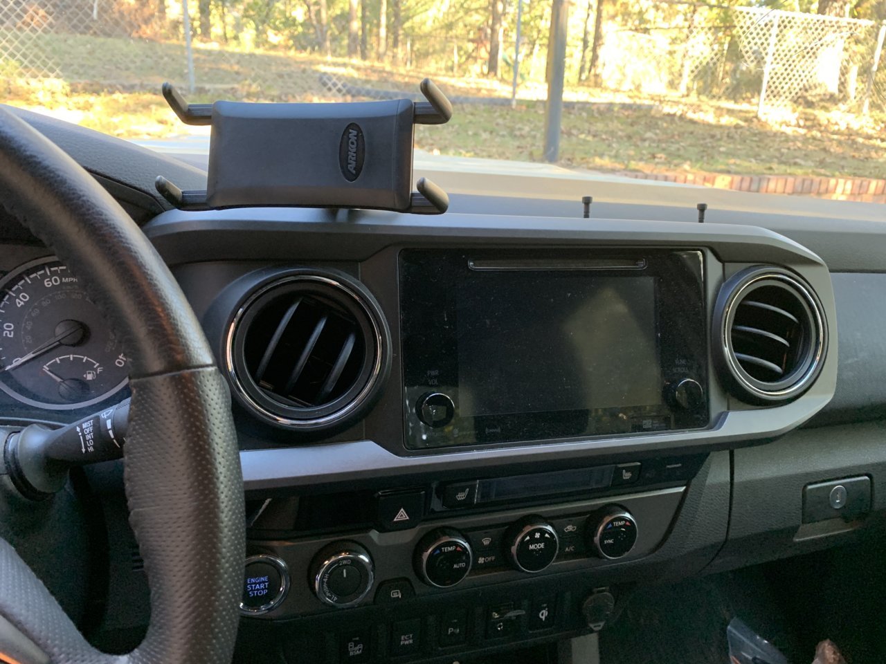

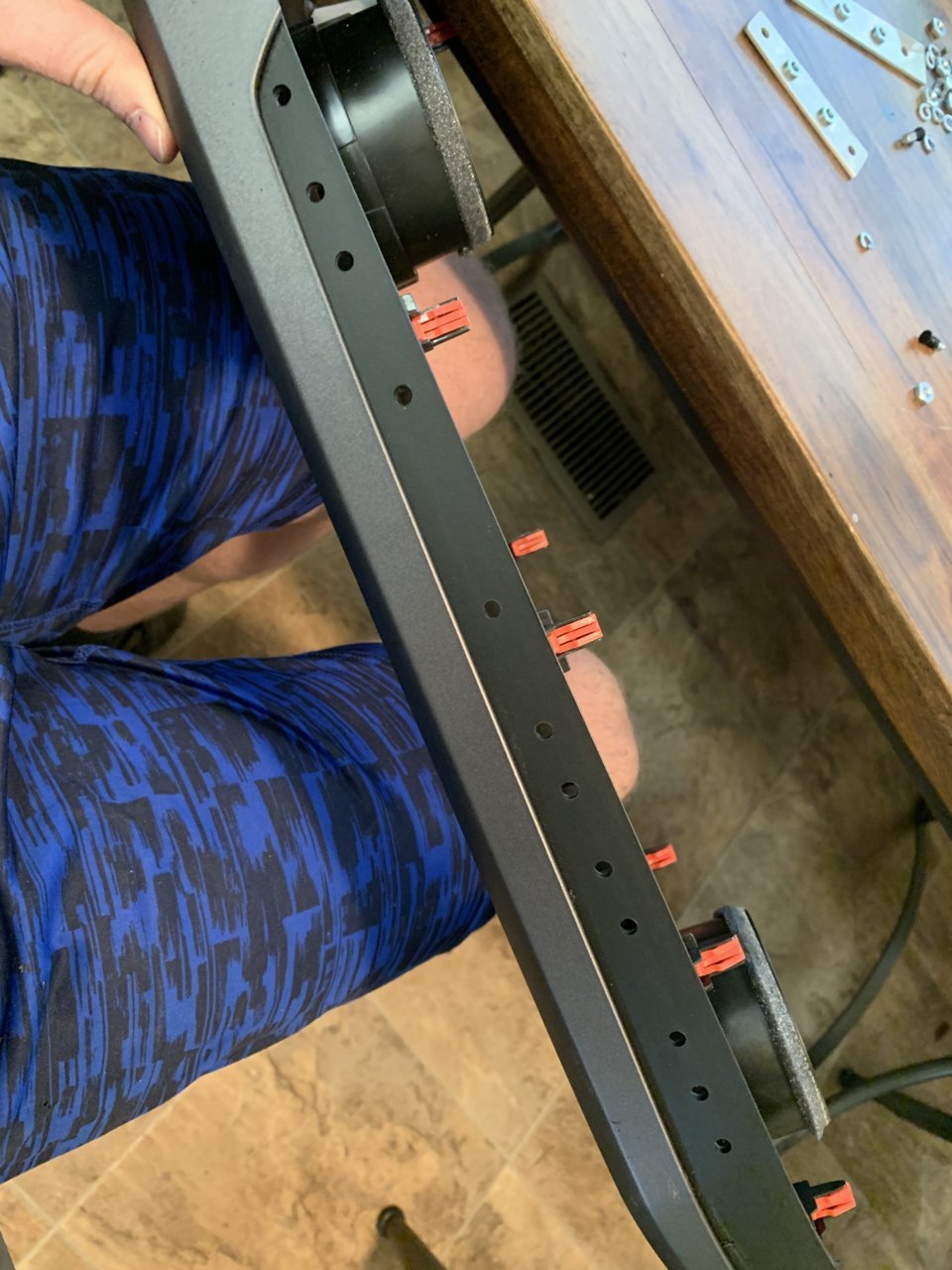

    Super quick and easy. I didn’t have clamps so I just held it in place with my fingers, I’ve been told I’m good with my fingers ;)so attempt at own risk. It all came out great.

    Maybe pull the trim piece off and see what is going on? You will feel resistance with the locking feature of the nutplates.

    Maybe put a drop of Blue locktite on the threads and then tighten it down.

    Hey man sorry to hear your having this issue, there's a couple of things that could be causing that but none of them are un-fixable, if I'm not mistaken you have a V1 DDMM, are you using the long silver bushing with the ball mount?
    or do you have the new kind (gold) flanged bushing?
    I had some problems with the silver bushings being just a tad longer than the stem of the ball mount, just enough to keep the screw from gripping the ball so it would spin, if thats the case you can just sand down one end of that bushing. Either way let me know and we'll figure it out

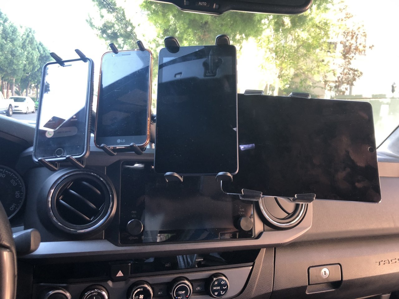

    Not that anyone would ever do this but here's what you CAN do with a DMM...

    Hahaha! What you can do and what you should do sometimes cross over.

    I've come close to this. 2 phone (mine and my wifes), tablet (for the wife/toddler to watch movies on), and a mirror (to see the toddler in the back seat). It worked well for the 3 hour trip. Setup was phone > mirror > tablet > phone. Worked out well IMO.
