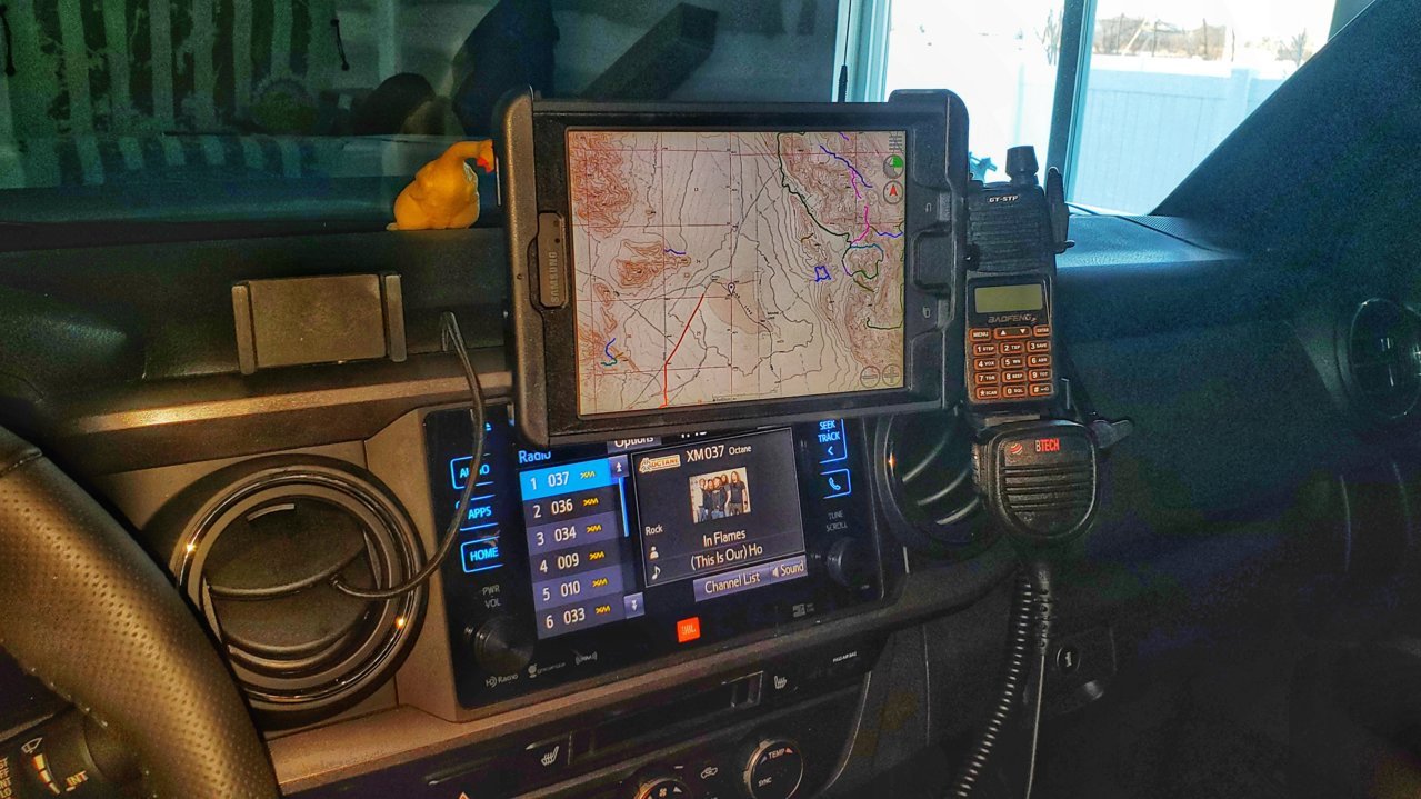

    Got 'er done!

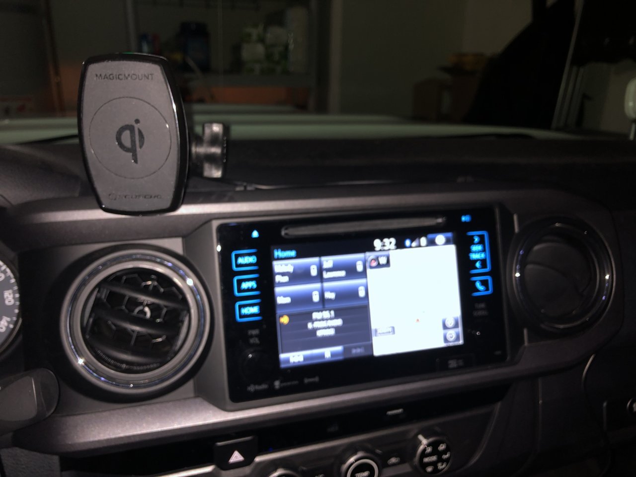

    Thanks for the awesome idea again. Ended up with the same Scosche Qi charger and drilled the back and mounted the same Ram Mount. I used #6 screws instead of bolts and nuts and they were 1/2” long. Added 2 washers per screw and also a layer of 3M double sided tape underneath. The screws barely went beyond the housing but very snug. Working great so far!!

    Which ball mounts or did you just paint the base black?

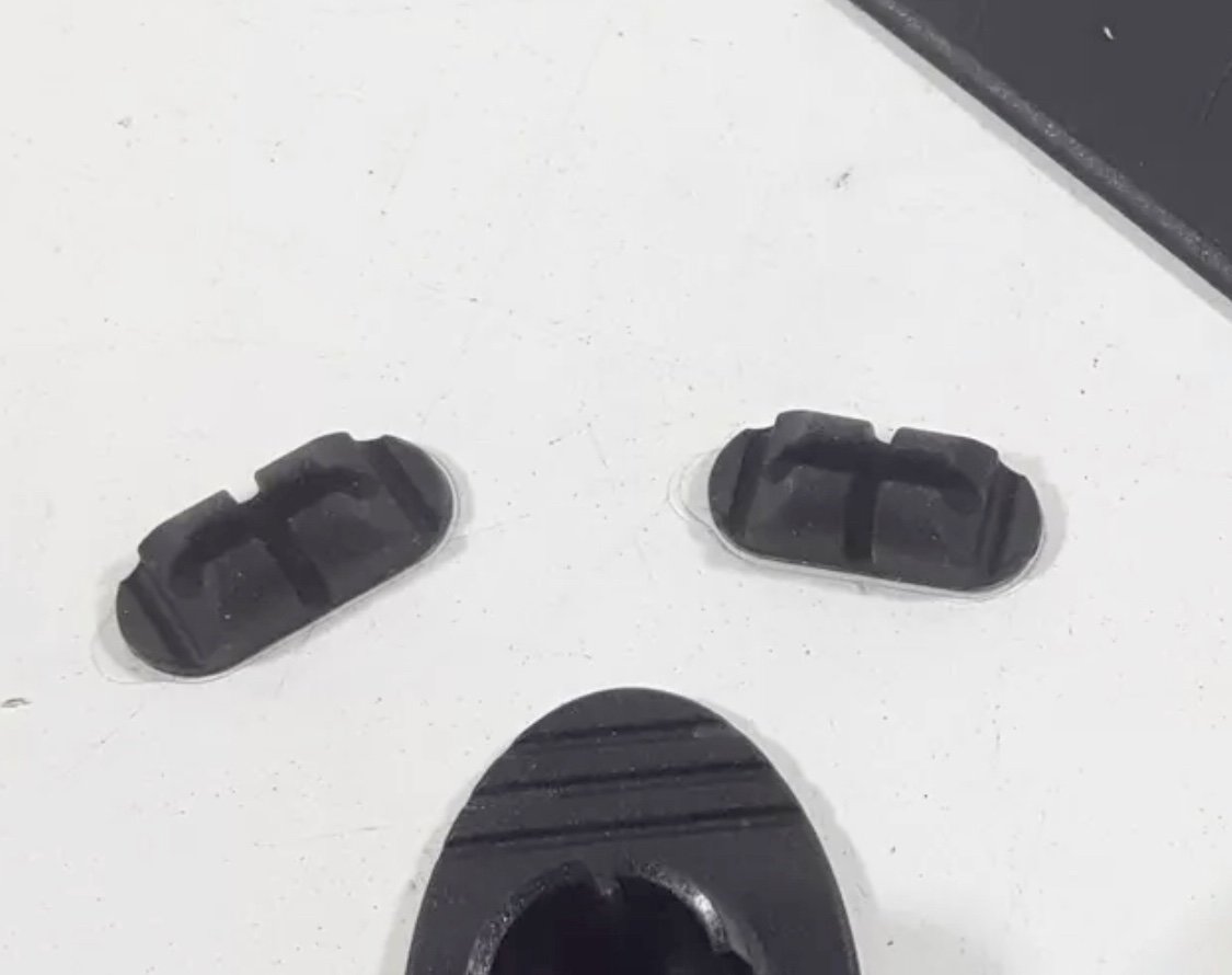

    So these came with my Scosche Qi charger and are rubber and very small. Wondering if anyone has found any cable management that is very minimal and sleek like these. Not trying to buy Hondos clips for $20. Did a search and still couldn’t find anything similar. What are you using for cable management?

    Just painted black.

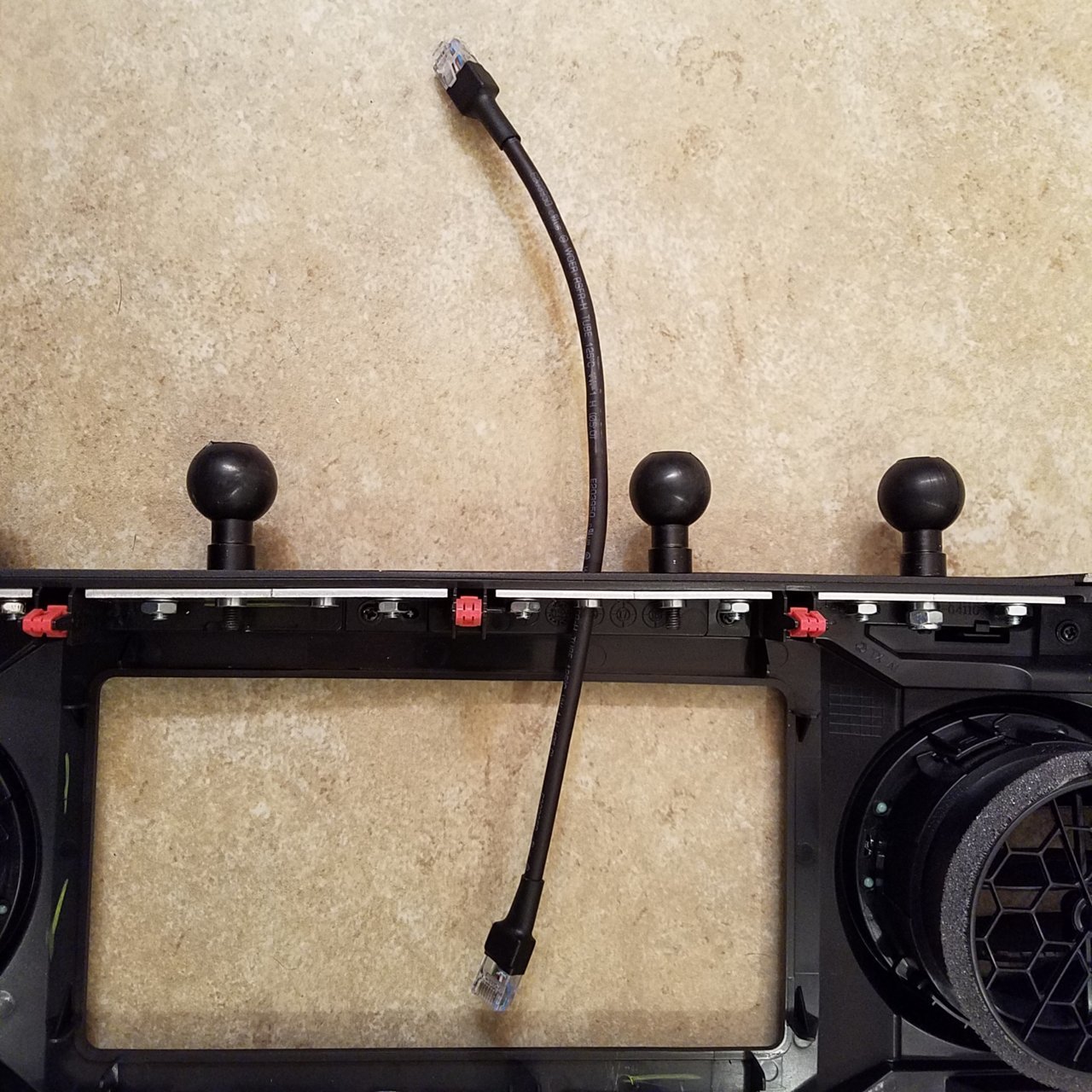

    Awesome solution....however, is there a solution to wire a larger "opening" on it? I have no issues drilling one out but there could be a solution to make ONE hole bigger to allow for the passage of cables.
    I would suggest that the CENTER area of the DMM would work perfectly but many folks would not like that.
