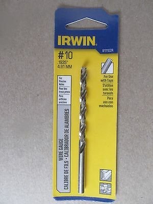

    Our local tool house, KMS Tools sells loose drill bits. I bought #10 bits for a couple bucks each.
    You can pick up a Number drill bit set from Harbor Freight for $20.
    If you’re just wanting get the holes in there without spending more money, a #10 drill should measure .1935” so your best bet would be a 3/16” (.1875”) drill bit.
    After doing the math, at only .006” smaller, I should’ve just used the 3/16” drill bit…
    Here’s the link to the chart.
    http://www.carbidedepot.com/formulas-drillsize.htm

    Just use a fractional equivalent. It's close enough and absolutely won't matter, especially with the tapered screw heads.

    If you have a local Ace Hardware, they should have single numbered bits. I got one like below at my local store. They are usually by the taps and dies.

    The drill bit does NOT have to be a #10, that's what we recommend but we understand that not everyopne has it, 3/16 may be a little small, if not lined up correctly the screws may crossthread, burrs can also make that a really tight fit if not cleaned up. It is better to oversize the holes rather than making them smaller.

    they said specifically to avoid using 3/16. Not sure why.
  12. Aug 4, 2022 at 11:40 AM
    #1832
    TheTacoGarageServiceRep
    TheTacoGarageServiceRep Well-Known Member
    May 18, 2021
    #366093
    86
    Andy
    2019 TRD OR
    3/16 is smaller than the size of the 10-32 screws that we use. Using a 3/16 will make the hole 0.1875 inches and the screw itself has a nominal diameter of 0.1900 inches that makes for a realkly tight fit and may cause interference, stripped screws and other issues. you are much better off using a larger bit than a smaller one

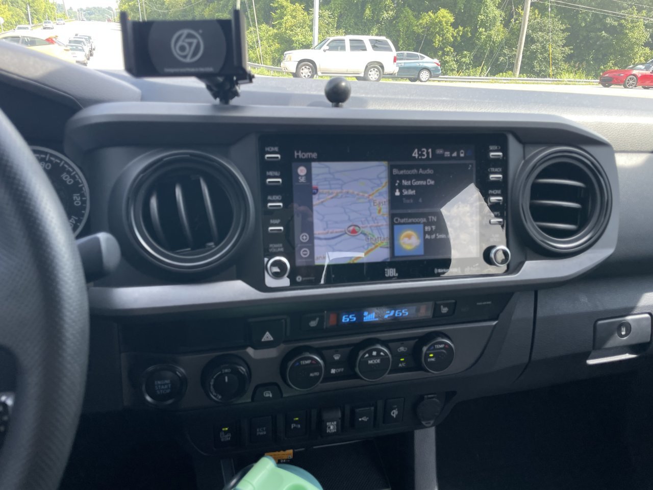

    Do your balls loosen when you try and put the phone on your mount? Mine moves to the right a unbit loosening the ball. So say I insert the phone into mount pushing it open on the right side, which turns the ball mount.
  16. Aug 19, 2022 at 9:09 PM
    #1836
    TacoTuesdayNJ
    TacoTuesdayNJ Well-Known Member
    Feb 20, 2021
    #356833
    156
    . Mine don't move a bit but Snug the balls up a bit with an Allen wrench. If that doesn't work, use a dab of blue locktite
