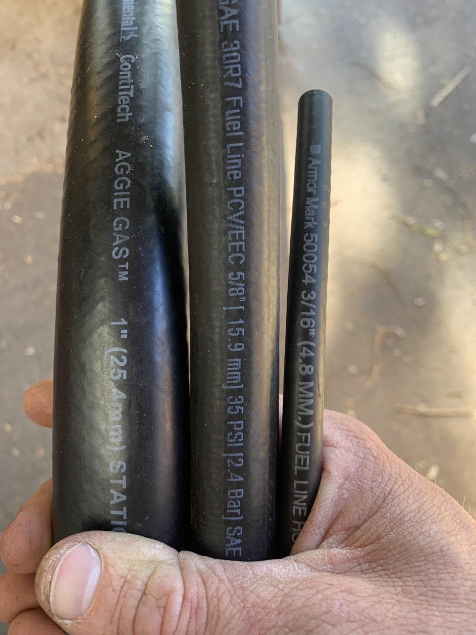

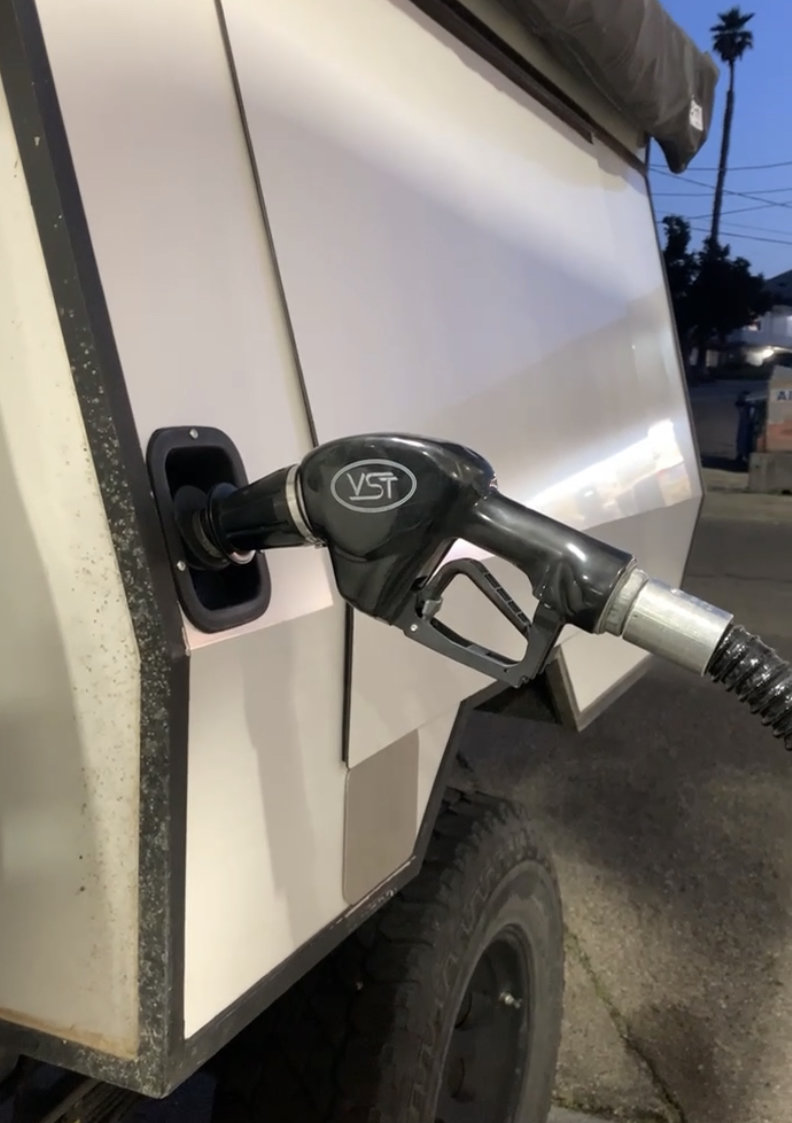

    So my previous fuel filler location can be seen in the old posts but it was a little bit lower than factory and while it worked okay for the better part of a year, it eventually started to spill while filling and stopped filling hands free.
    I ended up rerouting the fuel filler through the front driver side of the camper and boxing off said corner with scrap composite panels and sikaflex to keep fumes and spilled fuel out of the interior. Throw in a plastic bezel and a locking gas cap off Amazon and we're back in business, hands free at the pump.
    Spy the old filler location under the hatch.​
    It took a bit of digging to find the right size hoses so I wanted to put everything I used in one place. These are the 3 lines: fuel filler, breather, and evap. I ended up cutting the filler neck off with all three hard lines still attached to the factory hoses then used the additional hose to reroute the filler neck to a higher spot on the camper wall.
    Line sizes:
    Fuel line - 1" (25.4mm)
    Breather - 5/8" (15.9mm)
    Evap - 3/16" (4.8mm)
    So far so Good!
