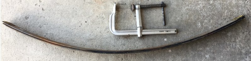

    Here's the run down on what I found to be the differences between the "A" side and the "B" side.
    We'll use this as a reference to identify each leaf:

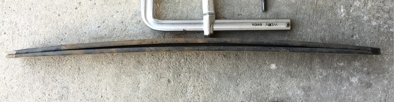

    #3 (3rd) leaf. Bottom = Pass (B), Top = Driver (A). Arch is identical.

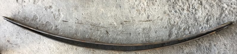

    #4 (4th) leaf. Bottom = Driver (A), Top = Pass (B). Driver (A) side has more arch.
    #6 (top overload). Bottom = Driver (A), Top = Pass (B). Pass seems to allow for more "flex" or negative arch.

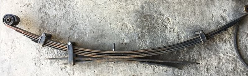

    Driver's (A) side full leaf pack.
    I ended up installing the full leaf pack on my driver side and on my passenger side I left the top overload (#6) out. So far it looks to be a lot closer to being even from the rear, left to right. Unfortunately I only have before measurements as I was strapped for time. I also adjusted my front coilovers to compensate for the extra height that I gained. Either way, once I find a flat surface I'll get the current measurements.
    Previously I had removed both the 3rd leaf and the top overload from both sides. Ride was soft and the height was slightly too low for my liking. Also, when loaded, even just around 100-150lbs, the rear would start to squat already. For these reasons I opted to install the 3rd leafs back into both and the top overload on only the driver's side to compensate for the "taco" lean.

    Leaves/leafs 1-3, 5 and 7 have the same arch
    Leaves/leafs 4 and 6 differ from the "A" pack and the "B" pack
