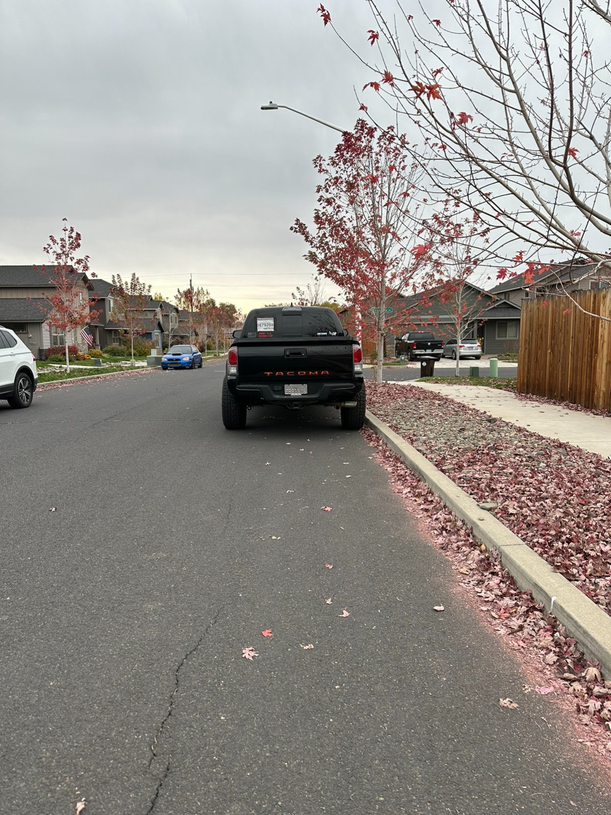

    I’ve noticed that my truck is leaning, no frame damage and the spring hangs r all perfect. the shock was just replaced this is also on a full tank. only in the rear the front is normal

    Gas tank lean. Learn to love it.

    really? i see other tacomas and they all look straight minus mine LMAO

    That seems like an awefully heavy lean. I'd guess something isn't right there. Have you thoroughly checked underneath? Anything loose or bent perhaps?

    nothing looks out of the ordinary. when i lift up that side of the bed it like evens out. so im not sure if its a bed issue that needs a spacer?

    I'm not joking, look it up. Some do it worse than others.

    that looks pretty extreme. something doesn't seem right.
    Was it just the shocks changed, or the leaf springs? Maybe side specific and on the wrong side?

    yes, Tacos are prone to the 'taco lean'. Yours seems excessive though.
    edit: in the photo you are not quite in the middle of the stall. Is the stall sloped?

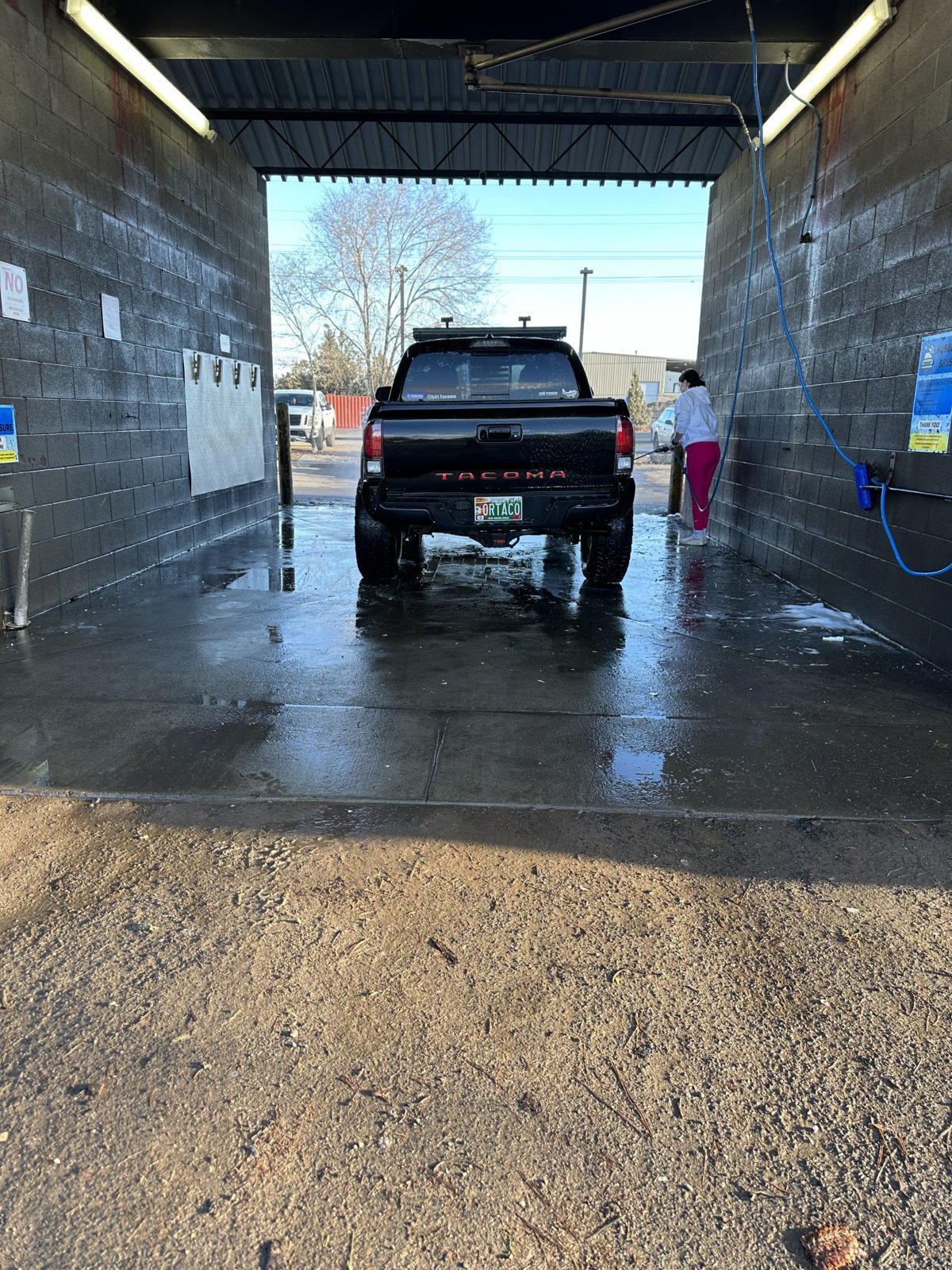

    How about a photo with a nearly empty gas tank?

    i think this is a pic of it, when it’s almost empty the lean is not that bad at all

    the stall was not sloped
