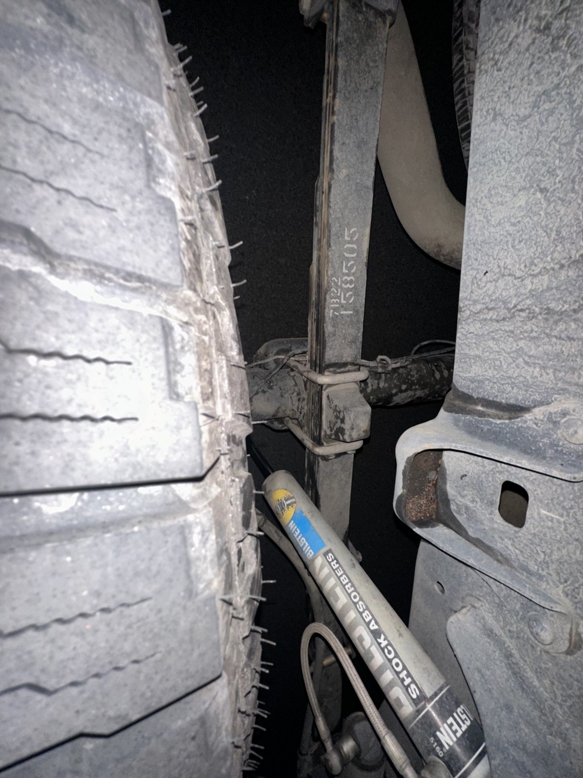

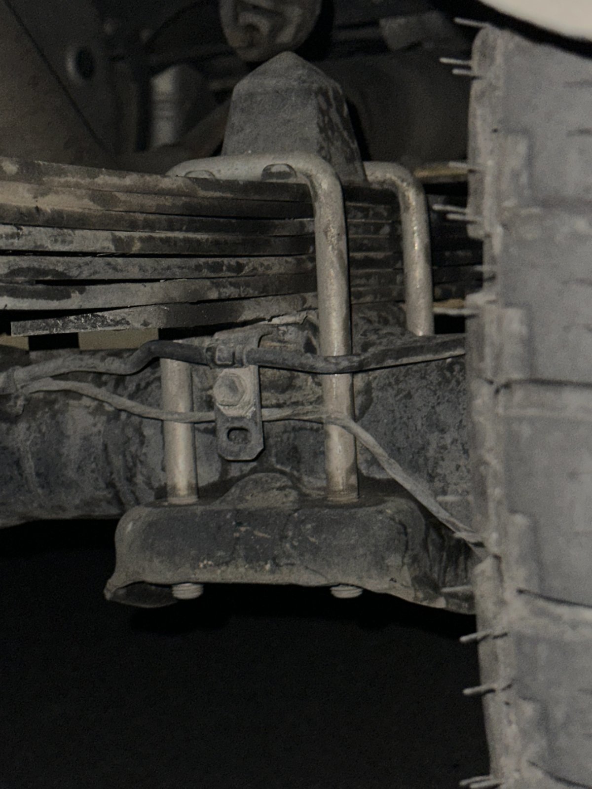

    here are the pictures i could get, just got dark. i’ll try to get better ones in the morning

    It looks like one of the leafs on the right is broken in half. That or you have 6 leafs on one side and 7 on the other.
    JKU3000 likes this.

    Which photo? they are all drivers side from the looks of it.

    Ah ya, I think you are right that the 2nd 2 photos are the same side. In any case, I count 6 leaves on one side of the axle and 7 on the other. And there also is what appears to be a broken and disconnected leaf.
    A broken leaf on the driver side would likely cause some excessive taco lean to the driver's side.

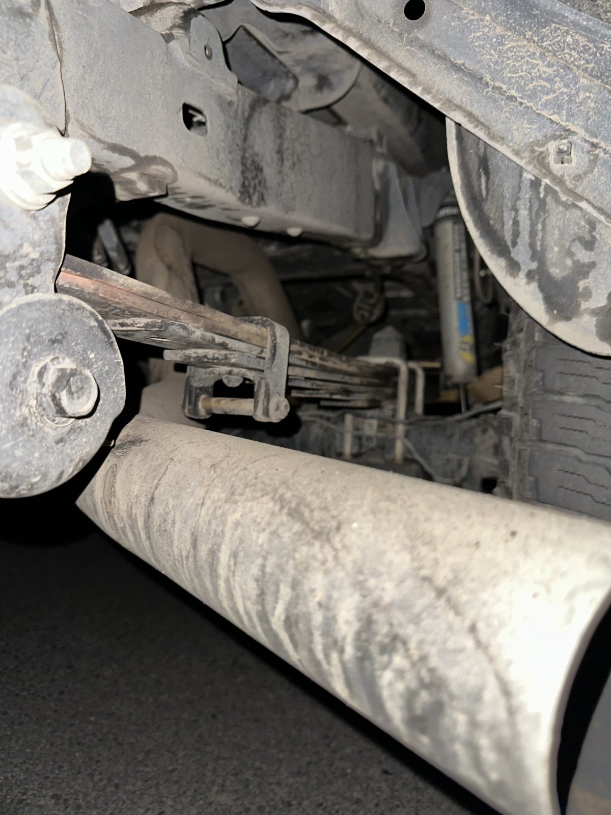

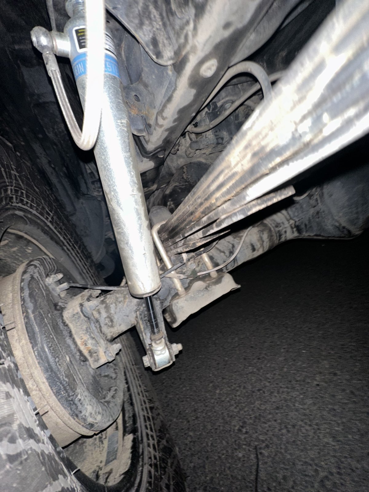

    here are the passenger side pics, sorry again if they aren’t the best.

    I count 7 in front and behind the axle I believe? As long as he has 7 leafs on the passenger side too I'd lean towards the bushings being tightened down on with the wheels off the ground. I've seen it cause issues on the front with leaning or to much lift before too.
