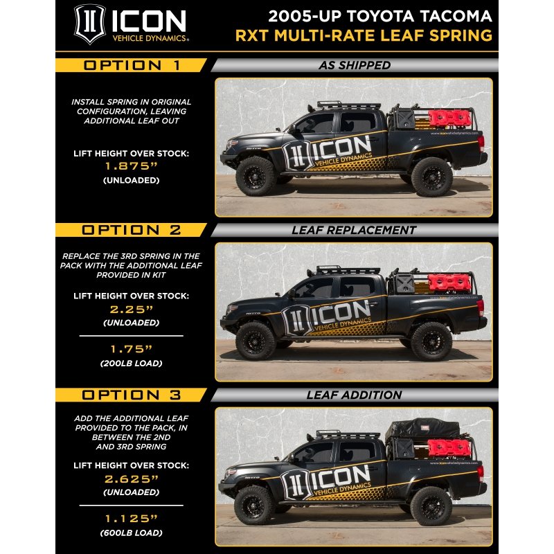

    Cool stuff
    I bet they didn’t match up the settings on the RXTs

  10. Jan 4, 2024 at 9:06 PM
    #130
    SailinTacos
    SailinTacos [OP] Well-Known Member
    Jun 26, 2023
    #427709
    75
    2018 Black Tacoma TRD Off-Road
    They installed at stage one because i never have anything loaded or hauling anything
  11. Jan 4, 2024 at 9:15 PM
    #131
    fake4x4
    fake4x4 Well-Known Member
    Jun 20, 2015
    #157787
    917
    Los Angeles, California
    3rd Gen Tacoma TRD Off-Road DCSB
    Cool stuff
    I would double check that

    Cool stuff
    Could be an icon error as well

    Well i went over to the suspension shop i had them installed at and they verified that they didnt tighten down the boly and torque them untill the truck was on its weight. They think that Accutune Offroad sent one spring that was more firm than the other one, so the softer side is sagging. They said to call them and return it and they will put factory springs and blocks on in the mean time. Will see how much this mess up is this time smh.
