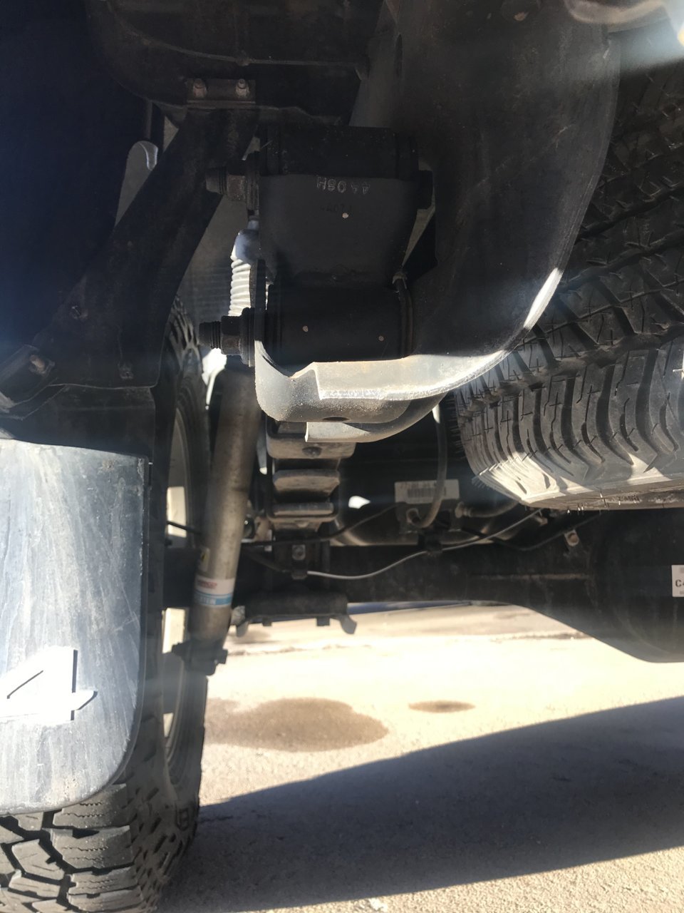

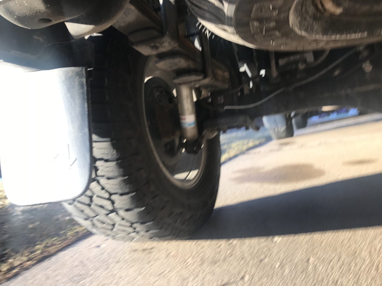

    Recently noticed a noticeable increase on the drivers side lean, at least 2-3in. I have a medium Dakar pack in the rear and 885s up front with the spacer. Anything I should look for in specific? Took a quick glance and everything is in place and ride is fine. Thanks for any advice.
    Passenger: 24.5
    Driver: 22.25
    B8146278-1D26-4115-8511-721DEFAE307A.jpg BE182F08-759B-4F7E-AFA4-7BF3F24A99C8.jpg 1D238FC8-9B4E-426D-957B-3AF836B788FC.jpg

    Broken coil spring on the drivers side?

    The pack is probably junk at this point if there is THAT much lean.
    The only other thing which you could be looking at is body mounts, but I doubt they are bad enough to the point where they are causing THAT much lean.

    Measure the distance between the top of the leaf springs near a u-bolt to the bottom of the frame.
    This will at least give you an idea if the height difference between sides is due to the leaf springs or something else like the body mounts.

    Funny, I too noticed a big drop on the driver side that started about a 2-3 months ago. I was just going to suggest measuring between the top of the axle tube and the bottom of the frame rail. I did this on both sides and I'm 1/2" lower on the driver side.

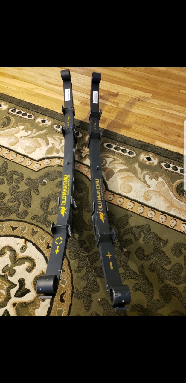

    On the dakar leafs they have 3 ratings painted on top of the leaf. + , - , 0.
    + = over spec
    - = under spec
    0 = at spec
    Mine arrived 1 at 0 and the other at +. I installed the + on the driver side as that side is heavier on a taco. I got perfect side to side lift. I would check the top of your leafs and see what spec you have and on which side.

    Thanks! Triple check this when installing them, just checked again. + is on the Driver Side and 0 is on the Passenger Side.
