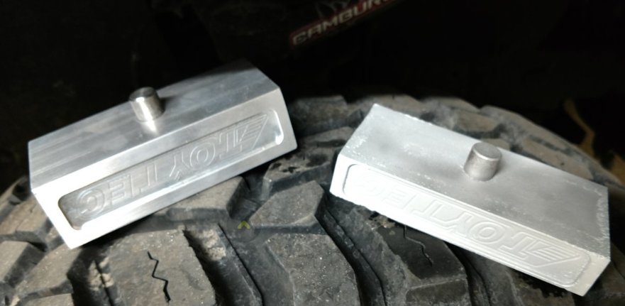

    Here is how I corrected the infamous Taco Lean.... I have Dakar CS047Rs and after a year or so the leaf springs settled so I had added Toytec 1" spacers .... 3 years later the drivers side was 1/2" lower than passenger side. Added the extra 1/4" spacer on top of the driver's side front coilover, still did not correct the issue. So to get the result I was looking for, I purchased a set of 1-1/2" toytec rear spacers and swapped out the 1" spacer on the driver's side with the 1-1/2"..... Perfect.....

    Not really, measure your D&P side wheel wells front and rear...... my rear driver's side rear was 1/2" lower than passenger, so i put a 1/2" taller spacer in the rear...... did the same for the front.... pretty simple and straight forward.
