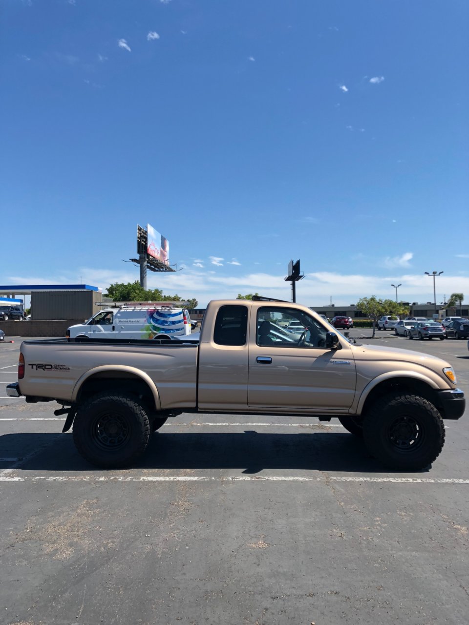

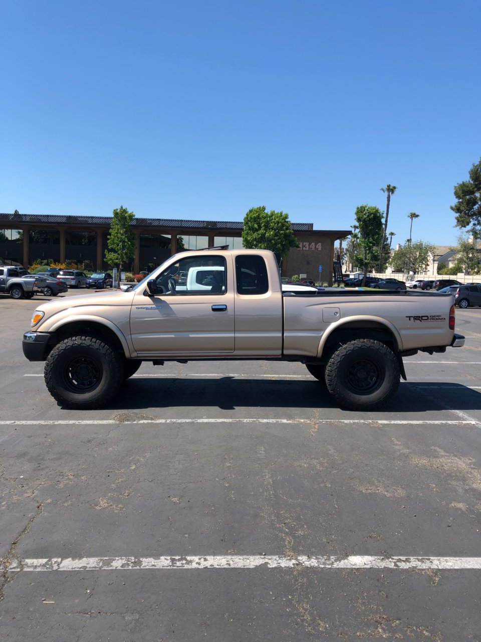

    I have the expected Taco lean and am curious on the established solution of adding a spacer to the left front.
    In the pictures of my truck you can see that the right rear is where it's the highest. Will the spacer on left front bring that rear corner down, or simply raise the drivers side?
    I currently have 881 with 3/8" top plate, and progressive AAL with overload still in. It gave me so much lift in the rear with too much rake, which looks to be subsiding a bit after some wheeling and road tripping. Just want to level her out some.

    I already have the 3/8" spacers installed. I could replace drivers side with a 1/2" to level it out. Which comes out to about 3mm increase. Would I need more? I could stack a 1/4" on top of the current 3/8" for more like 5mm lift.

    So, your side pics don't really give a good idea of the "taco lean", which is left to right, not front to back...
    The leafs should wear down a bit - take it off road and give her some flex, she'll settle down.
    But don't stack spacers. You could have different length spacers on each side maybe, but don't add multiple spacers on one side.
    From what I've seen, most people end up with a 5mm spacer on the driver side front to counteract all the weight from the driver and fuel tank being on that side.

    Yeah the pics I took from the rear didnt show the lean very well, but its noticeable IRL (passenger side high.) I wanted to show the rear passenger side wheel gap being much more than the driver side in the pics.
    Good to know about stacking spacers. Thanks! Maybe I can keep the 3/8" on the passenger side, and replace the driver side with a 1/2" then.
