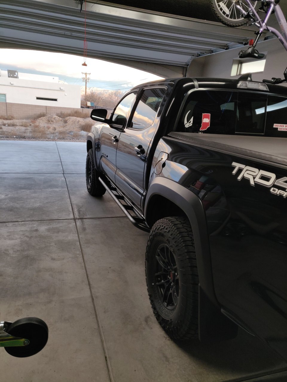

    Okay here is a solution that works for me... Kinda unpractical... but hey.. Put your full size spare in the back right of your bed (passenger side). You will notice how even the stock spare location is more towards the driver side. I found this helps compensate for the fuel tank location and pulls the driver front up a bit.
    My Truck 2021 TRD OR
    5100 all around and set the front to position #2 (.65 inch lift).
    P265/75r16 tires / TRD Pro wheels
    tank 5/8 full
    I also have Avid OffRoad Nerfbars that look like rock sliders ( 35 lbs each)
    Toyota heavy ass bed mat
    Tri-fold tonneau cover
    Post change (note I am plus sized on the tires/ so sub 1/2 inch for stockish numbers)
    DF: 36.250 PF: 36.250
    DR: 36.600 PR: 36.500
    Cheers!
