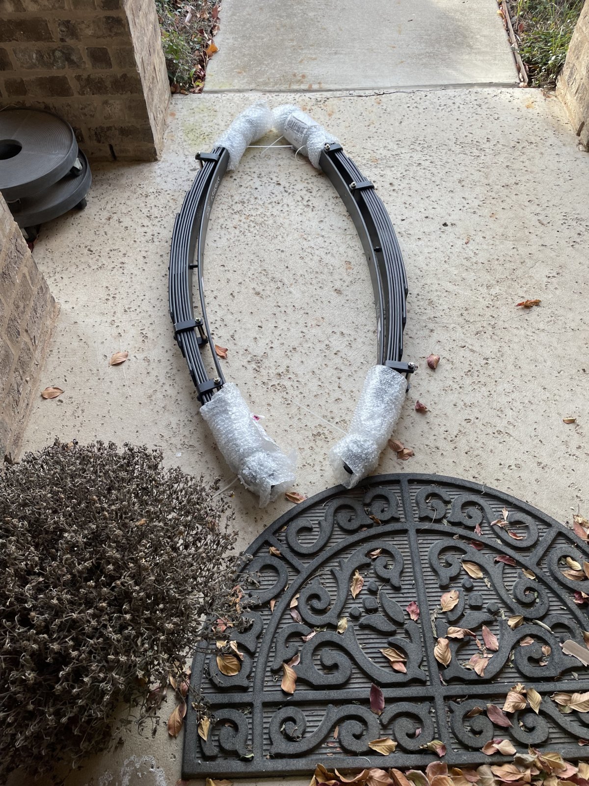

    Probably going to end up with 2”… was hoping for 1.5”.
    These arrived today in stellar packaging.
