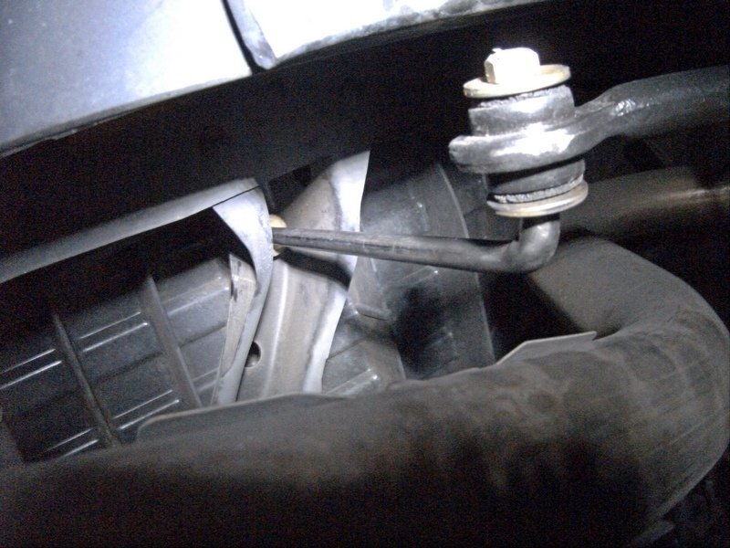

    TACO LEAN UPDATE:
    My alignment job turned out pretty well. The truck steered better than ever, and then it didn't.
    :confused: WTH? Alignment went wonky.
    I was pumping more air in the rear bag as I thought it had leaked. Then I saw the broken link.
    It turned out the rear stabilizer bar I added was helping to control the taco lean, a lot, and suddenly it wasn't.
    I had jacked things up too much with the air bags and at full droop my custom linkage topped out and one broke off at the bend.
    The link ties thru the spare tire crossmember with rubber bushings. This was taken 4 years ago.
    I made it into an adjustable rod end by welding a bolt to a coupling nut. I also made them 3" longer, to prevent "topping-out"
    and overstressing things.
    Anyhow handling is restored, but the stabilizer is doing something it isn't supposed to: level an unladen vehicle.
    I am planning a re-balancing act of some kind.

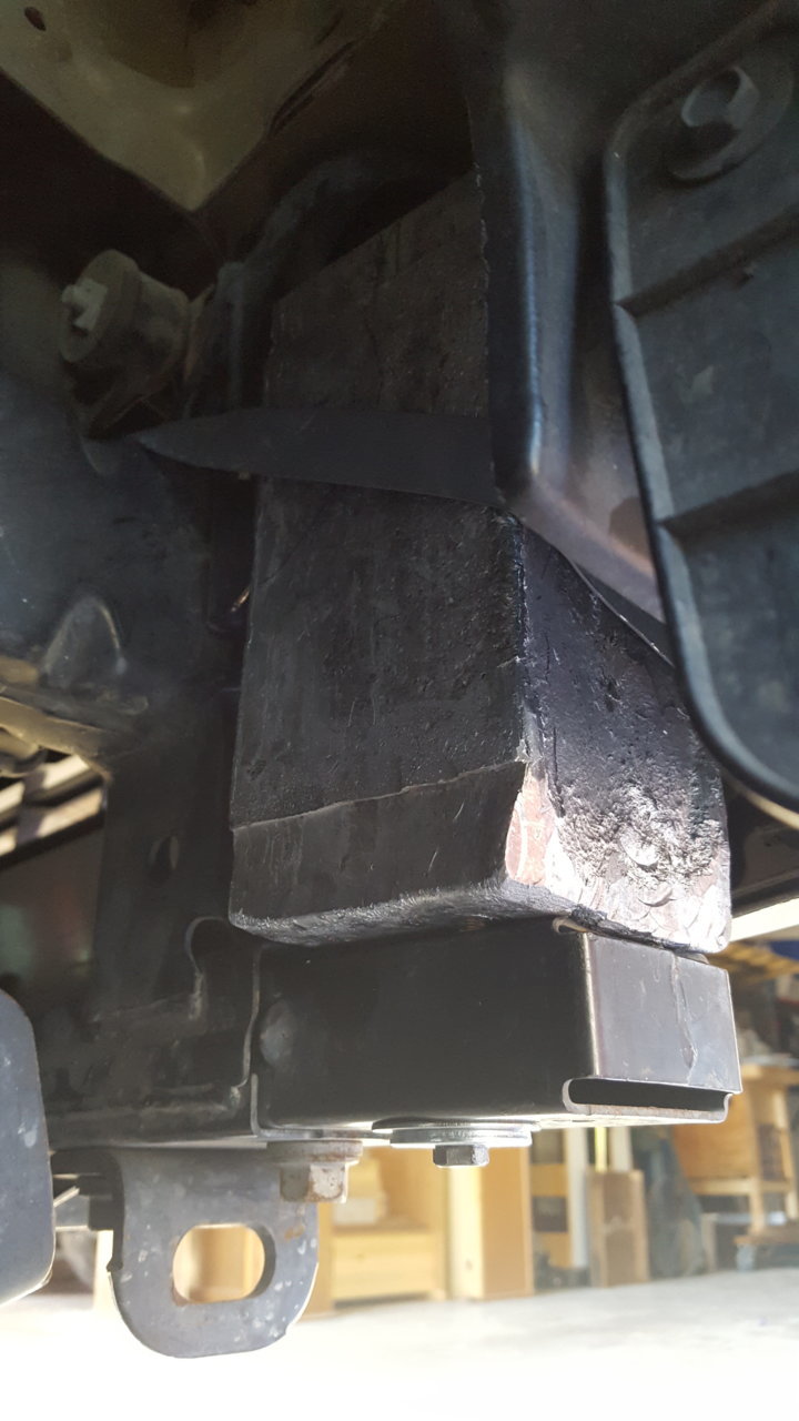

    I consider the counterweight idea to be a complete success. This truck has never had such good road manners, and it rides better too.
    That's because I'm not pumping the airbags on an empty truck, to get weight transfer to the right front end.
    I cast up a 40lb ingot of old wheel weights & it sits vertical, about 3.5"x3.5" and 7" tall.
    (After trimming, it was 35 lbs net wt.)
    Then I slit it & trimmed it to lock onto the stamped frame bracket under the left front body mount.
    It also slots around the body mount bolt
    I made up a long steel strap, like a hose clamp, and strapped it to the frame.
    It sits on the front radiator crossmember, outside the side rail, and is bolted thru the crossmember from below.
    It should have two bolts up from the crossmember, but right now it has one bolt and one broken drill bit. :annoyed:
    I'll have to take the block out and heat that bit to remove it. but it's plenty secure for a test run. I bounced it around on rough pavement and gutters, then tightened the bolts, then did it twice more, and it seated in tighter to the frame each time.
    I'll take a photo when I take it back out for final fitting and paint.

    This is the only photo of it installed so far, and I'm looking from the tire toward the front of the inner fender.

    Today I replaced that 1/4" bolt with a 5/16" bolt, and replaced the broken drill bit with a 3/8" bolt. I also trimmed things up so it fits really tight to the frame.
