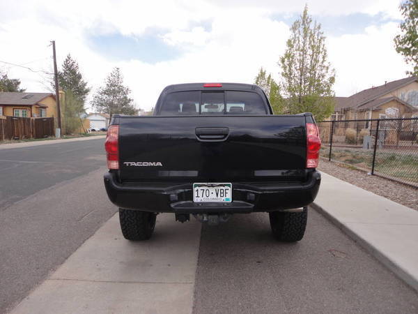

    I have a 3" lift on my truck with non tsb leafs and 2" toytec add a leaf. It seems like there is a slight lean to the driver side. Would a new stronger leaf pack fix the taco lean from the rear? If so which leaf packs would you recommend?

    Are your CO"s adjustable? If so you can adjust the CO's a bit to eliminate the taco lean. I think I still have taco lean on my truck even after adjusting the CO's because of the gas tank.

    I have adjusted them but it seems to only help the front. The rear is what bothers me a little.

    Do you have a picture? I think you still have taco lean because of your gas tank...

    I think it's the gas tank too but would a stronger leaf pack (i.e. ome, all pro, etc) solve the problem?

    I wonder if you could make/buy a 1/4" block, kind of like the 1/4" spacer for the front?

    Alcans from Wheelers correct it.
