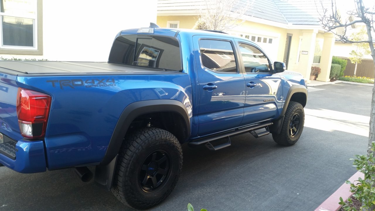

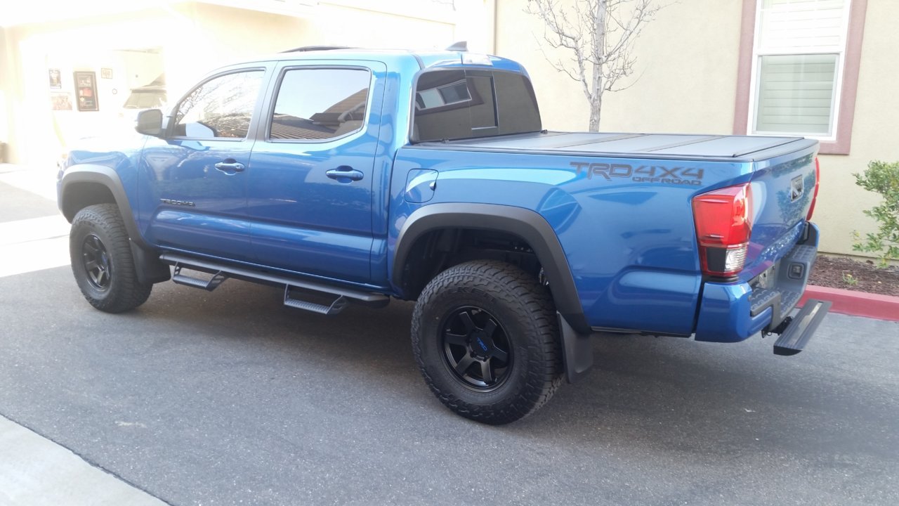

    Anybody knows how to fix the rear taco lean?
    Fronts: I heard you need to add 1/4" spacer to the left side.
    Rear: I have almost 1" lean.
    Will AAL help to being the driver side up?
    How about sumosprings?
    Will it stiffen the ride with the sumosprings?

    Shims. Maybe a the bed is a little torqued? Got any pics?

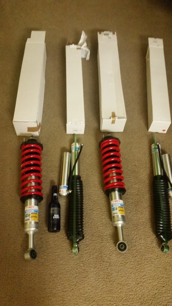

    What are the pics for? Did you just install this kit? Looks like the pro kit that was on sale from the 2nd gens. If so one of the shocks is specifically for the driver side and should help with the lean.

    I don't have any pictures but I measured it.
    Dealers did Not do anything they said the springs are settling in because they are too new...

    Correct... I will install my Pro kits tomorrow.
    I am just trying to get ideas how other tacoma owners fix their lean.

    The different perch positions are supposed to help with the lean. A lot of guys who installed it eliminated the lean but I was unfortunately not the case and installed a spacer to compensate.
    A AAL will not fix any frontal lean and if you have a rear lean then it will accentuate it in the rear.

    I have the same kit with the HS AAL, I added the 1/4” HS spacer on the drivers side. That fixed my slight Taco lean.
    A 1” lean seems like a lot

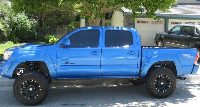

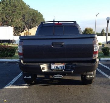

    Are you meaning you are worried about having a "Bro or Cali Lean" after you install this kit? The kit comes with different perch positions to help counter the taco lean.
    Taco Lean (quick google search)
    Bro/Cali Lean with the front higher than the rear
    I have this same kit with the Headstrong AAL in the rear. Left my overload in with the AAL and still have a factory look to my rake (I did not take pre-instal measurements).
