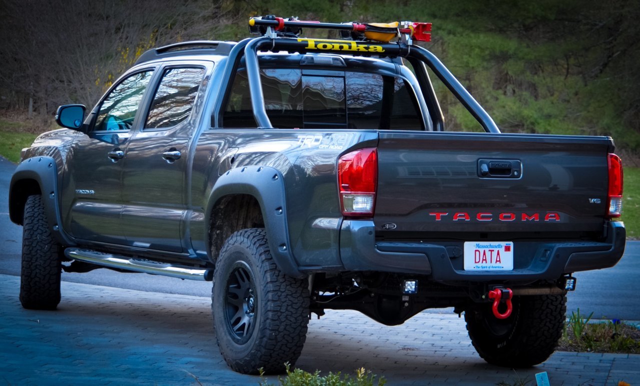

    I installed an adjustable lift and fine tuned the lean out. Left front is 7/32nds longer (higher) to adjust for it, rear is level with new kit and shims.FD811067-B281-434E-BB95-B1EC8B74FFD4.jpg
