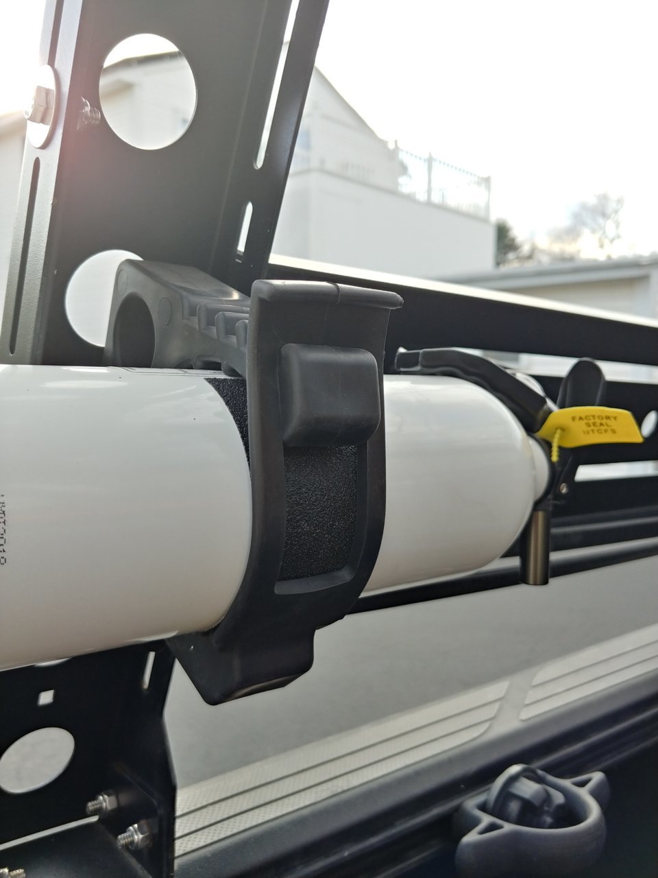

    Quickfist hack:
    Got something that doesn’t quite fit in a quick fist just perfectly? Or something like a fire extinguisher that manages to work its way loose after a day on the dirt roads? A little bit of 3M grip tape makes a world of difference.

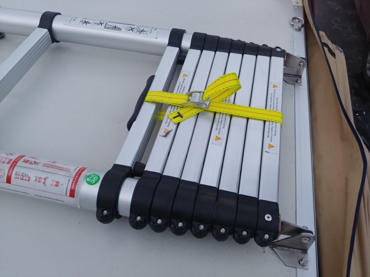

    RTT ladder strap:
    The velcro straps that hold a lot of the telescoping style RTT ladders seem to fail fairly often. A super cheap strap, again from Harbor Freight, is a simple fix. A few screws to remove the plastic piece and the old strap. Cut the new one to length, position it so the buckle is in a good spot and doesn't interfere or rub, then lock it in with the screws.

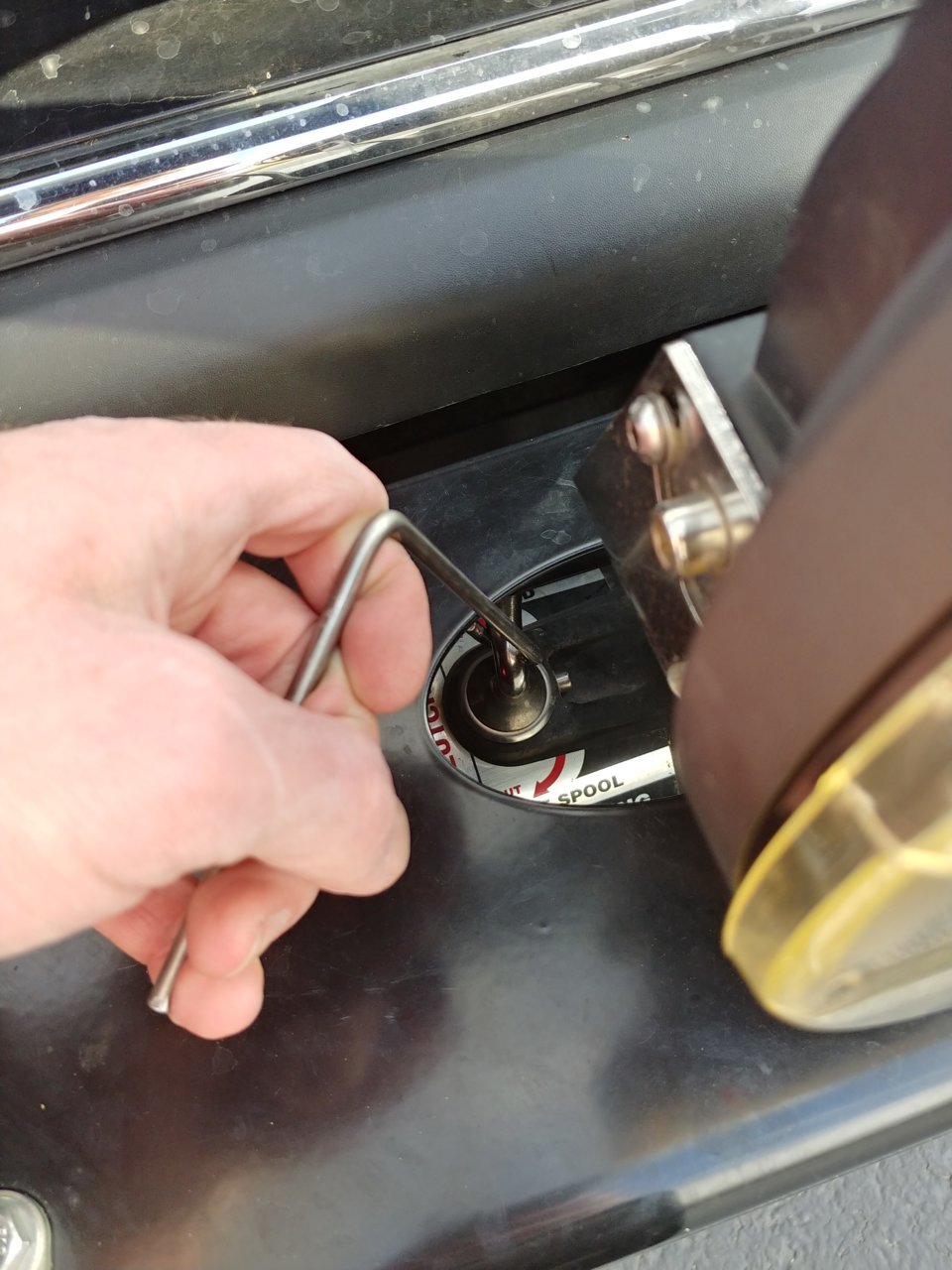

    Winch clutch lever:
    Clutch lever on your winch hard to get to? (I'm looking at you ARB.) A piece of scrap metal and a few minutes make a perfect tool to get in those tighter spots. I mocked it up with some 1/8" scrap, but ended up using 3/16" rod. The 1/8" wasn't quite enough. Perfect size to fit in the center console with the winch controller until its needed.

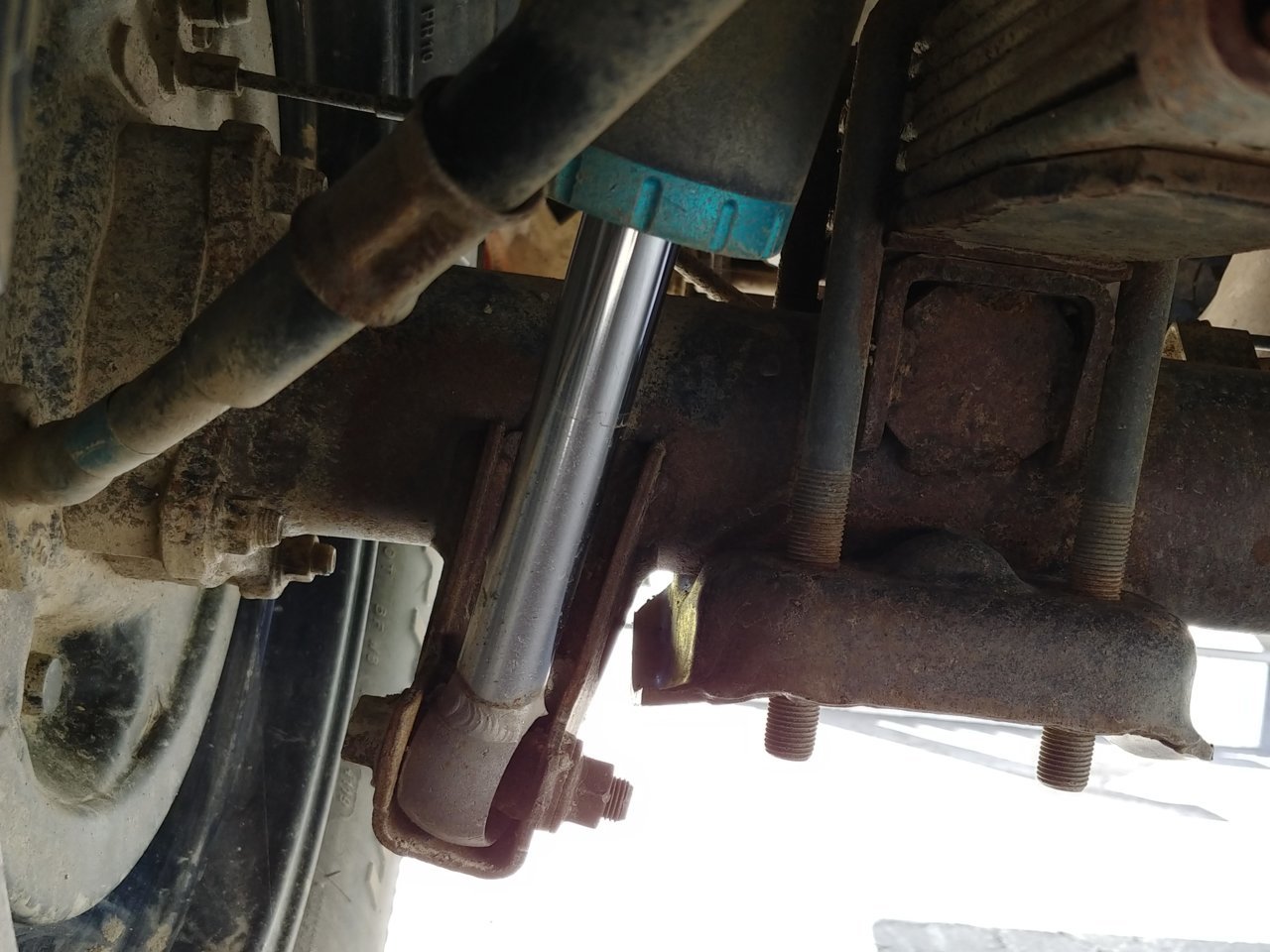

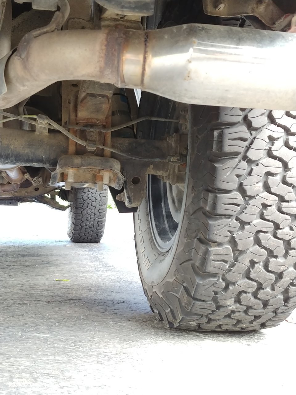

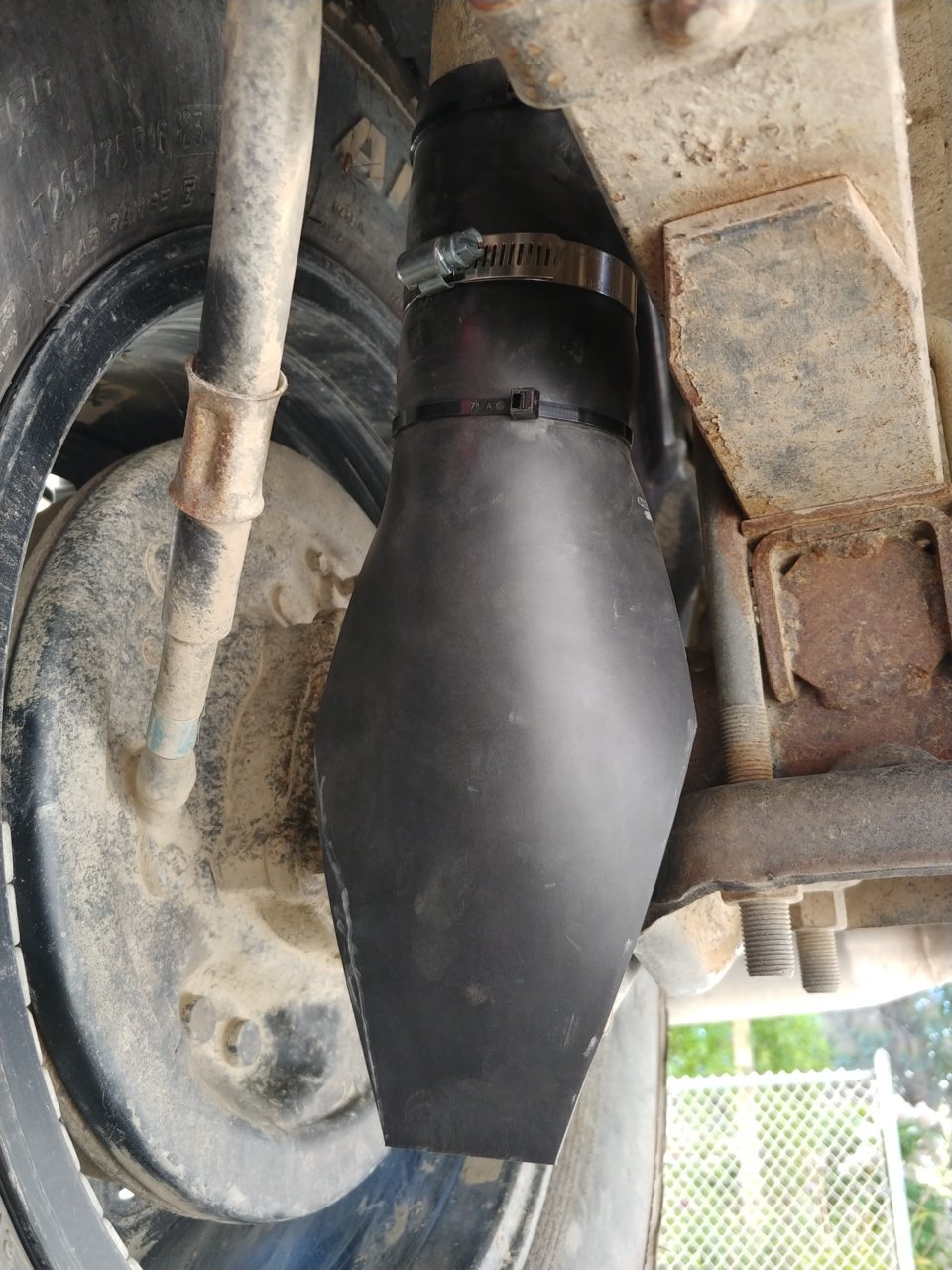

    Quick and easy rock deflectors for the rear passenger side shock.
    Grab some 1/8" rubber sheet from McMaster or wherever, cut to fit and install. Way better than the boot / bellows style shock guards that trap water and mud and everything else in them.
    No issues so far on the highway and I dont anticipate any issues offroad because the rubber is soft enough to move around as the suspension compresses.
    https://www.mcmaster.com/1861T24/
    Less than a year - maybe a few thousand miles of dirt, at the most, without anything:
