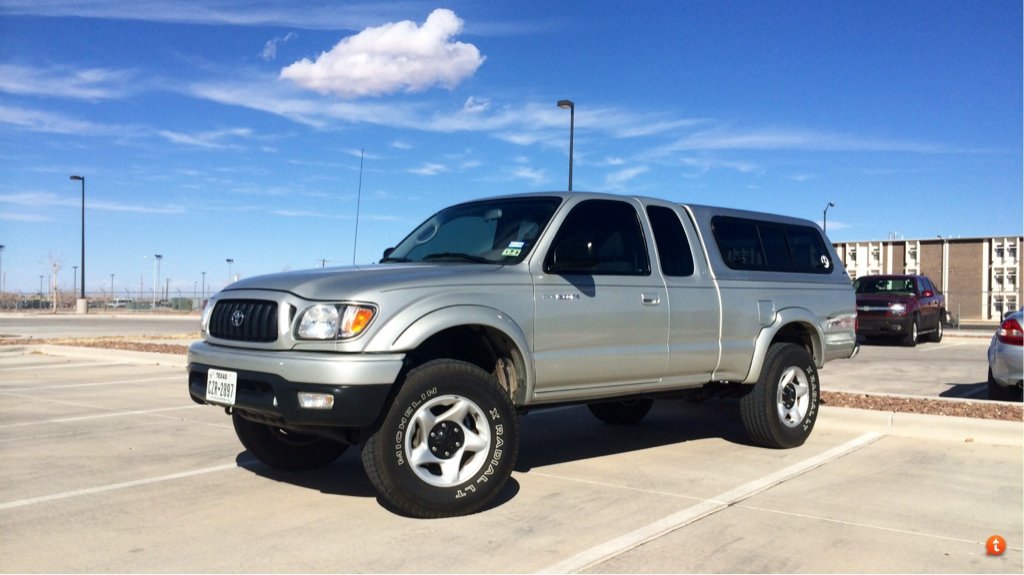

    In July I'll be putting my '03 Taco in long term storage (3 years). The place I'm storing it does a monthly start up and move around so the tires don't get flat spots. They're only going to let me have 1/4 tank of gas when it goes in.
    Outside of fresh oil and some fuel stabilizer, does anyone have recommendations on what to do to prep the truck before hand?
    On the plus side, in 2017, when it comes out of the time capsule, it'll be 14 yrs old with only 80k miles on it.
