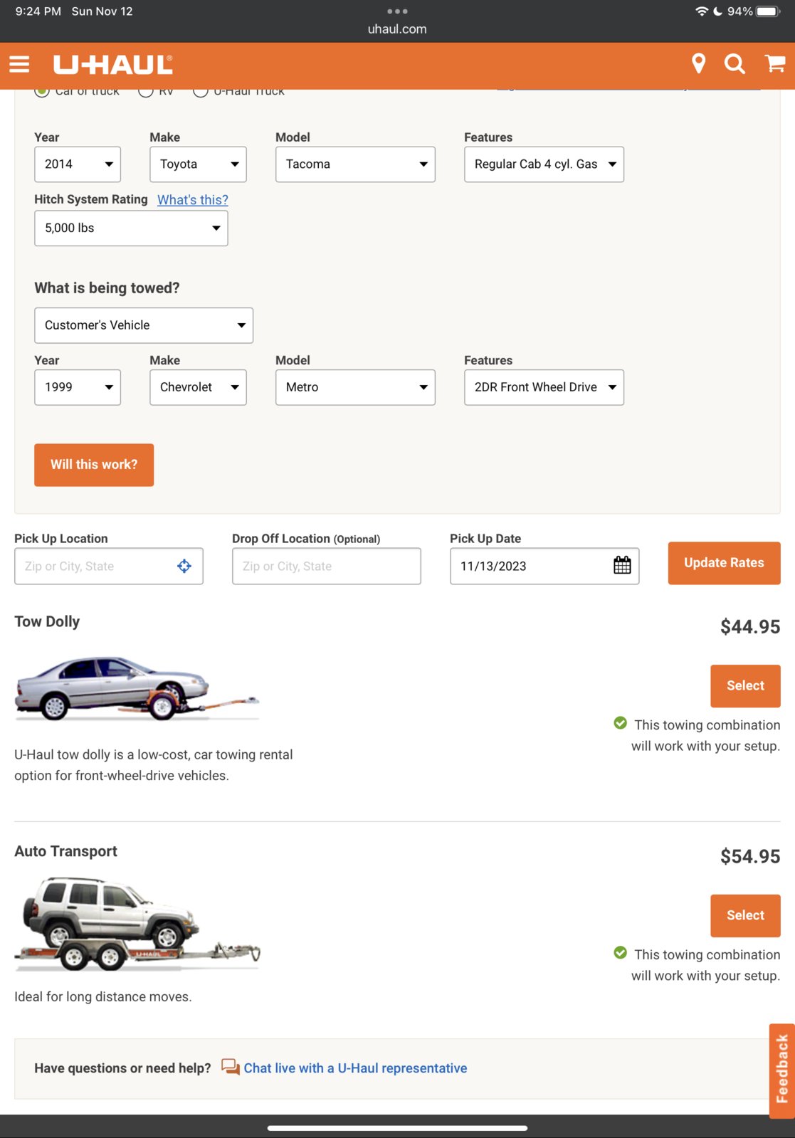

    Both.

    Weird! WTF? :rofl:

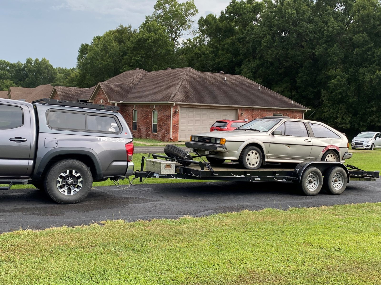

    Realistically, 4,000 is about the limit for me. Sure, it'll pull it. It will not stop it very effectively without a brake controller. Don't get me wrong, I've been very happy with my Tacoma. But there are some things that a full size truck will do better.
    This is approx. 4,200 lbs. 2,000 for the trailer, 2,200 for the car.
