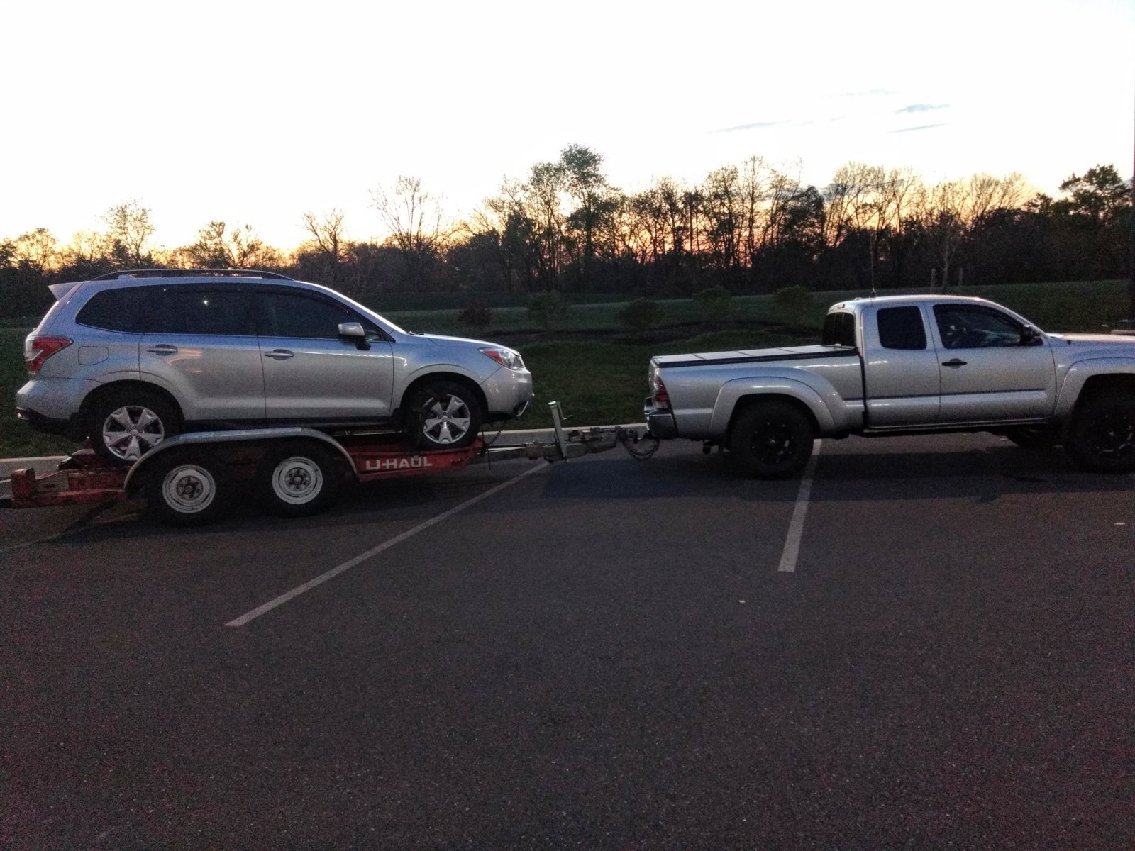

    I'll play did this 3 years ago taking wife to CT. because her mother passed away, and I had to leave her there.
    This picture is before I lifted and put a leaf pack in the rear.
    Took it easy and in 4th gear from WNC to CT. something over 800 miles 1 way about 6000lbs.
    Can be done.
    Edit: after reading I see it is a 2WD and that is the difference. I have tow package and 4WD. And very experienced in towing and stopping in mountainous roads.

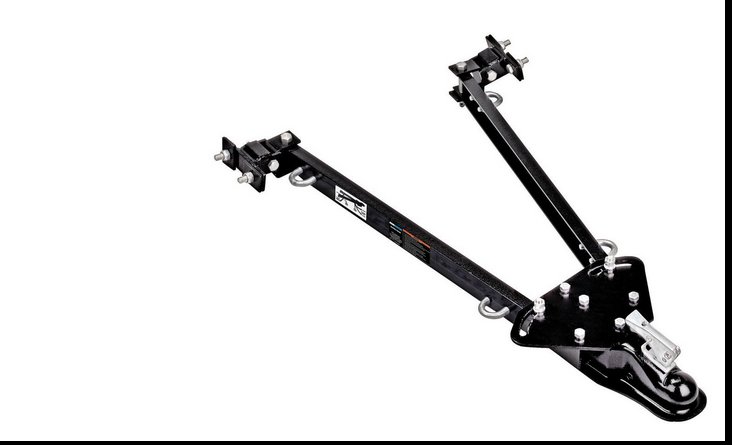

    Is that a tow bar to add to the front of the towed vehicle?! Just don’t do that. You won’t have brakes in the towed vehicle to help stop you and most vehicles can be damaged flat towing like that. You best option remains renting a Uhaul pickup and car trailer.

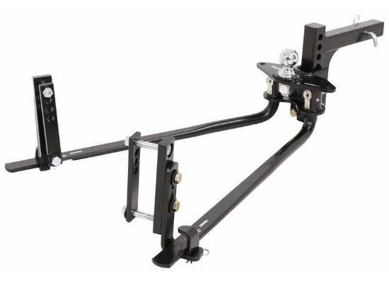

    Did you mean to post a pic of a weight distribution hitch? The thing you posted was actually some weird bolt on trailer tongue.
    And as someone else noted, your curb weight is that of the CRV, the trailer alone is another 2210 pounds per Uhaul. And an FYI, no way to mount a distribution hitch to a uhaul trailer.

    I was going to mount the Y bar hitch thing use it instead of U haul dolly or trailer. Now i just realized that i forgot about you're not supposed to tow an auto transmission in neutral though. So i guess if I am towing the automatic i have to have a dolly or and drive on top of trailer then ?

    I guess you could take out the driveshaft. That would (I presume the tow bar doesn't weigh 374#) keep you below your 3500 max. Pain in the ass, but doable. That's not speaking to all the down sides of using a tow-bar in the first place....I don't like em, some do, to each their own. Too many axles on the ground for my liking.
    EDIT: Too many steer axles on the ground for my liking.

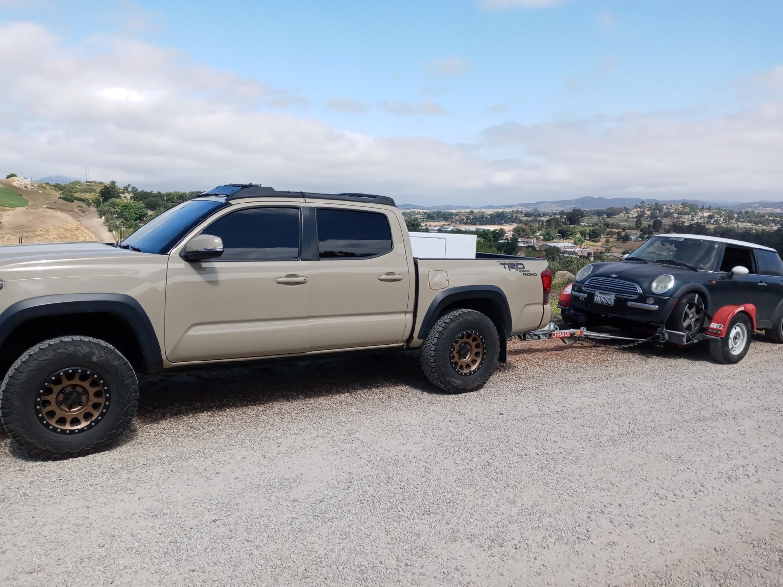

    I've done tow dolly and trailers with no issues at all, I also removed my front anti swaybar.

    Me too. I wouldn't hesitate to use a dolly, or even a full trailer. Beats the hell out of removing the D/S, in my opinion. I'd pull it on a trailer (in 4th gear) and wouldn't give it another thought. Get a trailer with brakes and even with them, still leave yourself extra stopping distance, but for ME (YMMV), it wouldn't bother me to pull over 3500 on a proper (for a vehicle) trailer.
    BTW, if you load the trailer correctly, you can pull more than 3500...that's the tongue weight. Not all the weight is on the tongue.

    The CRV came in either front wheel drive or awd models. Flat towing would require pulling the axles (and rear driveshaft on awd model). Kind of silly. If the tow dolly has trailer brakes, you could use one and pull the rear drive shaft if it’s an awd model. Tacoma brakes would be working double time to try to stop both the truck and the towed vehicle on one thing without trailer brakes.

    Yes i was considering using the tow bar because theyre fairly cheap and i can reuse it. Issue is though that the vehicle im trying to tow is an automatic. So unless i remove the driveshafts up front I am not sure how else to use the tow bar (flat tow device).
    Ive really only got about 5 miles to tow it so i wonder how bad it would actually hurt the auto transmission though i know it cannot do it any good.
