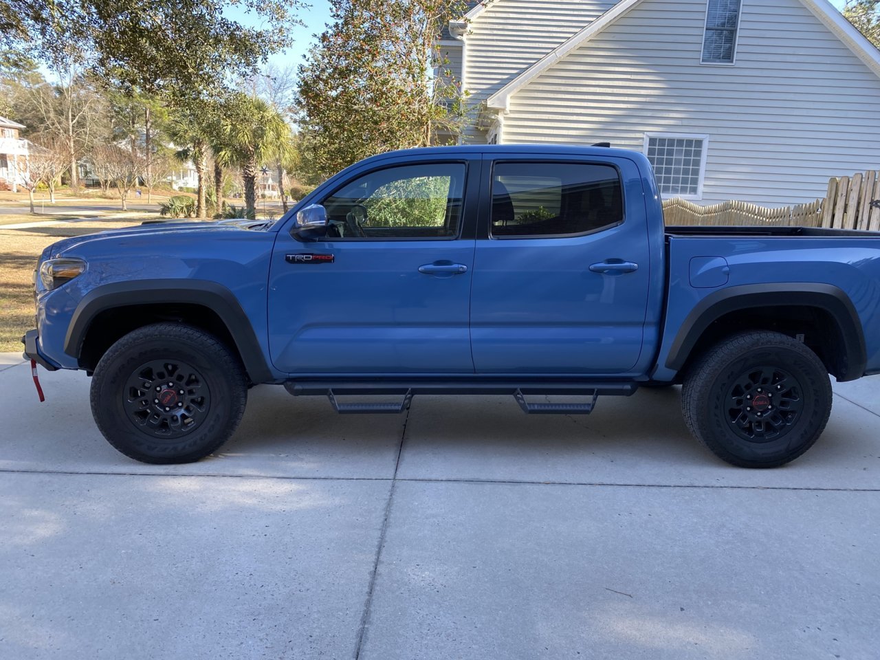

    This is an after pic. you can see the bumper and winch strap on the front. From ground to center of the fender flare is 1.5" lower in the front as compared to the back. Not super noticeable which is good. I'll have to see if I can find any good before pics, but unfortunately I didn't take a lot of pics before the new bumper.
