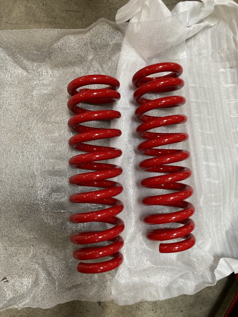

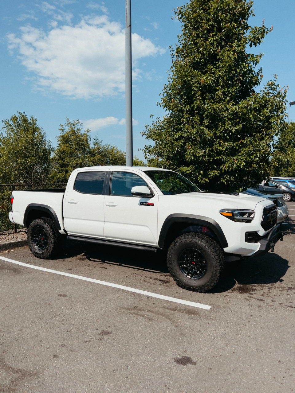

    I have my fox/Eibach’s off now (replaced with Ironman - powdercoated red), so I could send them in for review.

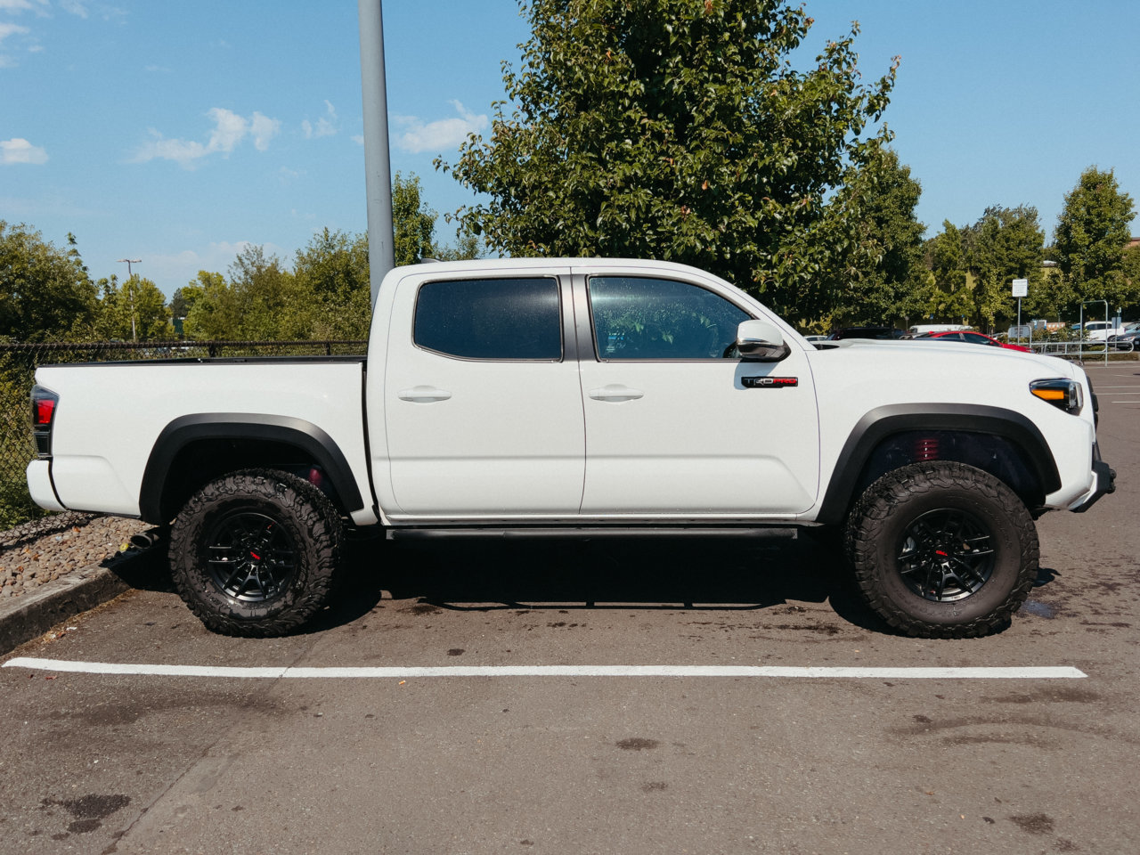

    Just wanted to add to this thread for the 2019 and older folks. I installed 2019 fox pro takeoffs with this eibach kit on my 2019 sport and got roughly 1.25” lift in the rear and 2.25” front left and 2.0” front right leveling out the Taco lean. Sits about level with no rake and Firestone aligned it to factory specs. Took about 5 hours to do myself in my driveway except after removing the oem springs with an autozone spring compressor tool I paid a shop $50 to install the new eibach springs on the coilovers cause it was a pain trying to do it at home. Haven’t put much miles on it yet but so far it seems to ride slightly rougher on pavement than my sport suspension which isn’t surprising but I’m sure the ride will be alot better off-road.

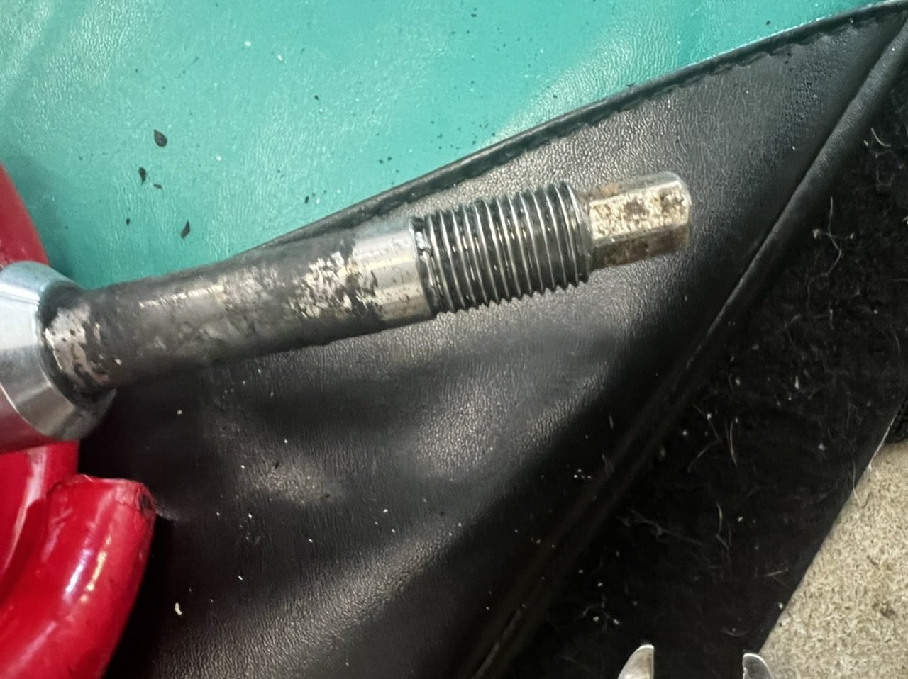

    2C34C883-137B-4582-AFA5-616622FBA150.jpg 85DADA5F-684F-4854-B2AC-32F6C01C86C5.jpg
    EDIT:

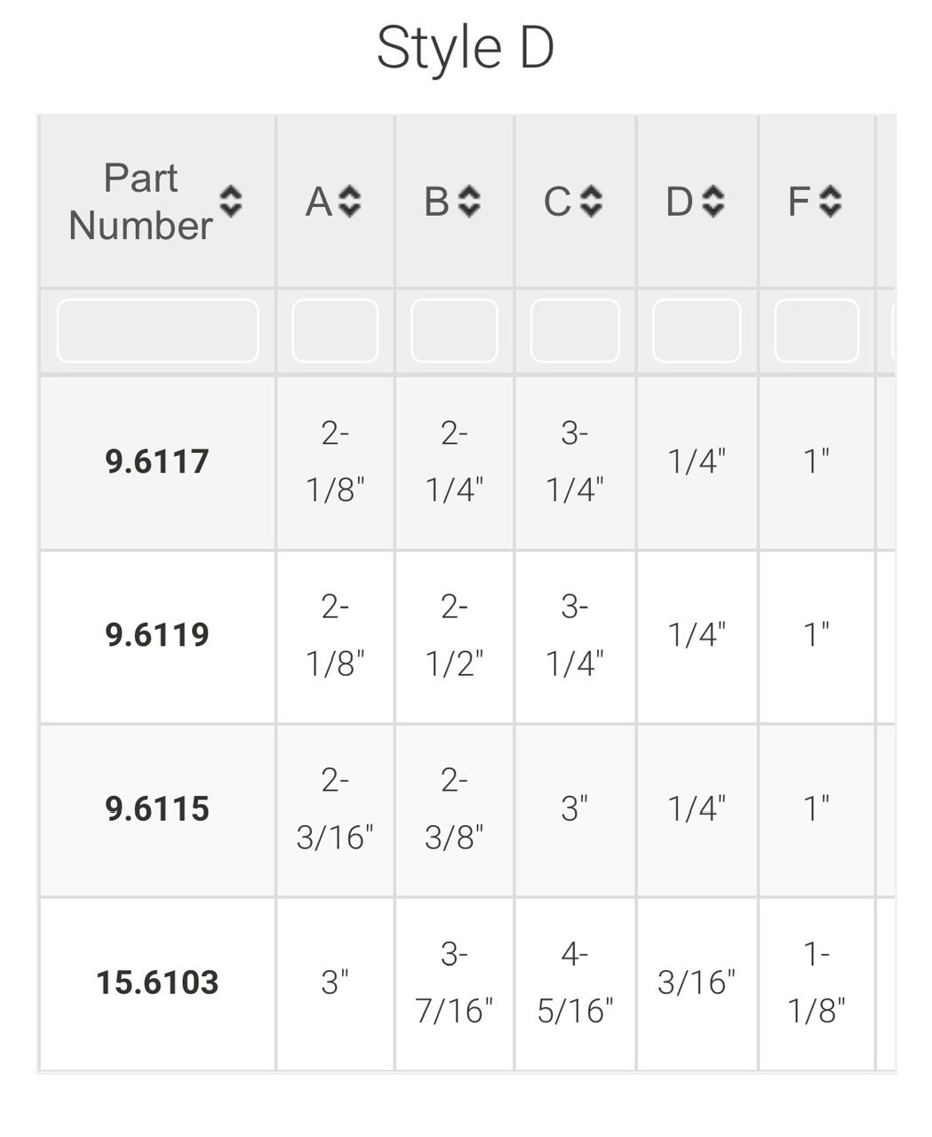

    so based off ES website, “B” and “C” would be the most important measurements? Since the inner tab would sit inside the spring. They are only 12-15 dollars each so I might just order both 9.1165 and 15.6103 and see what works, I don’t really have the time to I’m lit, measure, bolt, wait, then unbolt everything again.
    How do you like them compared to your previous Fox/ eibach set up. Contemplating these or going full on Fox 2.5 resi

    Only have 5 miles on them so far. They don’t feel as “floaty” on the freeway, which I like. Otherwise, I haven’t noticed a significant difference so far. What the mechanic noticed is that they are actually level with the rears now…

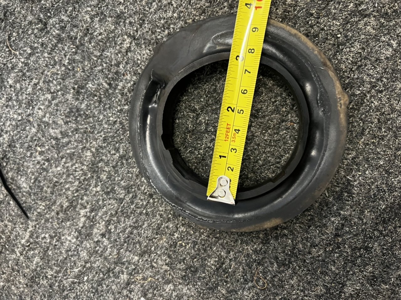

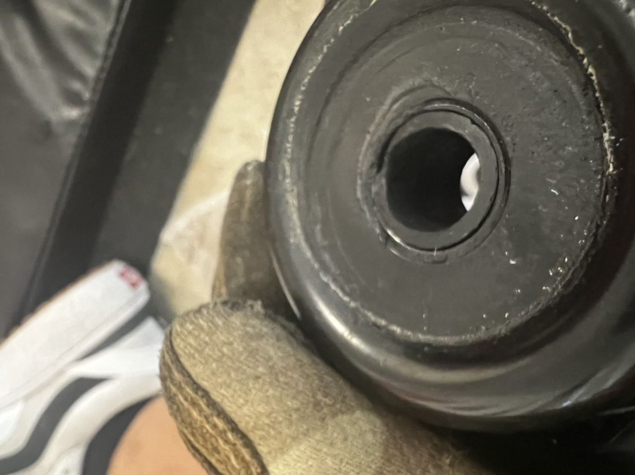

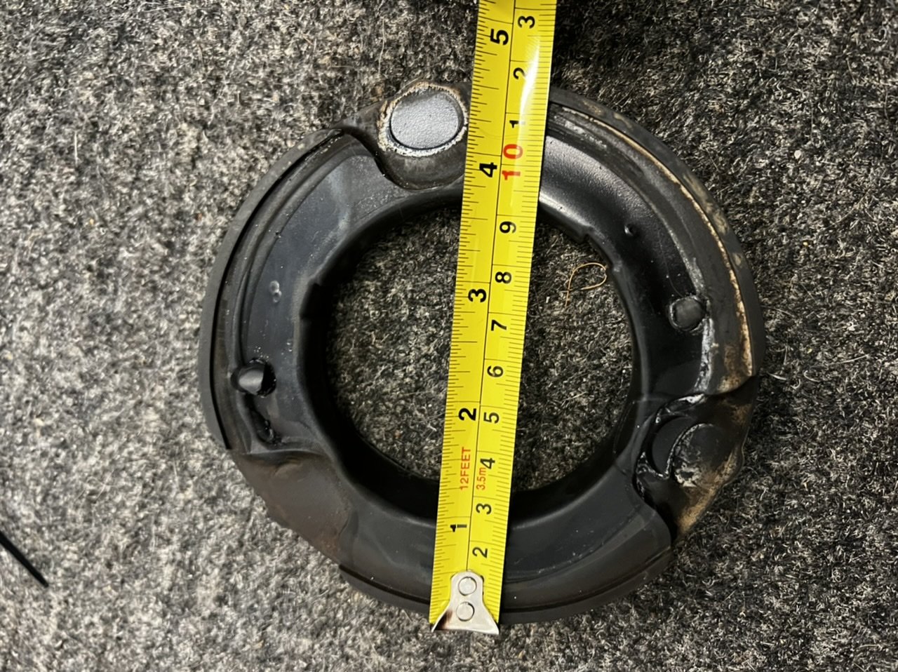

    My top hat bushings and dampening rods. The squeak is definitely coming from uneven pressure on the top hat and bushing.
    After putting things all together, with weight on the shocks, the top hat straightened out. I even removed the top nut and reset the top bushing to make sure things were evened up. But still got the excessive wear. New top hats are “cheap” but I’ve had things springs in for under 500 miles.
    I’ve also included measurements of the existing isolators. Doesn’t look like ES has a matching stepped one to fit.
