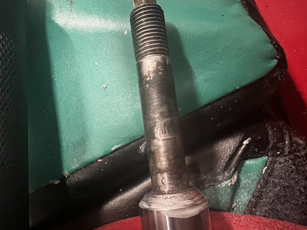

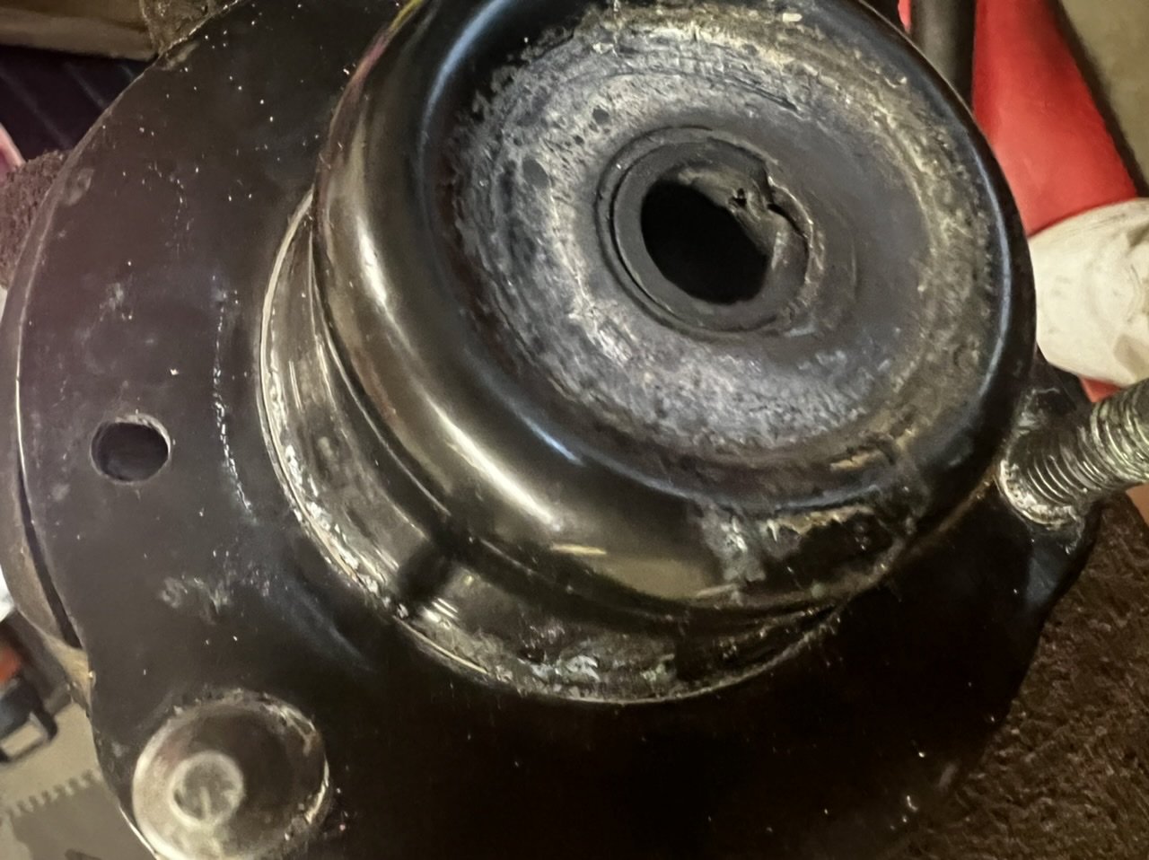

    I greased everything when I installed the springs and a pair of AAL. To be fair, I am battling a AAL squeak as well, but that squeak is very easily identified coming from a particular spot.
    I greased all the bushings and other parts when I put the springs in my shocks. When the squeak first started, it really only did it when I rocked the truck side to side and when I was going over bumped at a lower speed. But when it got worse, the noise was clearly coming from some where on the top of the shock. It would make the noise just driving down the road slowly. It didn’t necessarily rule out the UCAs making the noise, but when I took the shock out and took a look at the top hat, it was very clear what was going on.

    Yup. I’d be very careful. There’s a squeak when the dampening rod wears on bushing on the inside of that top hat.
    And then there’s the squeak when that bushing is toast and it’s metal on metal and the inner hole on the top hat gets bored out by the dampening rod.
    EDIT: happened to me3B7C2A0E-B545-493A-BDE1-A3CB6C5E8B79.jpg33878AEB-8ECB-4B33-83AA-489284A5013E.jpg

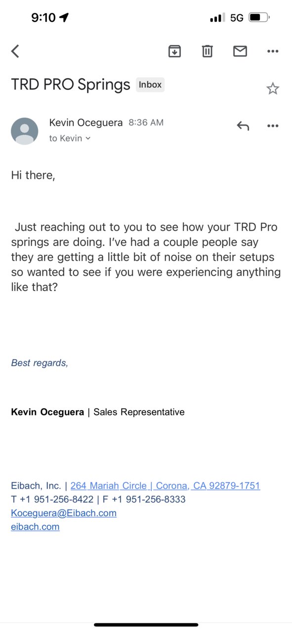

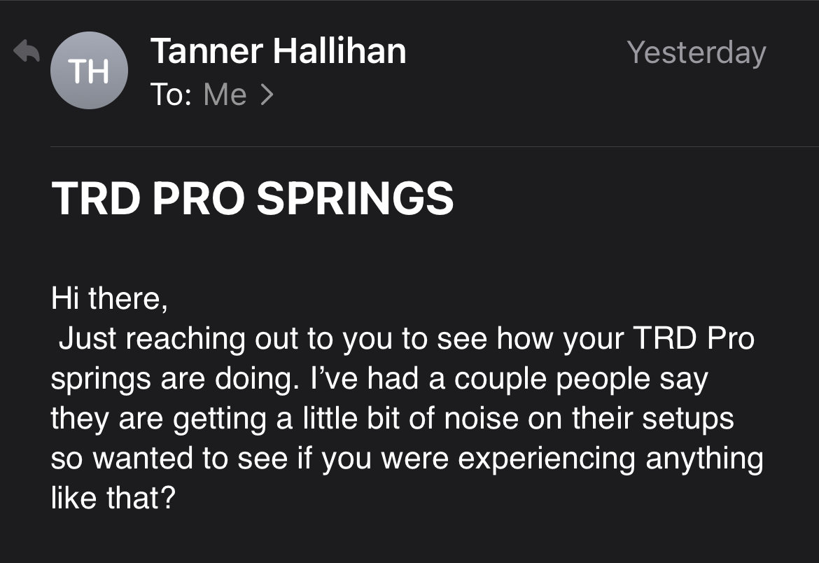

    I’d say a little understated…also seems they aren’t doing a great job of tracking who’s complained already.

    Yah, yah, they took care of me already, and with the quickness. The email just got under my skin.
