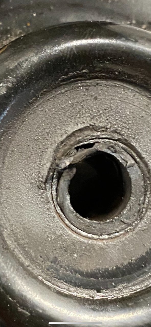

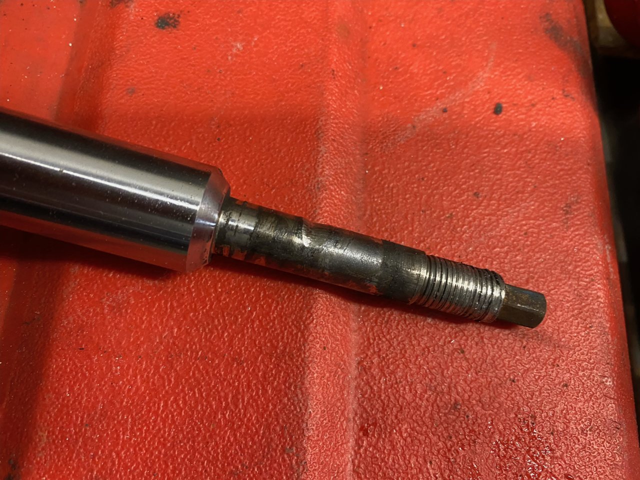

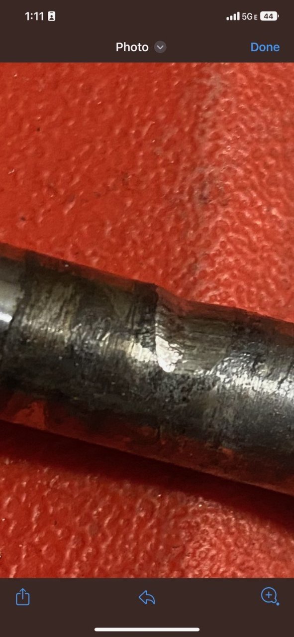

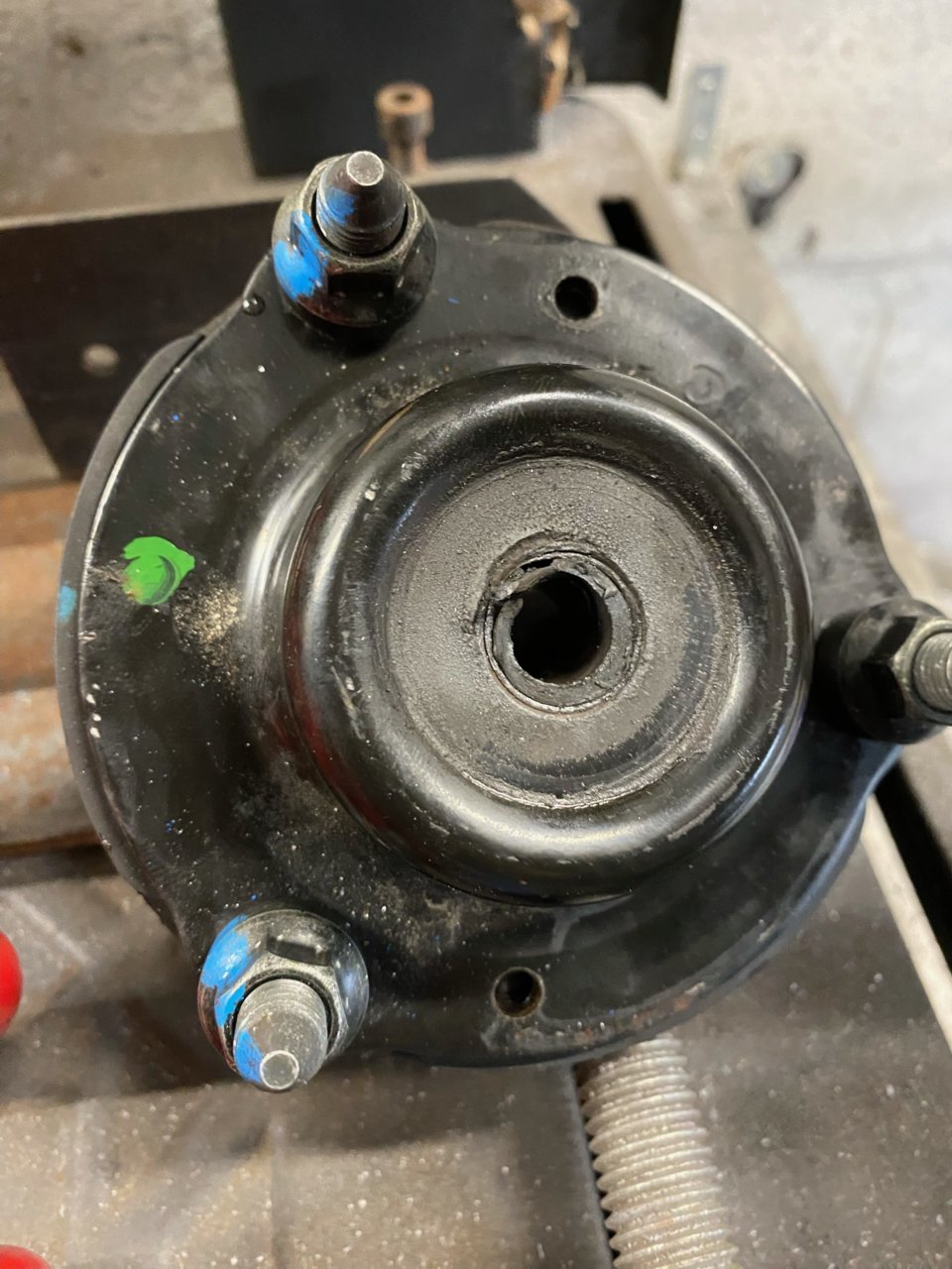

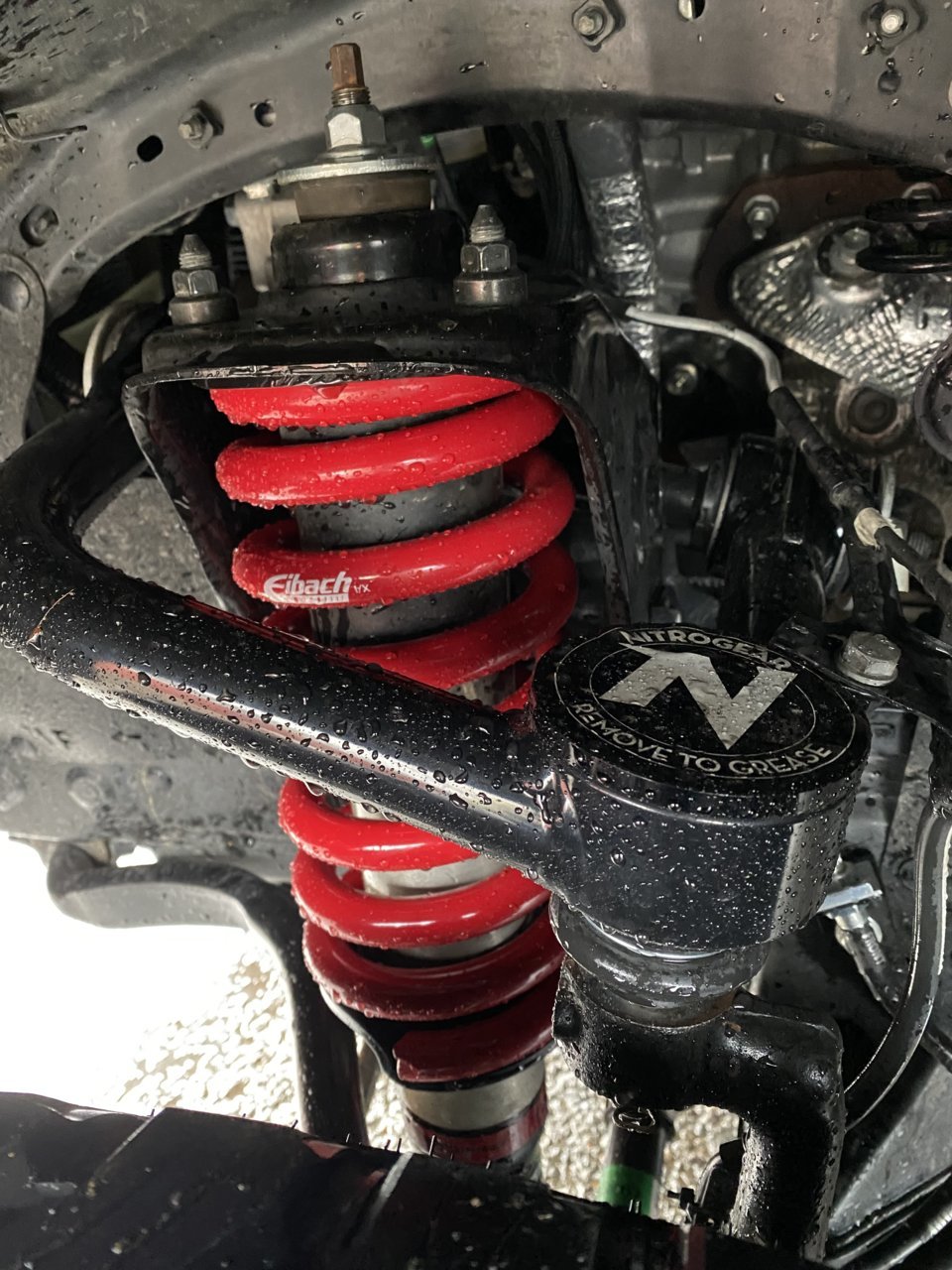

    I have my truck at the shop today to put on the replacement Eibach Springs. Progress now halted because it looks like I have enough damage to the shock shaft/threads that they are recommending I DO NOT reuse them. New shocks are not available for 2 weeks and cost $1100 each.
    The initial set of Eibach springs put the shock shafts at an off-angle and wore the inner bushings away, which lead to wearing down of the metal. This contact was producing the squeaking noise I've been living with since putting them on back in the Summer.
    The shop is attempting to rethread the shocks and put it back together for the time being. Whether it is safe to drive in that fashion is a serious concern of mine.
    Seriously concerned about taking new shocks and putting the new Eibach Spring on them given this experience so far.
    Anyone have the new springs put on yet?
    How is it sounding? Riding? Working?
    Already in contact with Tanner but check out the damage:

  9. Dec 15, 2022 at 12:41 PM
    #2129
    5nahalf
    5nahalf I build dumb things
    Sep 22, 2018
    #267058
    10,919
    Erik
    Minnesota
    2018 Inferno Longbed
    Fox will rebuild them with new shafts for about $400 for the pair. New shafts, seals, oil and nitro charge.

    I had to replace the entire setup with Ironman 4x4 FCP and had their coils powder coated red. I was in a bind because my dealership installed Eibach springs in good faith. After the failure, they would only replace with OEM or ironman, who they have a relationship with (local to my area).

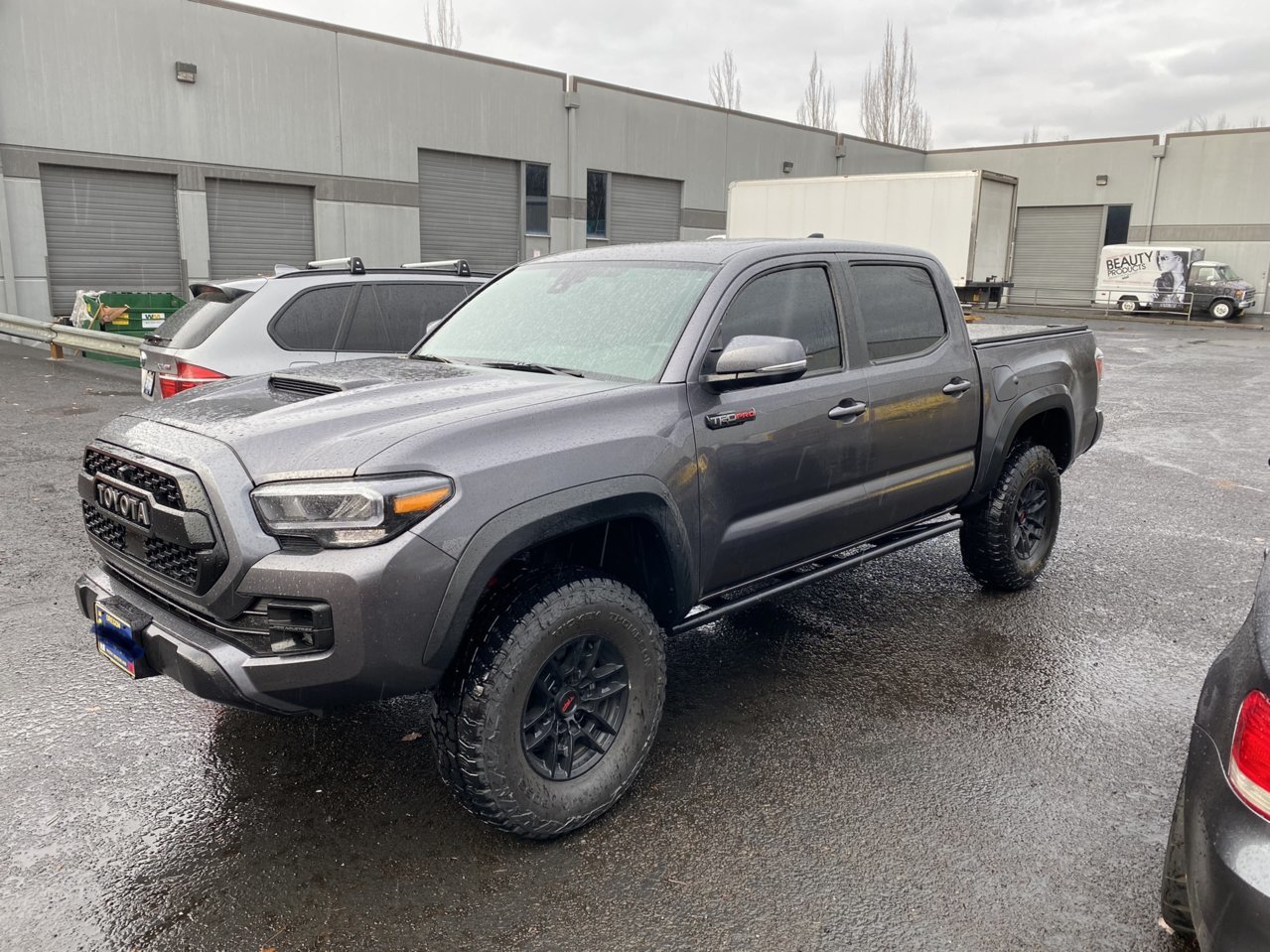

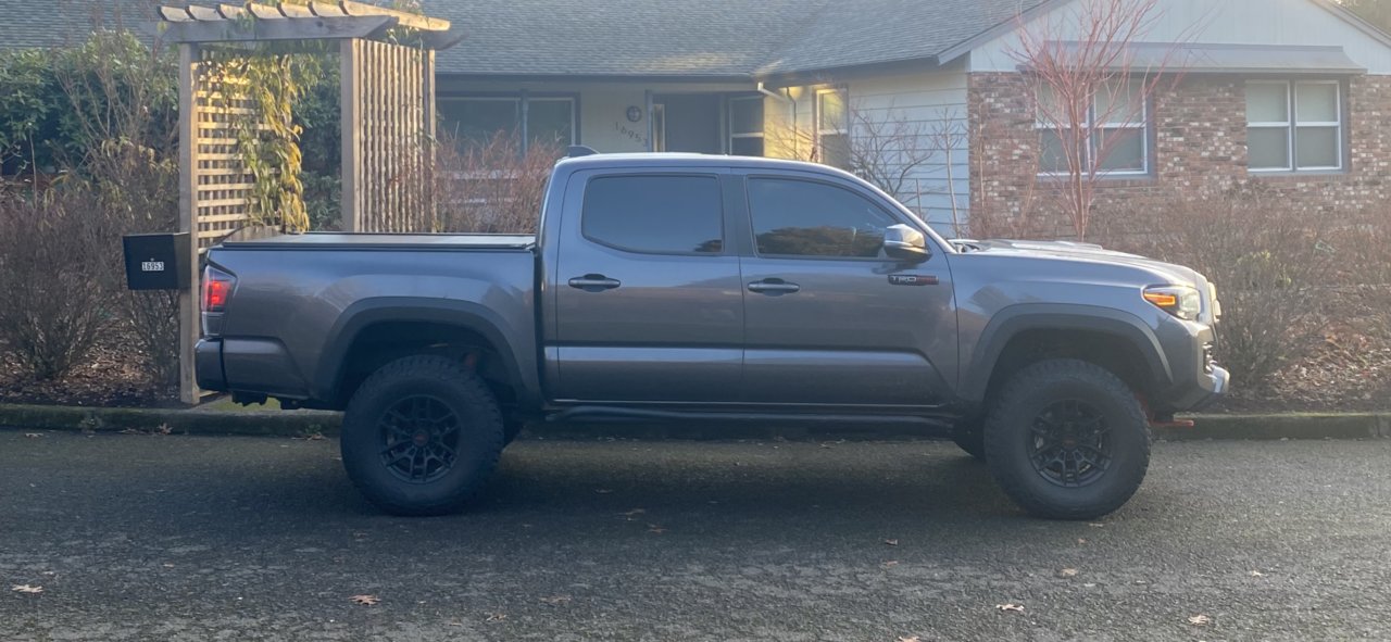

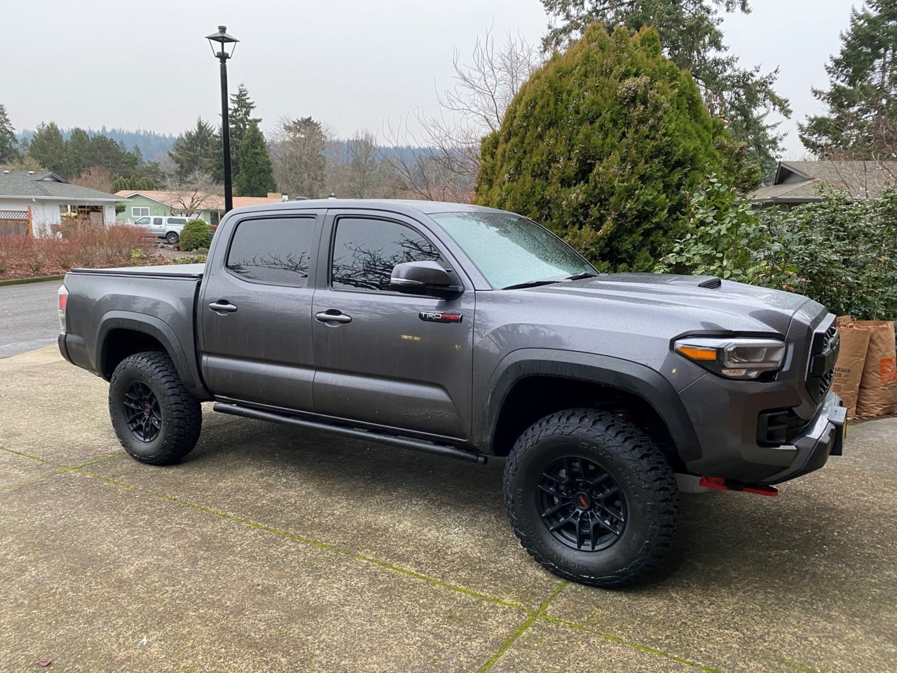

    After 300 miles, I think the ride quality remains unchanged from stock springs. It's actually better now, but that's likely from the UCA and alignment. Unfortunately, my measurements are not apples to apples because I added sliders, aluminum skids (trans/transfer/gas tank), Nitro UCA and ECGS bushing between measurements.
    Hub to Fender measurements with full tank before and after:
    Driver
    Before 21.3" After 22.3" 1" lift gained​
    Passenger
    Before 21.5" After 22.8" 1.3" lift gained (as advertised)​
    I know I know, the pro spring perch is supposed to account for the lean, but mine has always been .25" difference side to side and is now .50" side to side (assuming from the weight added). Might add a .25" HS Spacer I have laying around so it sits level side to side.
    Here it is with the HS 3AAL and 265/75R16. No doubt it would look better with 285/75R16, but I'm not willing to sacrifice comfort or performance...yet lol. Perfecto!

  14. Dec 20, 2022 at 1:28 PM
    #2134
    rip ej1
    rip ej1 Well-Known Member
    Feb 18, 2022
    #390498
    109
    Daniel
    NorCal
    2020 AG TRD Pro

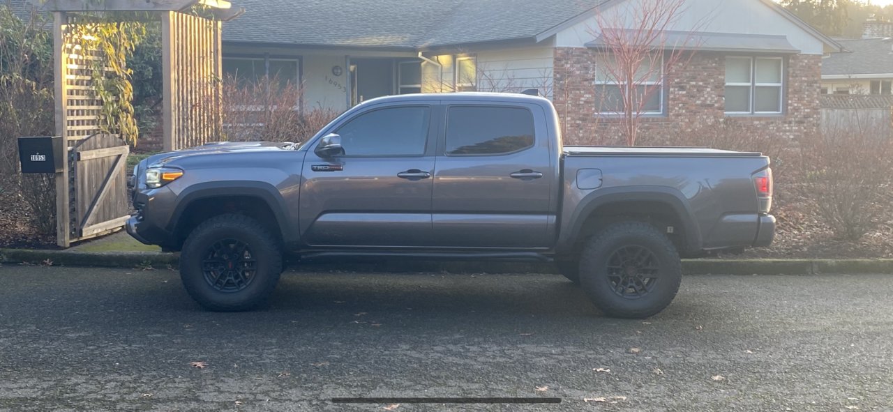

    Thanks for the update. Do you have any straight on side shots? Just trying to see how much rake there is (or isn't). Planning to go with the same leaf pack and eibach's up front.
    TACO TM[QUOTED] likes this.
  15. Dec 21, 2022 at 6:15 PM
    #2135
    TACO TM
    TACO TM Well-Known Member
    Sep 1, 2020
    #339457
    145
    2021 Pro
    The rear sits ~1/2” higher than the front on each side. That’s with ~150 lbs constant in/over the bed + the 100 lbs total for the sliders.
    3TMaverick and rip ej1[QUOTED] like this.

    Thanks! Exactly what I was looking for.
    So pretty.
