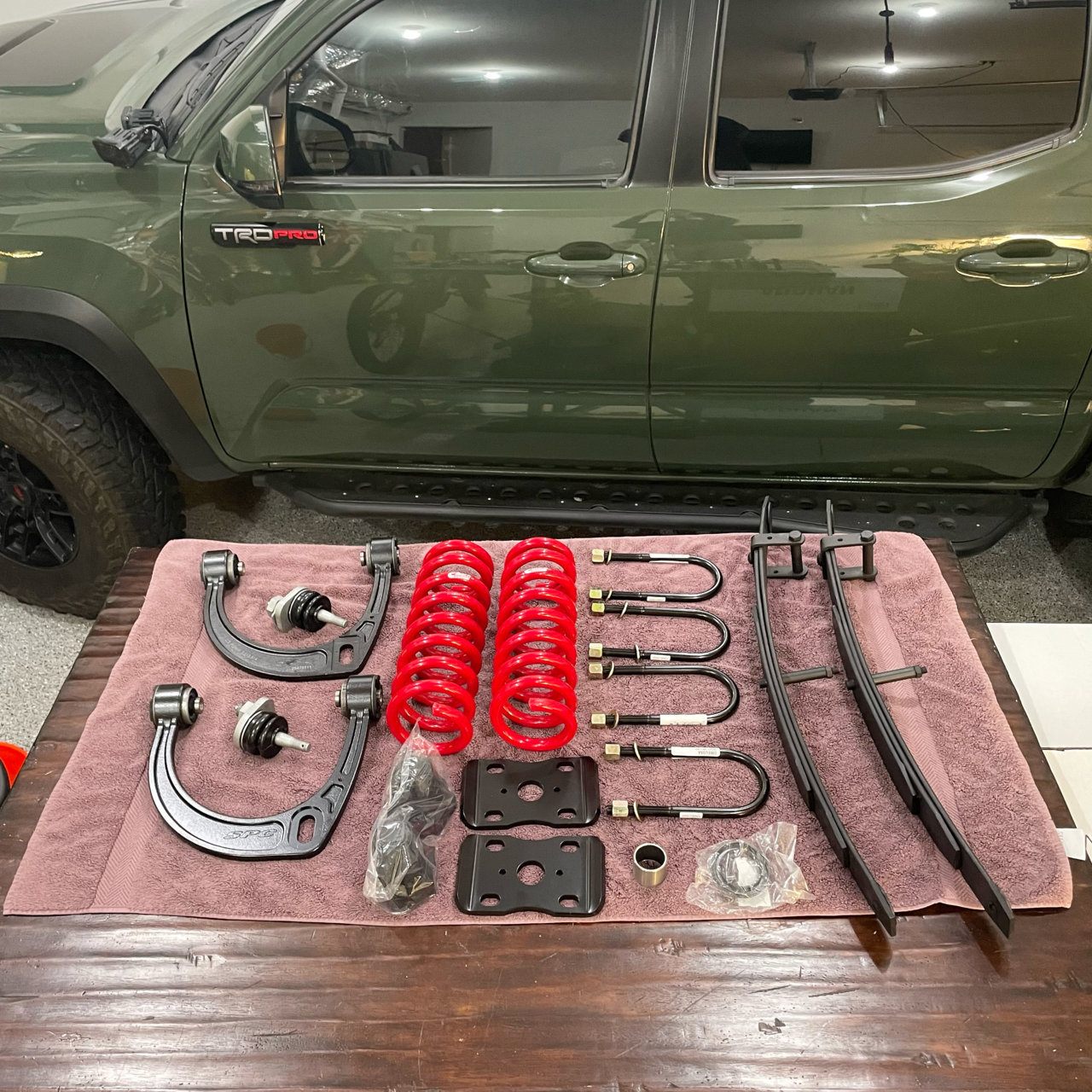

    Trevor
    Portland, OR
    2020 TRD Pro - Army Green
    RIDE Shocks 255/85r16
    Headstrong add-a-leaf
    The other parts are Duro Bump flip kit, ECGS front diff bushing, and SPC upper control arms.

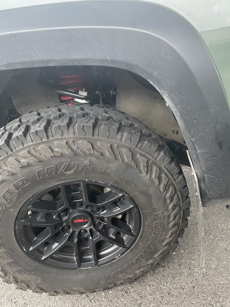

    ~1.8” gained up front with the Eibach springs and a 1/4” top hat spacer to both front struts. 1.5” in the rear using a Headstrong AAL.
    Center of hub to fender measurements with a full tank of gas.
    Front Driver: 20” before, 21.8” after
    Front Passenger: 20.15” before, 22” after
    Rear Driver: 20.5” before, 22” after
    Rear Passenger: 21” before, 22.5” after
    Currently on 33” tires with about 600 pounds of additional weight from skids, bumper, & sliders. Happy with how it sits.

    Thanks for the measurements! Going with the same setup front and rear, just need to order the aal now.
