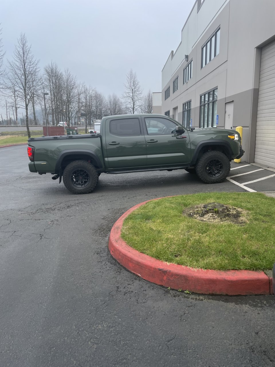

    th3clara
    th3clara Well-Known Member
    Jan 2, 2021
    #351455
    157
    Trevor
    Portland, OR
    2020 TRD Pro - Army Green
    RIDE Shocks 255/85r16
    Not the same spring. Eibach’s aftermarket spring would be slightly taller than the stock spring on a 2022/2023.
    Based on the before and after measurements of other people’s post, I’d say 1.3” of lift is accurate when comparing it to a stock 2020/2021. When compared to a 2022/2023 this spring should yield 0.8” of lift.

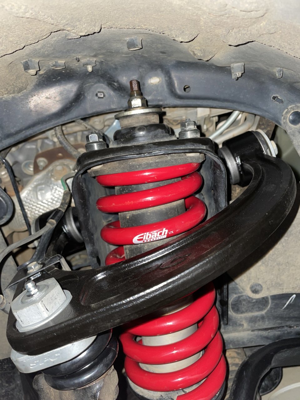

    #2200
    Jazzy
    Jazzy Member
    Nov 4, 2015
    #168628
    16
    Kevin
    South Dakota
    2022 Tacoma TRD Pro Grey
    Modifications underway
    I have a 22 and to be honest got basically no lift with the eibach springs. I'm pretty disappointed. My center of hub to fender is around 21.5" close to where it was before.
    It is nice that they are flat ground on top, I've looked to adding a spacer. But a spacer needs to be super custom to fit so it holds springs and doesn't bottom out on the shock body.
    I found some revtek spacers on eBay cheap and modified them but it is very tight between the shock body and spacer, could still get a collision at bottom I fear. My current wall thickness on spacer where it holds the spring is 2.4 mm and the clearance to shock body is .6mm radially.
    Thinking hard about getting westcott kit and being done with it. I liked the idea of just springs and not messing with the collars. And the spring being flat ground on top so my coils don't sit funny. But they just don't add any real lift on my 22.
    The springs also touch the fancy red control arms slightly at full droop.
