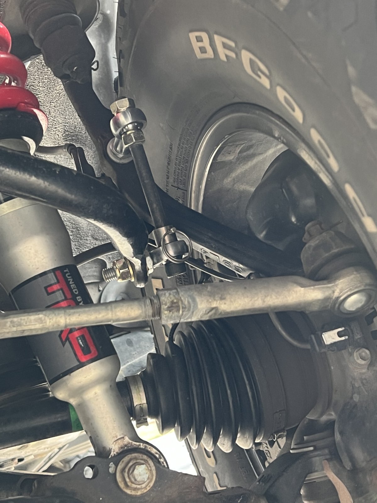

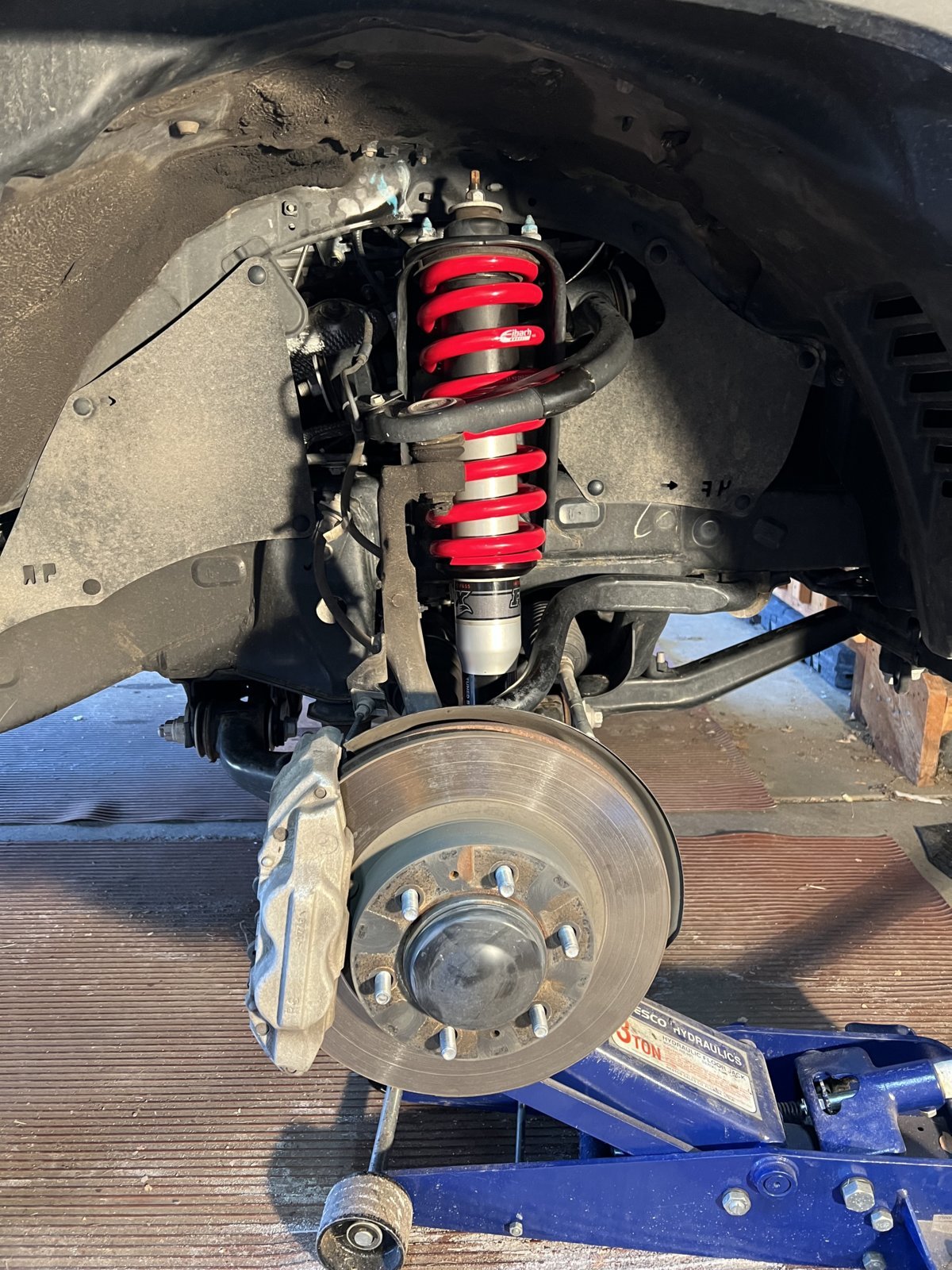

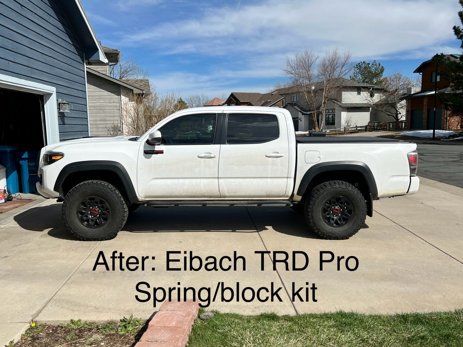

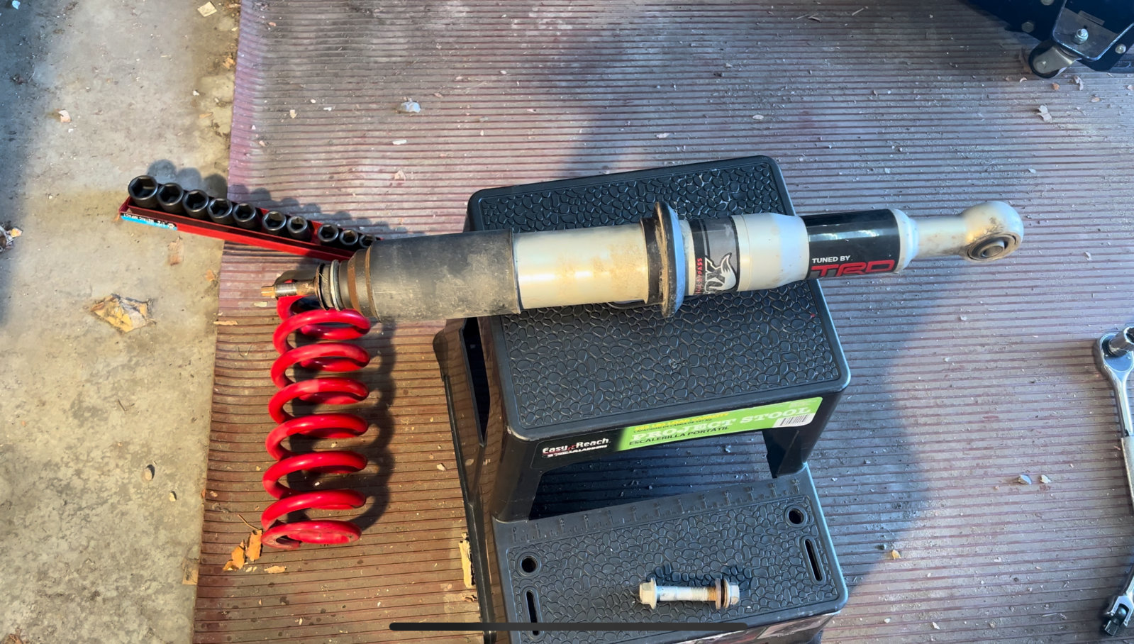

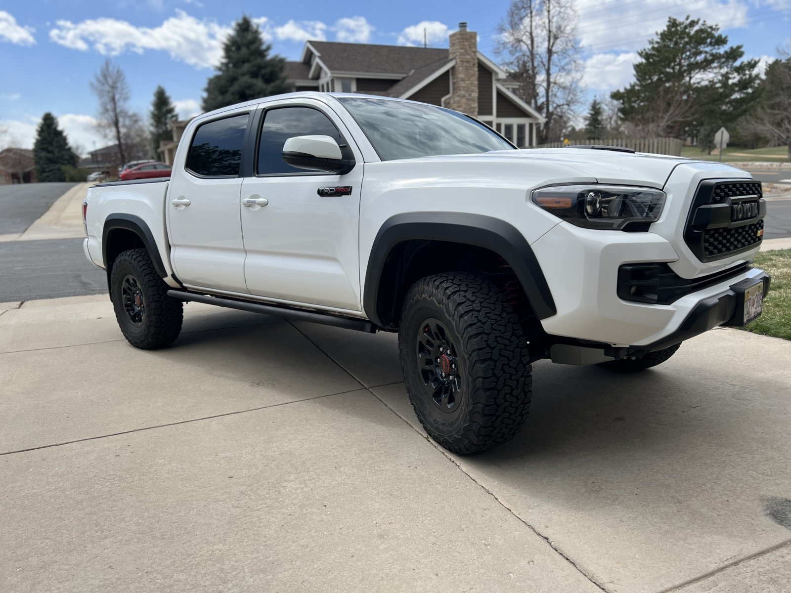

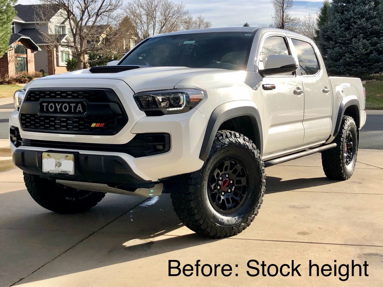

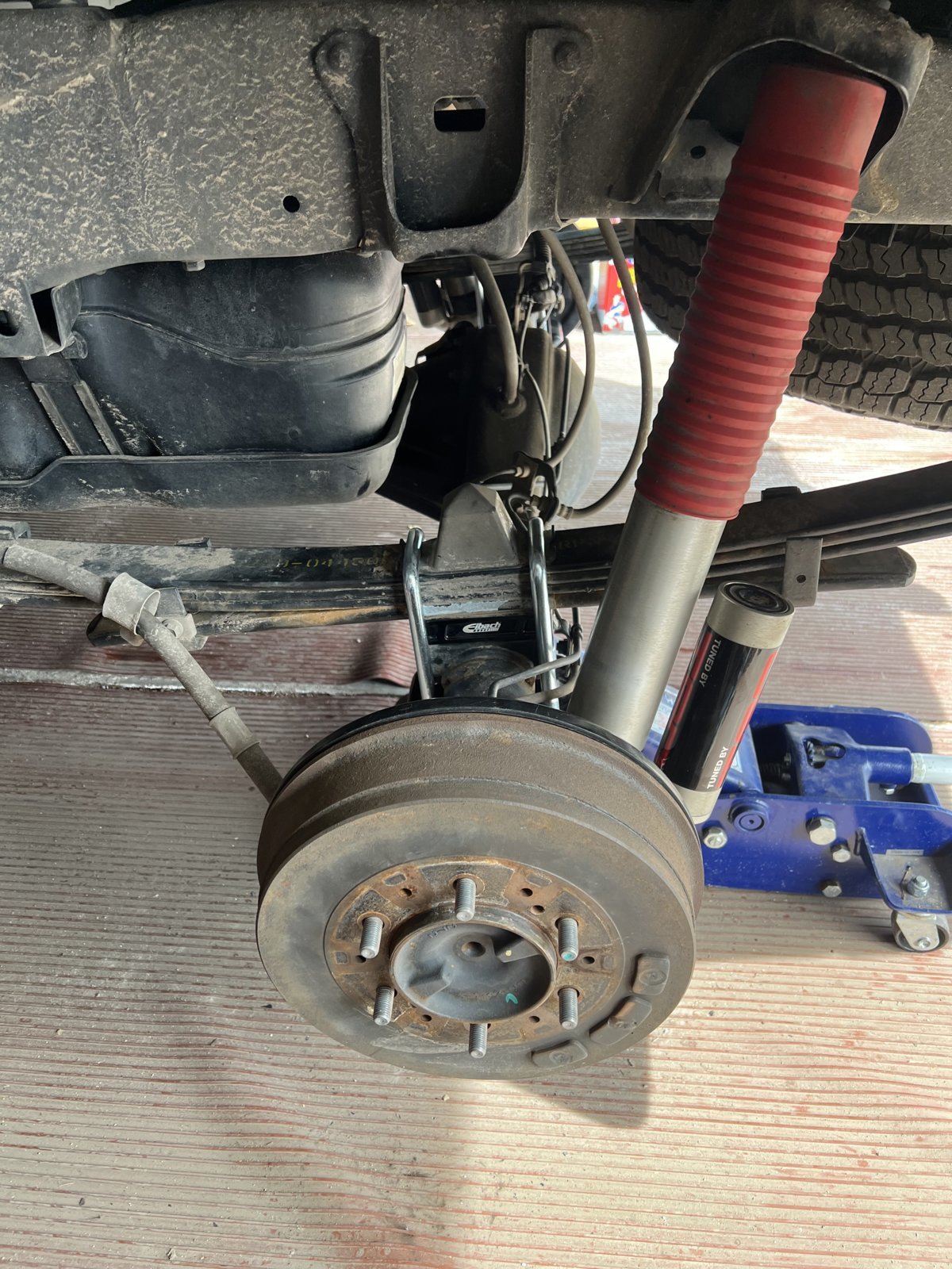

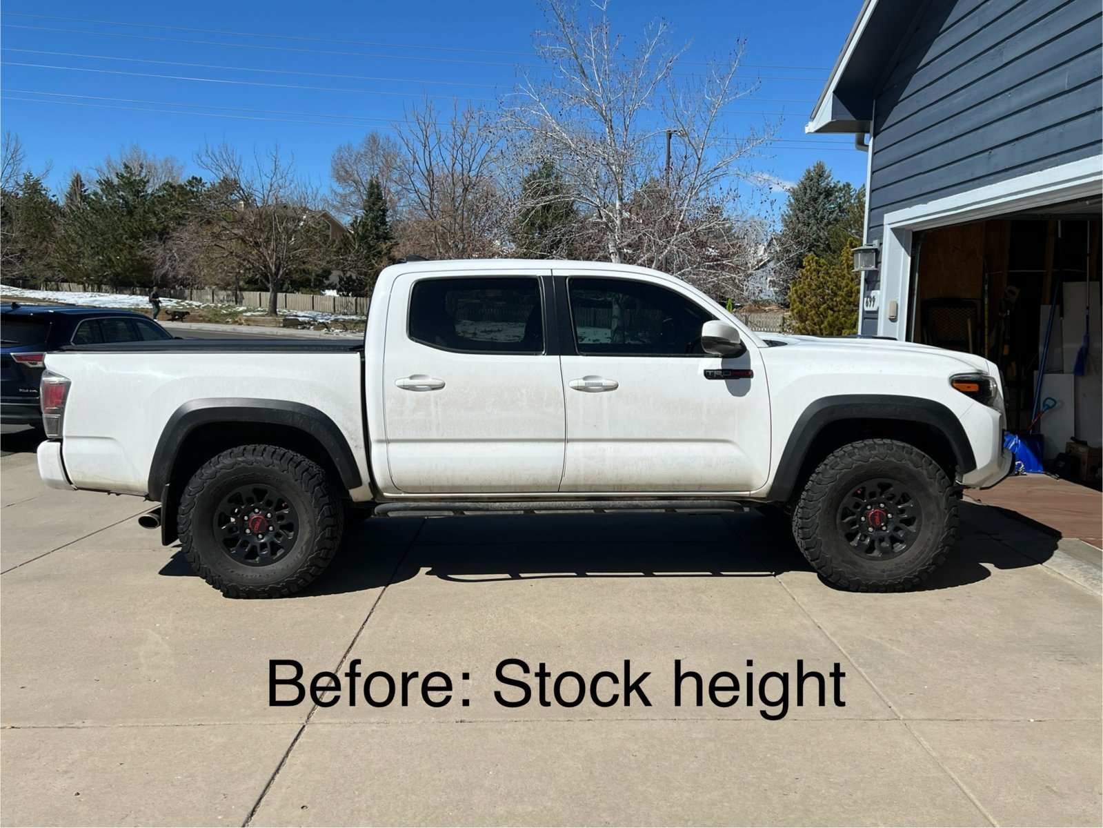

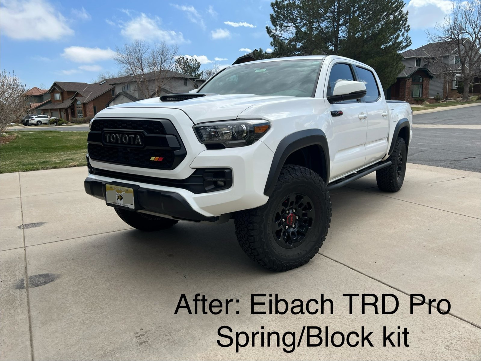

    IMG_1646.jpg IMG_7561.jpg IMG_7491.jpg IMG_7522.jpg IMG_7528.jpg IMG_7512.jpg IMG_7518.jpg IMG_7555.jpg
    You got it. Here it’s…
    A bit of a long post but all sorts of fun info…
    Finally did something major to my 2017 TRD Pro. I bought the Pro because of its unique looks and the factory Fox suspension. After a few years of owning it, I installed 285s (33’s). Had to mold some plastic in the wheel well to keep rubbing to a minimum.
    Fast forward a few more years, I finally decided to put some lift on it. Debated between the Westcot kit and the Eibach kit. Knowing that Eibach made the factory TRD Springs and that, typically, using an extended spring vs pre-load spacers (Westcot) is a better way to go for ride comfort, I pulled the trigger on the Eibach kit. At the same time, I installed sliding quick disconnects along with a sway bar drop/relocation kit (simply moves the sway bar forward 1-2” to help with lift clearance). I opted to do the install myself to save money. I had the time and tools and it saved me $1,000 that local shops wanted to charge me. Instead of using a sketchy spring compressor, I went with the on-truck method seen in the video here (this method is hands down the safest and easiest way to remove/replace a coil over spring and requires basic tools and a floor jack): https://youtu.be/vkVLBOnAifc?si=o-ydP39U8AtUGwTm
    I got about 1.5” in front and 1” in back. Ride feels the same if not smoother than stock. So far loving the setup. Gives me a bit more clearance and lets me retain the stock TRD Pro Fox suspension. The Eibach kit costs about $330, the Overland Custom quick sliding disconnects are pricey at $220. Sway bar drop/relocation kit was $35. By doing this all in my own, I got a lot of bang for my buck.
    Enjoy the pics!
