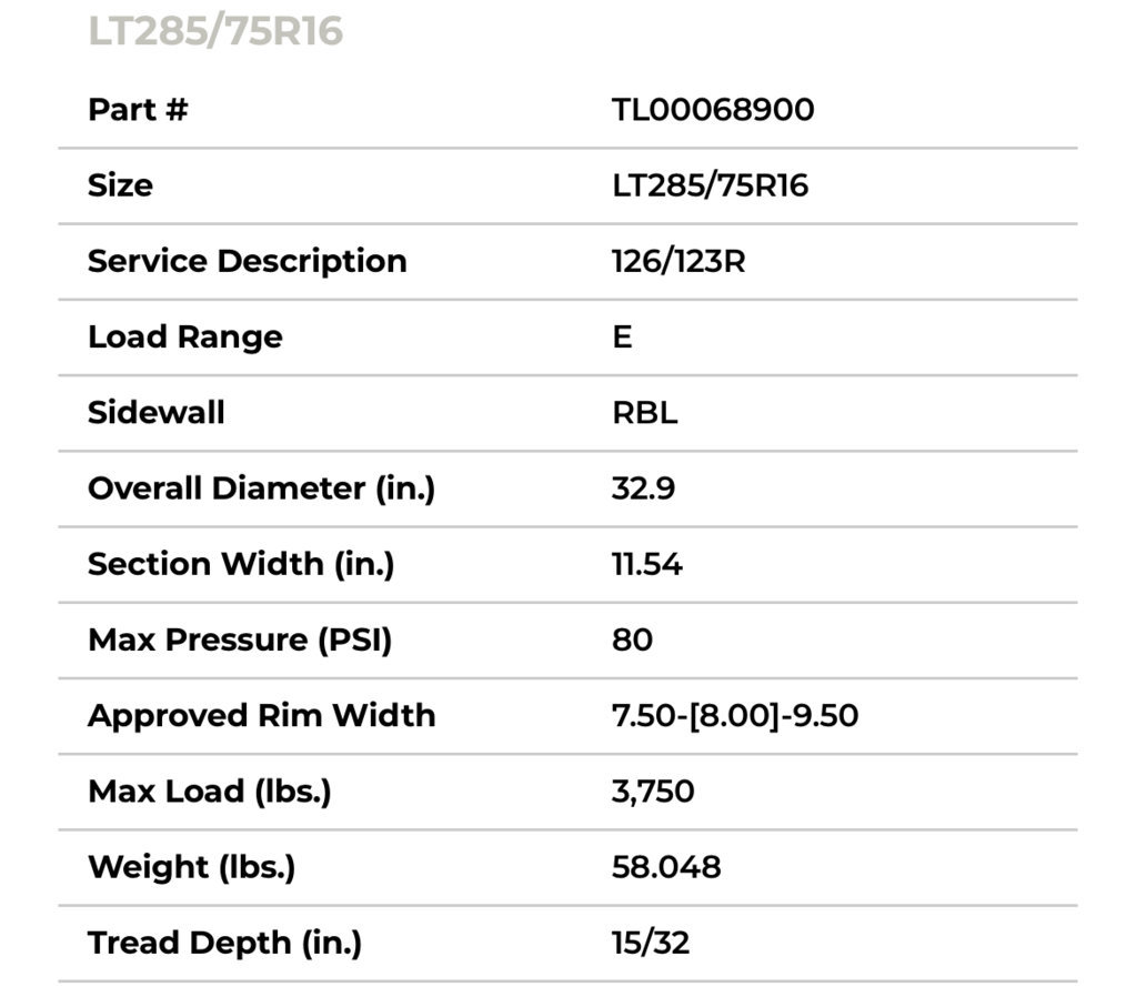

    Are your tires E load? In my brief search for something bigger than what I currently have (265/75/r16) they were all C E load

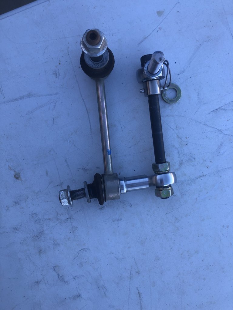

    2019 Voodoo Blue Tacoma TRD Pro.
    -Shmellfab rocksliders.... -BD ditch lights -Cali raised ditch light brackets -Sway bar discos -Auxbeam aux 6 gang -Uptop Bravo -Rci trans skid -Rci cat guards -Trd pro eibach lift springs -Hypertech speedo calibrator Etc.

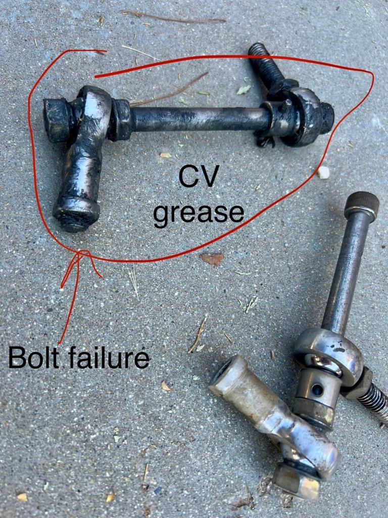

    just fyi, watch out for the discos.
    I’ve had mine for almost 4 years and the bolt at the spindle snapped off randomly on a dirt road. Tore up my boot in the desert outside Las Vegas. I had to pull the axle and clean, regrease and reboot it.
    Talked to overland and they just said they’ve never seen that happen before ever and that was it.

    I probably wouldn’t do that with THAT fox suspension. They tuned it and all with THAT swaybar in mind. It’s actually a thicker one than the OR. The same one that’s used in the sport.
    Having had both, you don’t want to be corning at high way speeds down mountain roads like big bear. They use that thicker swaybar because the springs on the pro have a lesser spring rate to complement the shocks. It has pretty good body roll.
    …and I don’t know about you, but I’m not trying to drive like a grandma with 30 pissed off cars backed up behind me.

    Correct, E rated for the Maxxis Razr AT:

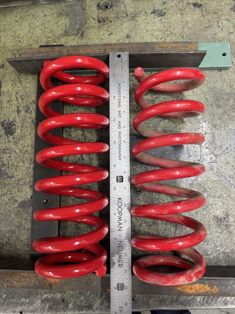

    Same spring rate (~620lbs/in). Here is a side by side comparison of the recalled Eibach Spring for 2020+ models (left) and the stock TRD spring (right). About an inch difference between the two.
    I still have the Eibach lift springs with TRD Fox shocks on my truck, but didn’t get a chance to take a side by side photo of the stock spring vs the one currently installed (updated spring that is ground flat on the top).

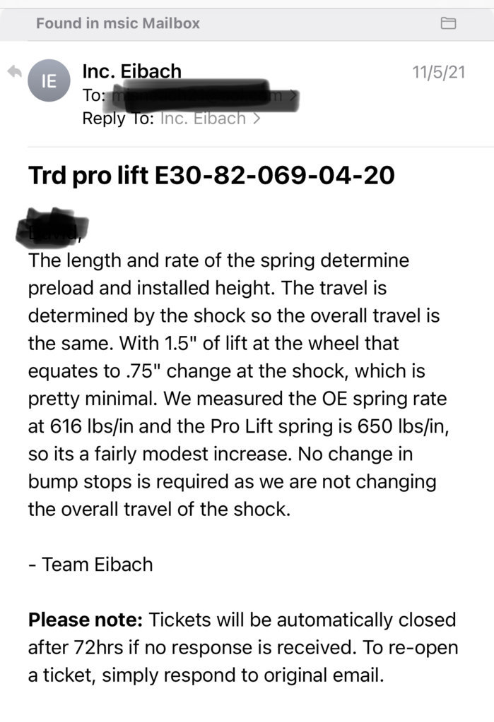

    The eibach is a heavier spring rate. According to eibach, who makes both the OE spring and the aftermarket spring.

    The product number in that email subject line is for 2017-2019 models. For 2017-2019 the stock rate is 650 lbs/in and the Eibach lift spring rate is 650 lbs/in. The 2020+ stock springs are 616 lbs/in and the 2020+ Eibach lift springs are 616 lbs/in.
    I'm pretty sure the person who responded to your email is confusing the different model years, and thinks that both the spring rate & length are changing. Below is a quote of Mark's post saying that the spring rate was not changing for their lift springs, rather there are two different spring rates depending on model year.

    Out of curiosity, the hex bolt that broke, was it attached to your seat bar or the suspension system? I heard of someone who had this same bolt break but it was because they had the disco installed upside down. Also, when I tried to install mine, it was apparent that the angle at which the discos connected required a sway bar relocation kit (a couple blocks). I installed the relocation kit and the discos lined up MUCH better.
  14. Nov 11, 2024 at 7:58 PM
    #2254
    dfanonymous
    dfanonymous Well-Known Member
    Apr 9, 2019
    #289657
    1,703
    If by suspension system you mean the knuckle (spindle), yes. The part that broke goes to the spindle side.
    If you have them, they really only go on one way, with the pull pins in the down position.
    In the pinned position, they are shorter than the OE. You didn’t need to do a swaybar drop. All you had to do was pull the swaybar down. Either way, it didn’t break because of installer error nor just sending it.
    If you send it that hard that the proper graded fastener snaps clean off, usually the spindle bends. Mine is good to go.
    poopshute[QUOTED] likes this.
