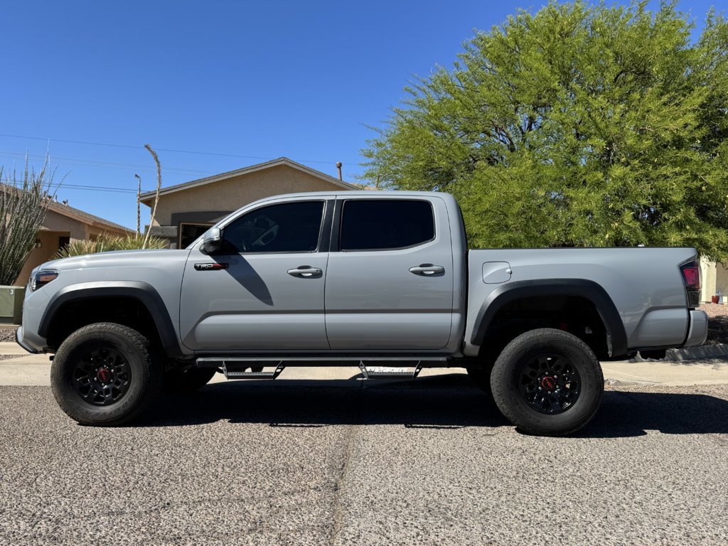

    Anybody like the raked look? Measured out about 1.5” difference front to back after Eibach Springs and 1.5” AAL install.

    I do like the raked look.

    It comes raked from the factory. I’ve never had an issue with that look. If there’s an aggressive opposite look where the front is much higher than the rear… hard no from me.

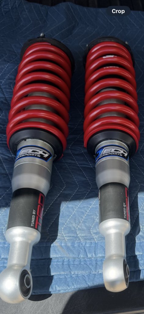

    Hmm i wonder if the rebuilder mixed them up? I did follow the LF and RF letters under the perch. Does it look right?IMG_8031.png

    The easiest thing to do is to measure right under the perch down to the eyelet on both coilers. The one with the longer measurements will be the drivers side. Hard to tell from the pics but it looks like the one on the left is the drivers side?

    Yeah the left LF i put on driver side.
    Perch to eyelet is 10.5 on driver side, 10.25 on passenger side. So it is correct.
