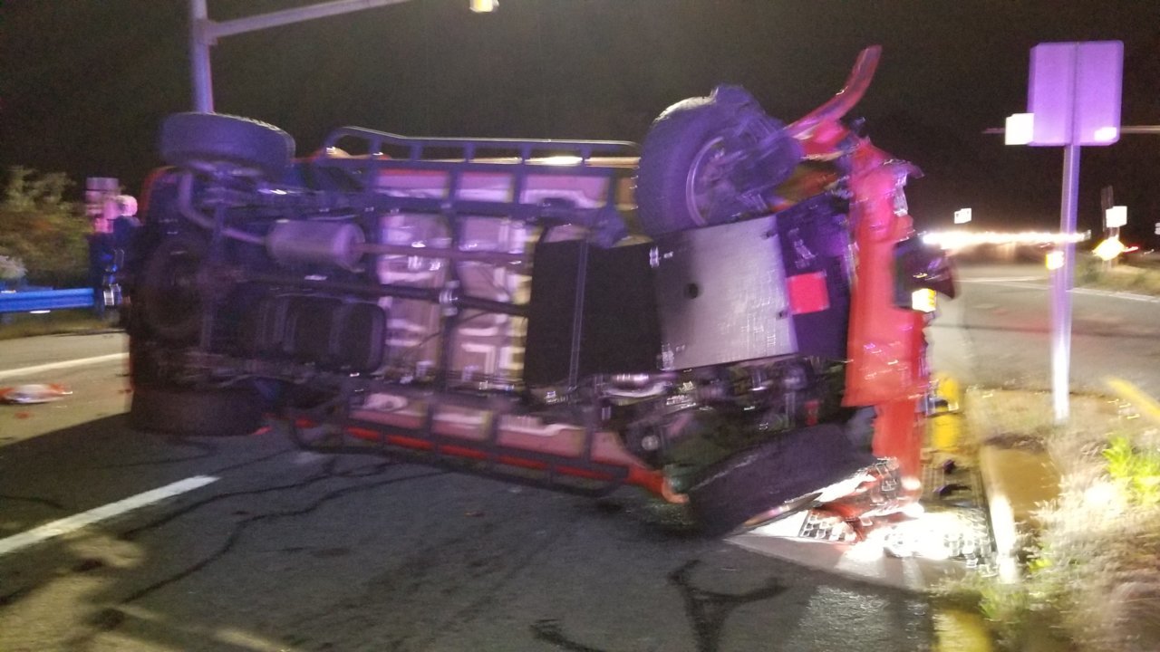

    #316026
    18

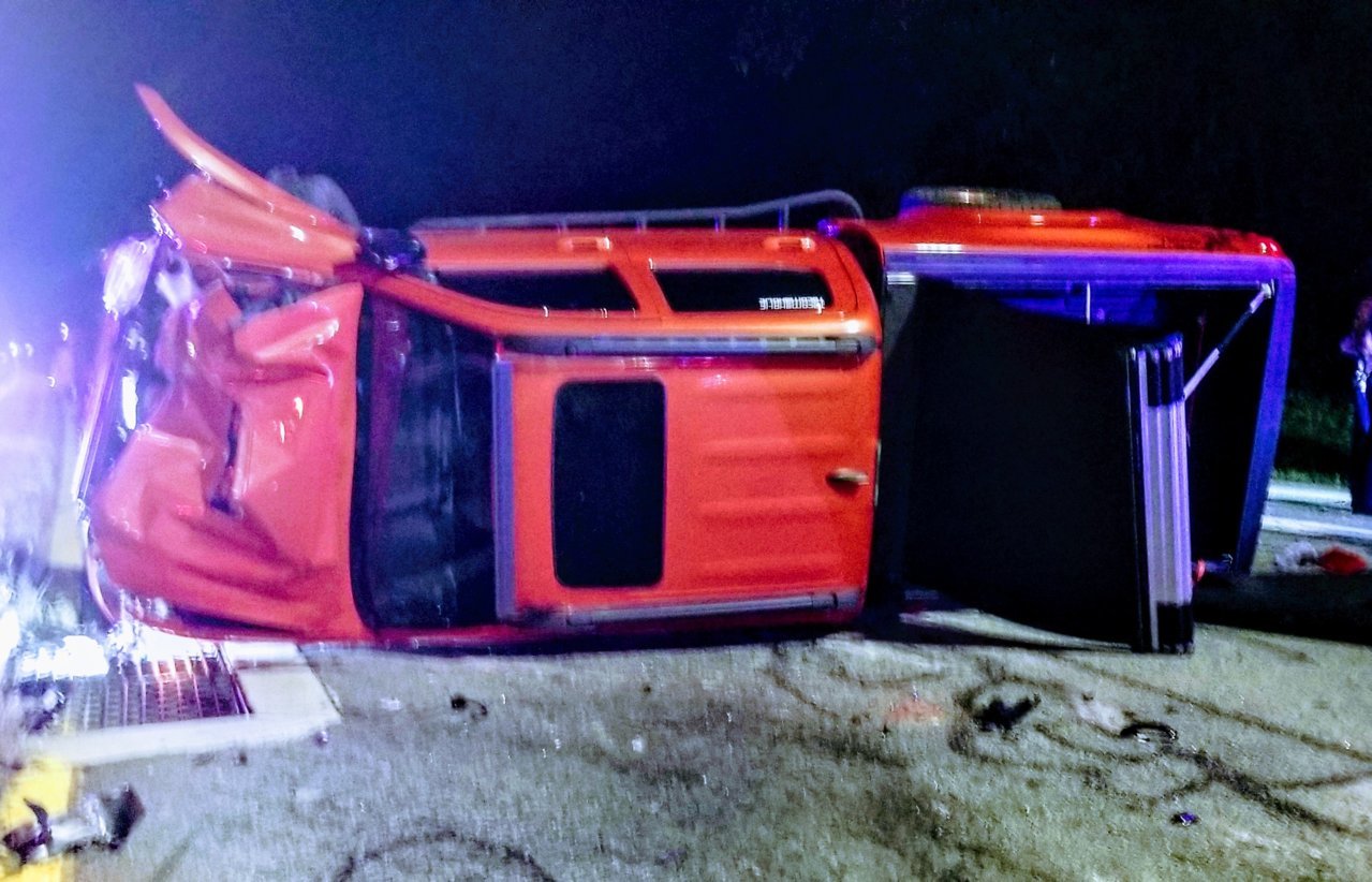

    I thought you heard. Tw vehicles pulled out in front of me at an intersection. I was doing 50mph or less. The posted speed. The first vehicle made it. The second wasn't as lucky. I was lucky to get the equity outta the Sport. State Farm doesn't recognize aftermarket modifications.

    Holy cow! Looks like you got hit hart. On a side note, I have Progressive insurance. I have an option on mine to insure mods. I have to state the value of the mods, make sure I have backup, and pay extra (it's not cheap, but the option is there).
    Hope you are recovered!
