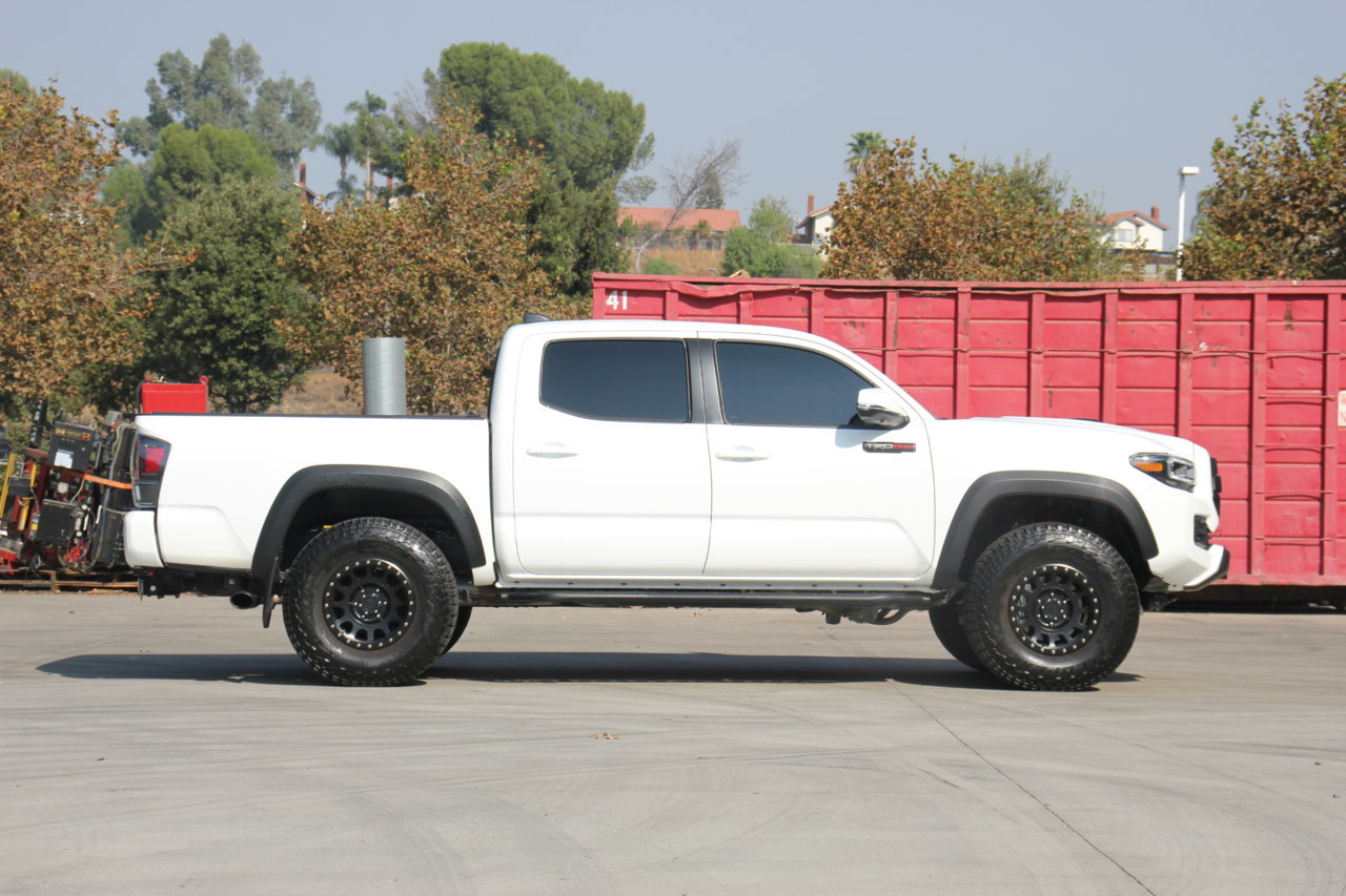

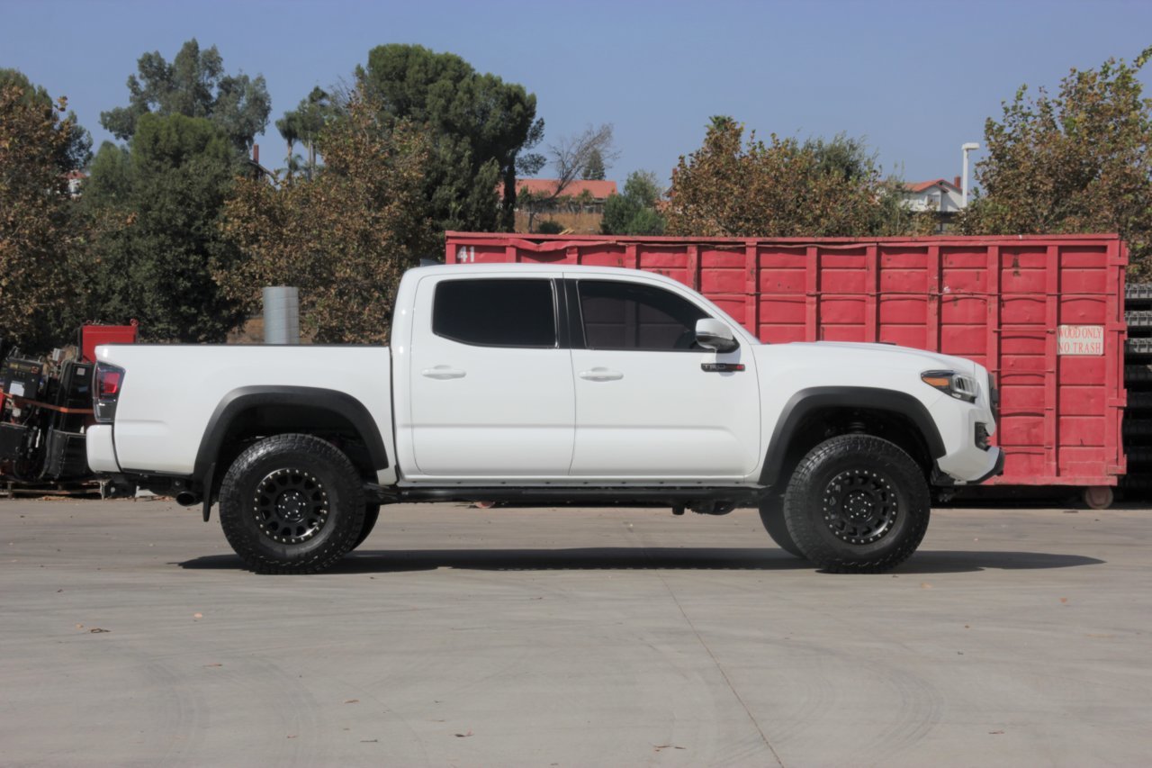

    @mark@eibach, where are we on the 2020 update? Tires are rubbing, my friend :)

    The suspense is killing me. What level kit did you install?
  16. Oct 30, 2020 at 9:16 PM
    #616
    5nahalf
    5nahalf I build dumb things
    Sep 22, 2018
    #267058
    10,940
    Erik
    Minnesota
    2018 Inferno Longbed
    Judging by him being at eibach im guessing he is one of the test trucks for the new eibach trd pro kit.

    Did they install a block in the rear?

    it looks nose high squatting could just be the angle

    Dude, can you please post some level photos from the side? We really want to see what we’re in for.
    Mark, when are we looking to be able to put in orders from dealers?
