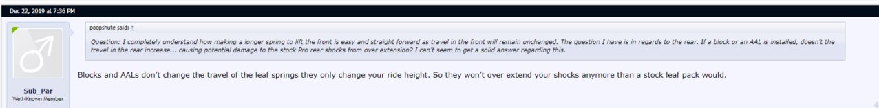

    I'm no suspension guru, but how do blocks not require longer shocks?

    Actually, your both right, but he is more right.
    You said that adding a block wont extend the travel of your leaf springs. Your right it wont, but he is right in the fact that the mounting location for the rear strut is now moved (size of block) away from the original mounting point. So now while sitting there, the strut is 2 inches more extended than it was originally.
    The only way adding a block would not extend the shock is if the struts mount was on the leaf spring.

    I was speaking to a small block, didn't know I needed to specify that. We’re talking about using stock Fox shocks, so if someone puts a 4” block in the rear, they have bigger issues. I’m saying a 1” block in the rear will not OVER extend the rears to the point of failure.

    Well what you initially said was:

    You’re correct; however, as I said above I was talking about a small block like what would be used to compliment a 1-2” front lift. But also I said over extend, obviously at static ride height the shock will be extended beyond stock whatever the added block/leaf thickness is. What he’s saying about AAL is completely wrong though.

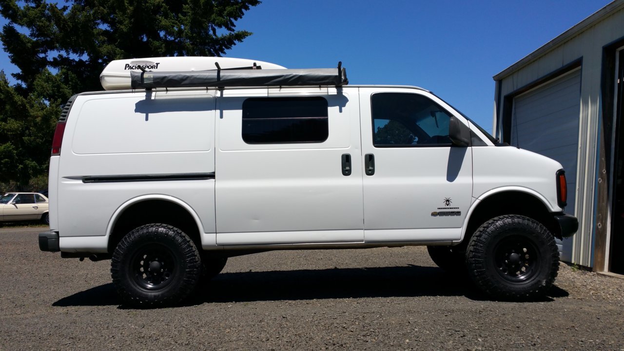

    I apologize in advance, this is obviously not a Tacoma but Since I have not altered my stock suspension yet on the Pro, here is a picture of a vehicle that I lifted using a Block in the rear. The Stock rear shocks would no longer fit eyelet to eyelet so I had to installed Longer Shocks. Boy, talk about research finding Longer, appropriate shocks for a 2wd express van!
    DRob, uurx and GreyBaldTaco like this.

    Yeah, its not though. Adding a leaf = adding material between the frame and the axle, and unless your leaf pack sags after you add a leaf (it wont, thats the whole point of an AAL) to account for the extra thickness, the only way for your shocks not to extend is if your back wheels are levitating.
    Im not claiming to be an expert but Ive been under the truck making these changes and seeing the impacts. But thats "obvious" to you, right?
    E: ah i see this devolved from saying blocks or aal wont impact your shocks any more than stock to being pedantic about saying "over" extending. Classic maneuver there, Im proud of you.
