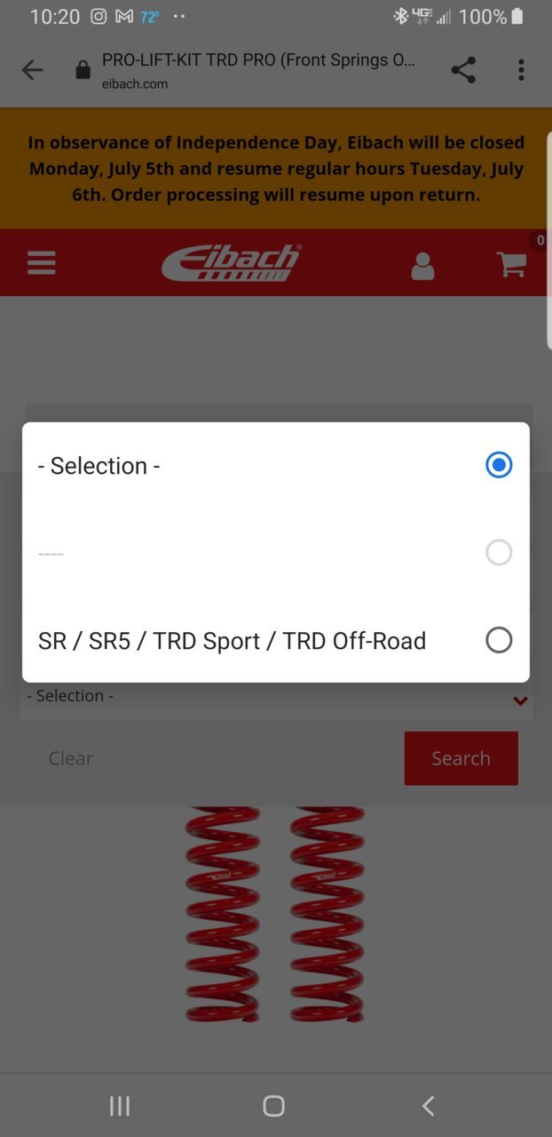

    I may be missing something here but how are these springs good on 2017+ but the Eibach springs/Westcott kit are both specific for 17-19 & 20+?
    The springs/perch pictured in the link appear to also be for the 17-19s

    The toytech kit replaces the lower spring perch also. This converts 20+ trucks to the same design as the 2017-2019 springs. Its a half asses solution to be honest.

    is this a good solution for 2017?

    I think the eibach springs would be the best solution.
