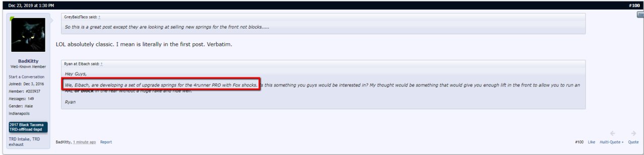

    AHAHHAHAHAHAHAHAHHAHAHAHHAH
    https://www.extremeterrain.com/eiba...VjYbACh2wCg0yEAYYAiABEgJih_D_BwE&gclsrc=aw.ds
    I cant wait to see the response, i really cant

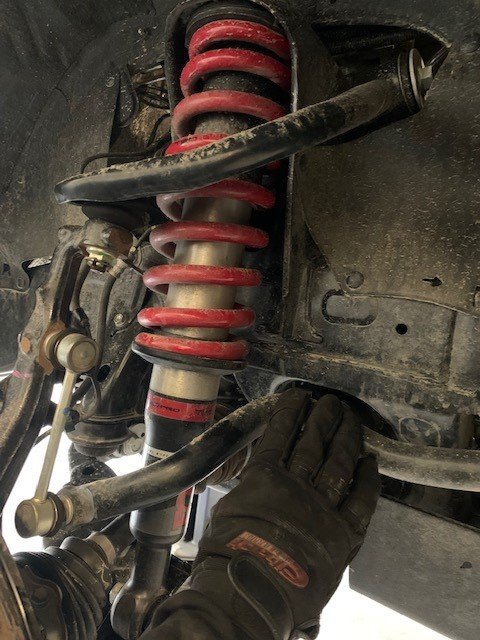

    Measuring session on a 4runner PRO today...

    Interesting. 4runners got an extra coil. (Compared to Tacoma)

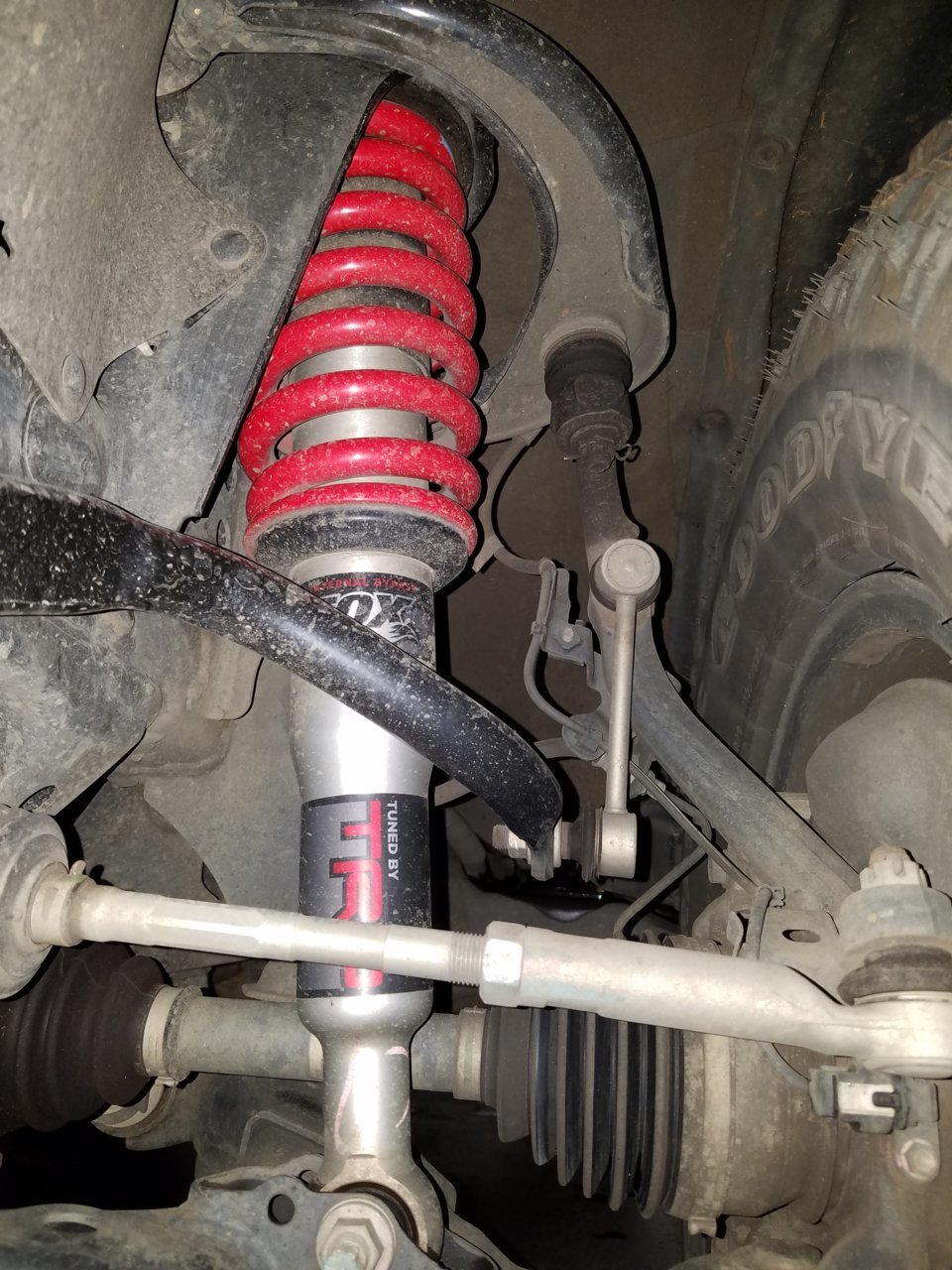

    No.
    LOLlol and this goobey "sick measuring sesh" could not illustrate the point any better.
    1. You dont need to measure ANYTHING. Toyota engineers have already given you every single data point you need.
    -The length of the spring is irrelevant, a 600lb spring is the same regardless of length.
    -The LB rating of a spring is called the spring rate, the spring rate of a 13" 600 spring is the same as 26" 600lb spring.
    2. If your suspension came with a 13" spring that is all the length needed for the travel your suspension is capable of.
    -Changing to a longer spring will not make your suspension have any more travel or "lift".
    If you want your spring to hold the truck up better without pre load the correct move is to get springs +50lbs so in your case a 650#.
    -A 14" 650 may fit if you cant find a 13" 650 but just know the extra length is doing nothing for you.
    3. A longer spring with the same 600lb rating is not going to hold the truck up any better, period end of story.
    -you are dealing with a fixed distance between spring seats and of course in that case ride height would increase.
    dealing with an adjustable preload, or an adjustable distance between the seats.
    -With the same given spring rate and ride height, the longer spring will take the same amount of preload.
    -The only difference would be the total length of the preloaded coil, it would be longer.
    -Thank you evenflow
    I'll try to help Tacomaworld understand and Mr.Eibach can get his free suspension theory seminar for future marketing threads, and could perhaps forward it on to the marketing department or whoever makes their poor-soul engineers design illogical products:
    Tacoma Pro Fox:
    PTR61-35170
    4runner Pro Fox:
    PTR61-89190
    The 2019+ TRD Pro 4Runner (and the rest of the TRD Pro lineup) comes equipped with 2.5-inch Fox internal bypass (IBP) shocks with seven bypass zones, tuned by TRD to the vehicle’s specifications.
    -TRD gave the 4Runner specifically designed coil springs up front to give it an extra inch of wheel travel and ride height.
    -The rear 2.5-inch Fox shocks are also designed to work in harmony with the TRD coil springs, featuring a piggyback reservoir and 11 bypass zones within the shock body.
    -Both have velocity-dependent valving that increases with impact speed, but the new Fox set-ups have position dependent damping that varies based on how far they're compressed (or extended away from the midpoint at which they run on a smooth surface)
    -Lifting will result in different dampening behavior. Especially the rear that has something like 7 zones of dampening.
    -So being an inch or two taller would mean that you're in a different dampening zone than it was designed for.
    The bottom line is this:
    "Progressive-Rate" style suspensions are meant TO SIMPLY BE LEFT ALONE, by virtue of their engineering characteristics. The Fox-TRD-PRO suspension was SPECIFICALLY designed to operate to its factory configuration by design, and tampering with either the valving, stroke, spring rate or coil length etc.. can produce NO OTHER RESULT, other than negative.
    If at any point your mental-gynastic's routine has convinced you that:
    "for my needs, I need (insert exact inch of lift)"
    "(insert user) has it and he's fine, so Im doing it too"
    "I must have BF-K02's or ill hate my truck and have to sell it"
    A TRD-PRO model simply was not for you, as they were NOT INTENDED to have their suspensions modified. Any modification will compromise performance and life of parts. An Off-road and an after-market kit was what you wanted.
    Additionally, this may help demonstrate for those who benefit from visual aide:
