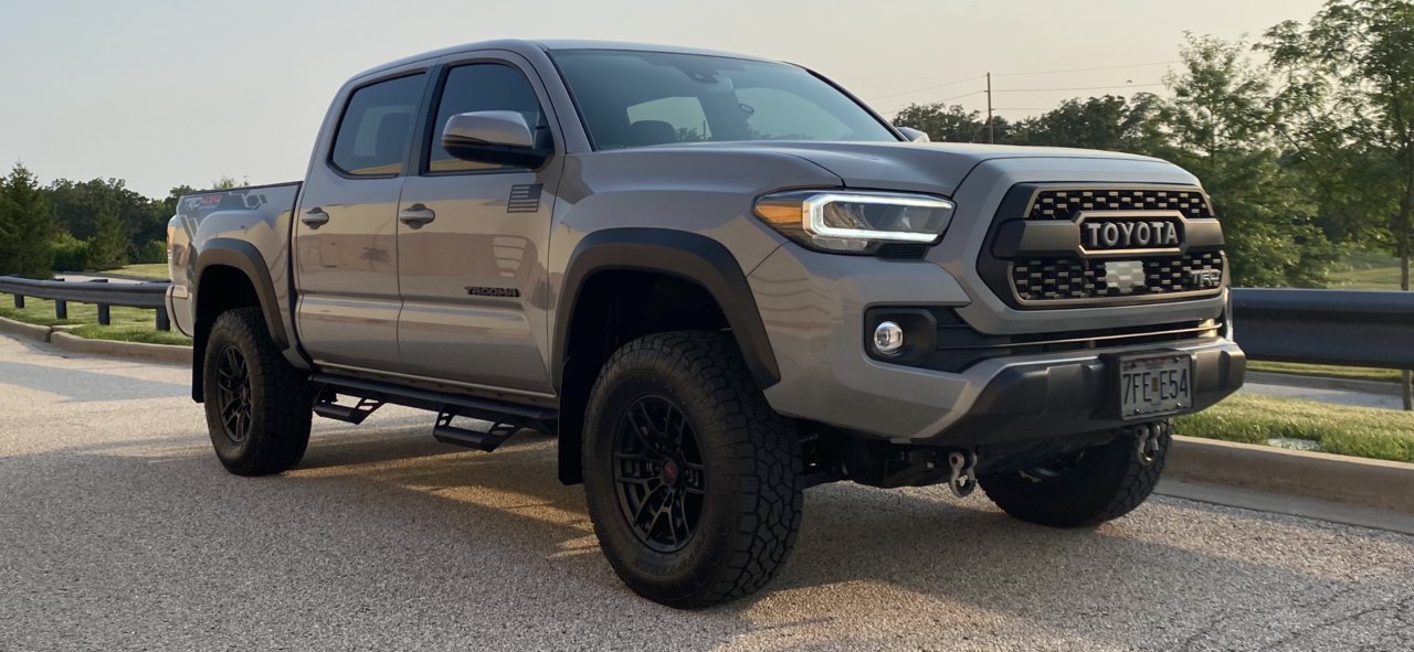

    Got the springs installed today. Next is installing the suspension along with my Icon 1.5” AAL and 285/75R16s that I just picked up.

    Do you have skids and sliders as well? I'm trying to determine if these springs will support the weight I have without any nose dive. Do you have any pics of your truck with these Eibach springs on?

    Looking sweet! How much of a rake do you have with the Icon AAL and Eibach Springs? Do you have any weight in the bed?
    My springs should come in next week and I will be adding them to my ADO AAL, that I will be installing this weekend. Excited to see how much rake it will have. ADO says they give 1.5 inches with a 250lb load. Will also be adding 285s and looking a similar look, or even with a bit more rake.
