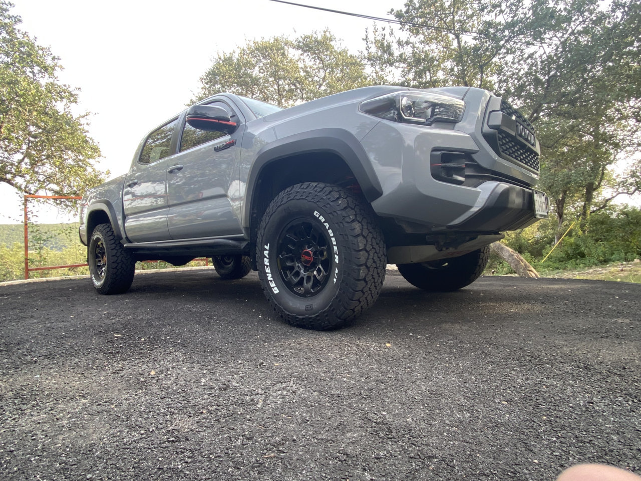

    Tire size?

    MySpace angles are cool, but could you take a squared up picture from the side? :D

    285/75/16

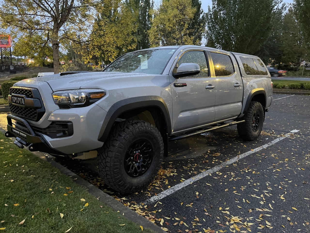

    Got my new springs installed today, along with Icon UCAs and 285/75r16 Nitto Ridge Grapplers. Based on my before/after measurements, I gained an inch and a half height from the new springs (just in the front) and an inch and a quarter from the new tires (front and back). I’m happy with the added height, especially considering the additional weight of the front bumper and winch.
    New fender heights are 37 1/2 inches from the ground in the front and 38 inches in the back. I have an Icon AAL in the back already…
    The guys at the shop couldn’t get the 33s to rub, so I think I’m in the clear. Drove about 15 miles home, ride seemed fine. A little more firm in the front, but still comfortable.

    Wow looks great! Looks like you were able to keep your stock mudflaps in the front and still saw no rubbing from the 285s?

    Funny you mention that…. I noticed today some wear on the right front mud-flap, so they will likely come off soon.

    lol ahh bummer, guess with 285s the only flaps can be the rears or some very flat aftermarket ones for the front. Thanks!
