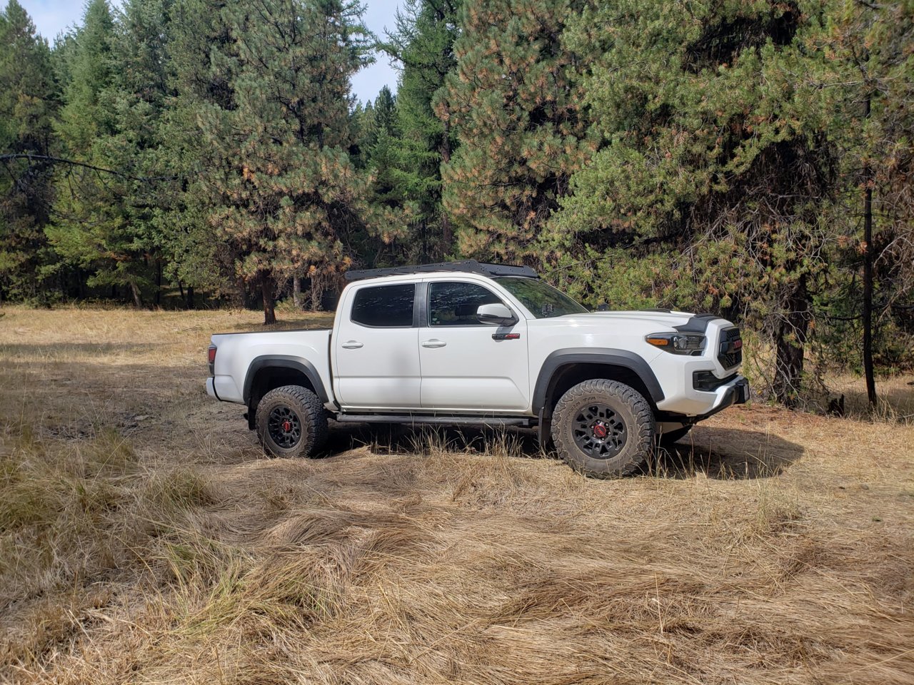

    I called 4WP and they said they would only do the entire strut/spring replacement. Would not do a spring swap only. Asked about front spring/strut replacement, They said around 400.00. NOPE! That would have put me at ~$800 for a 1 inch lift... now I know I could use the extra inch, but DAMN!

    Yea - it isn’t as inexpensive as I first thought it might be. I was upgrading to 33-inch tires, so I needed the extra ~1.5 inches. BUT - I thought I was going to have to replace the entire suspension with Kings or Fox, so this route was decidedly cheaper than that.

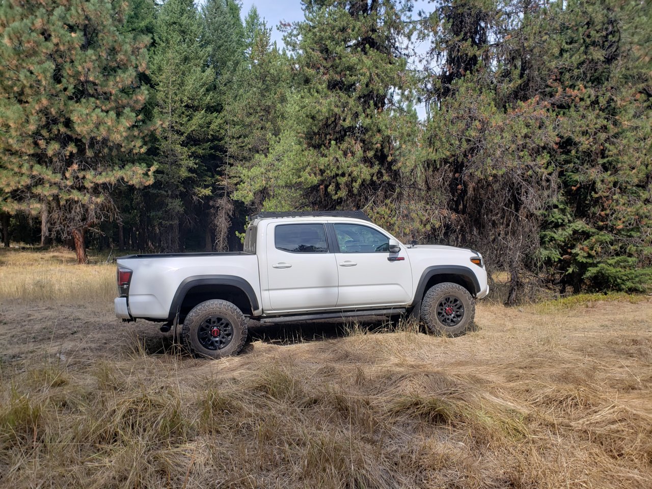

    Anybody just do the fronts and not the rear block or leaf? Any pics? Wondering if that will make it level. Ever since I put 33’s on I noticed the front is little lower even though it’s a pro..
