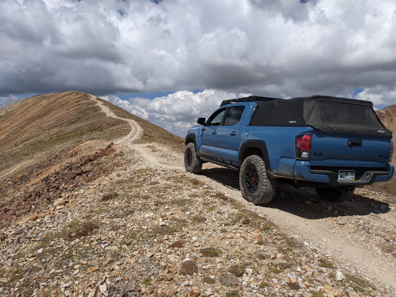

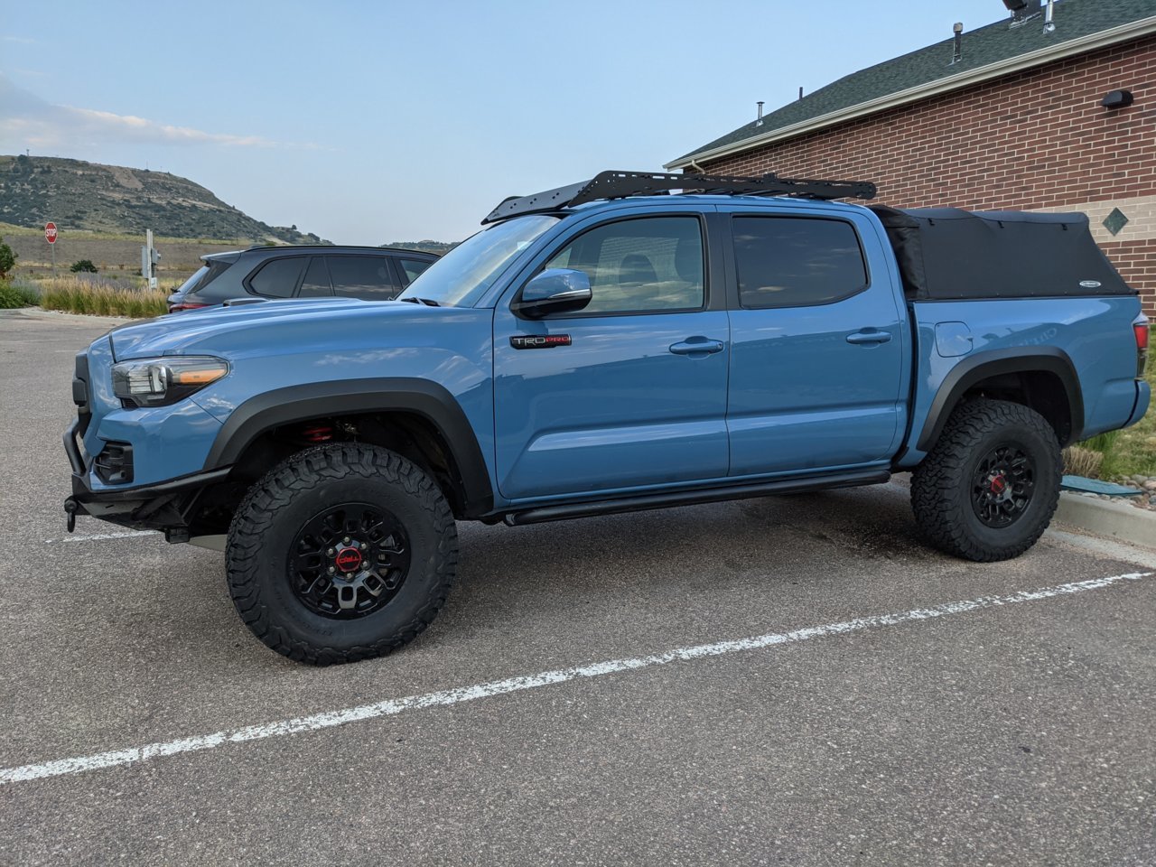

    Some shots of these springs with an AAL and 285s
    With my setup (bumper+winch) the AAL gives it about an inch of rake unloaded and I'm perfectly happy with that.

    Looks nice. What kind of mpg do you usually average?

    I've calculated an average of about 17 with a lot of mountain driving and trail use since I put the 285s on. I have gotten ~20 with straight highway mountain driving though.
