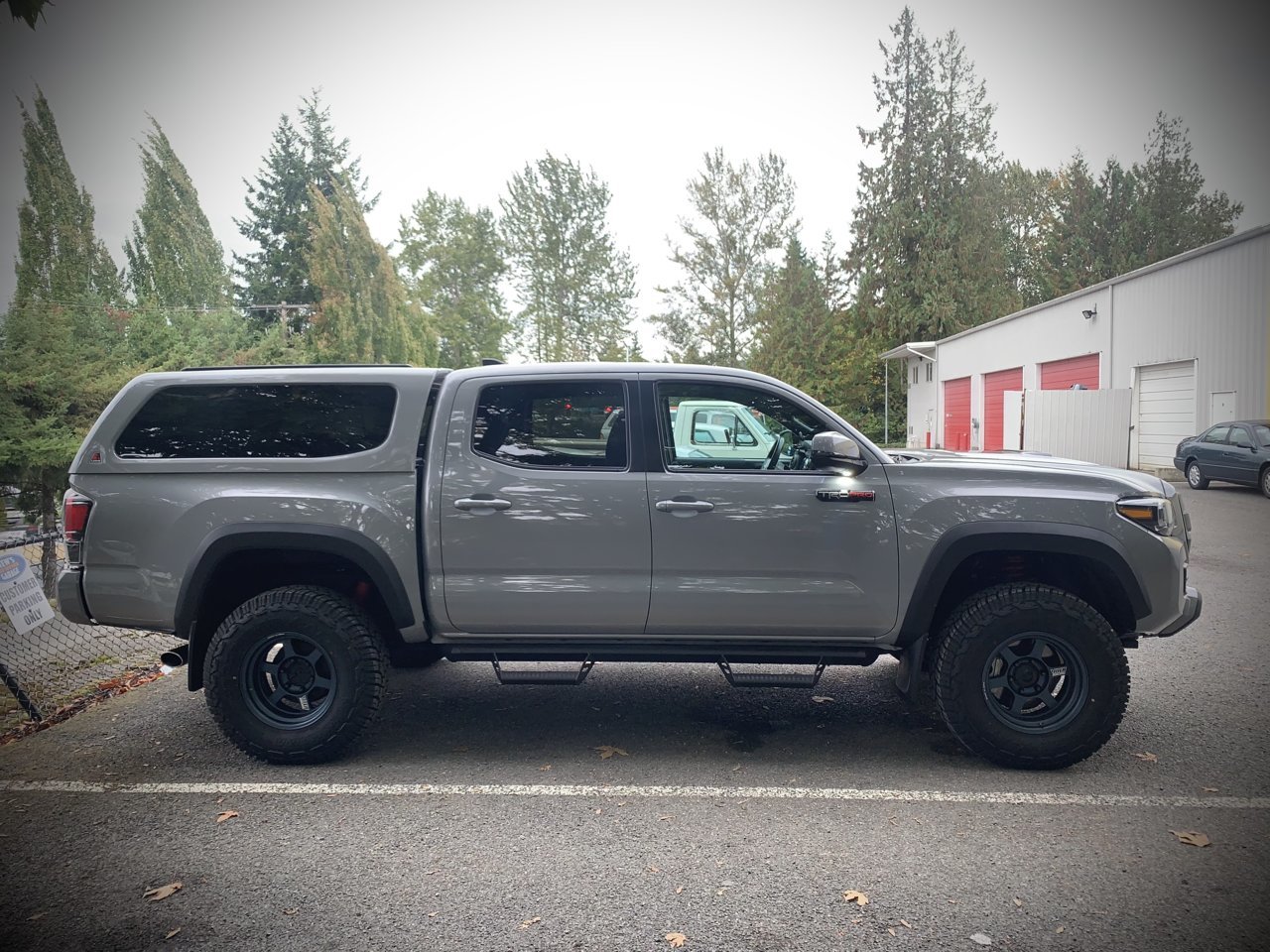

    Installed my Eibach springs this weekend using well lubed Schwaben spring compressors and an impact wrench. Very straight forward; never felt like I was going to be maimed or killed. :rofl:
    Also installed a 1.5" Icon AAL.
    Tired, but very pleased with the result.
